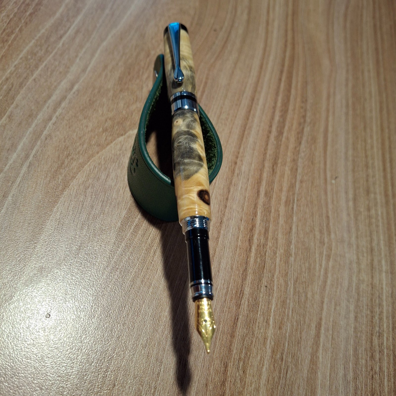

Here is the end result. Personally I dont think it looks good. First attempt with a burl product.
Dave
I think it turned out nice, but I'm a big fan of buckeye burl. Guess it's not for everyone.
I like it. I have used coffee grounds as well as saved shavings from the blank that I was turning. At one time I had about 20 baby food jars filled with different shavings of different timbers.
