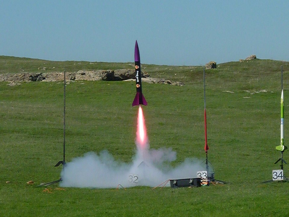

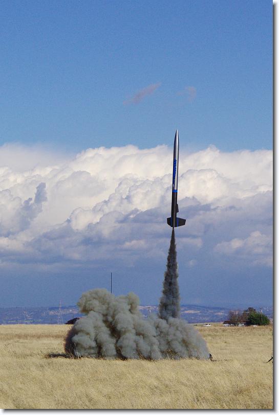

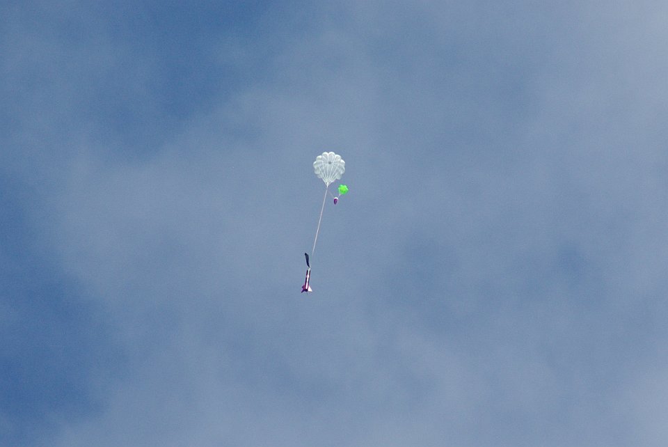

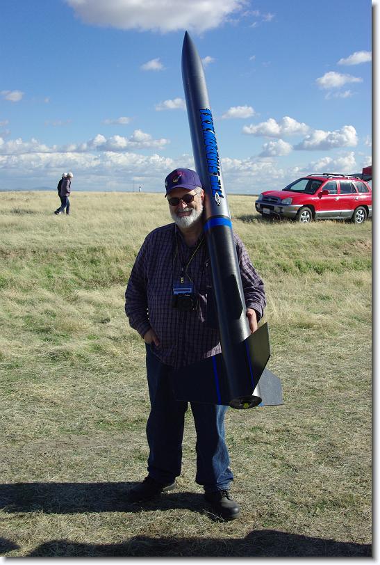

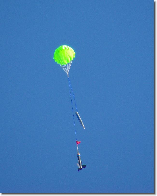

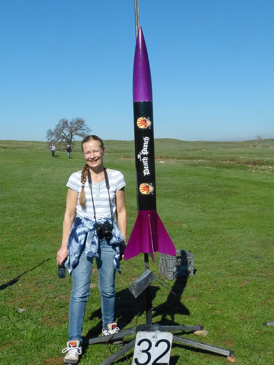

Over the years, I've used a LOT of BSI epoxy on high power rockets. 5, 15, and 30 minute. Never had a problem. On pens, I use 5 minute almost exclusively. The only time I use a longer cure time epoxy is if I'm gluing up blanks for several pens at once. Lately I've been using Devcon 5 minute from Lowes, just because it's convenient to pick it up there. No problems with it, either. But like Dan said, 5 minute epoxy does not cure all the way in 5 minutes. I've turned within an hour with success, but if it's an important project or expensive blank, I'll wait longer.
