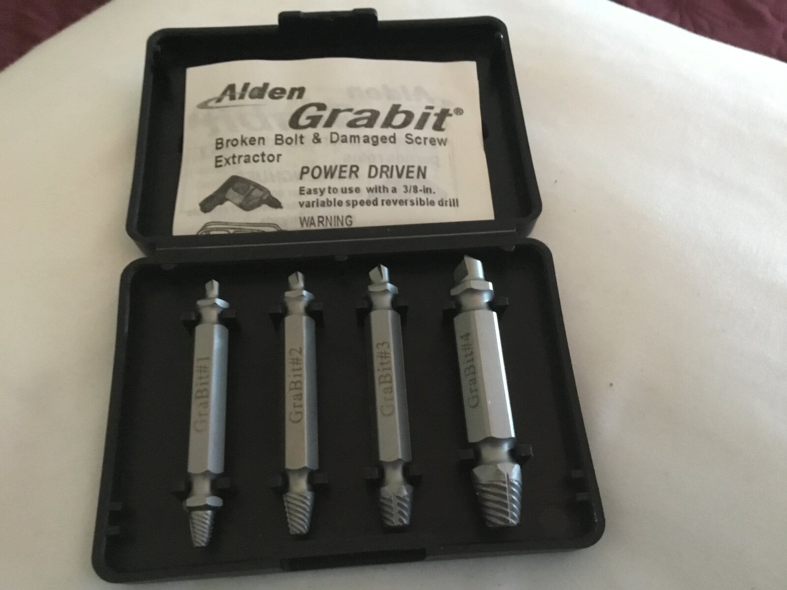

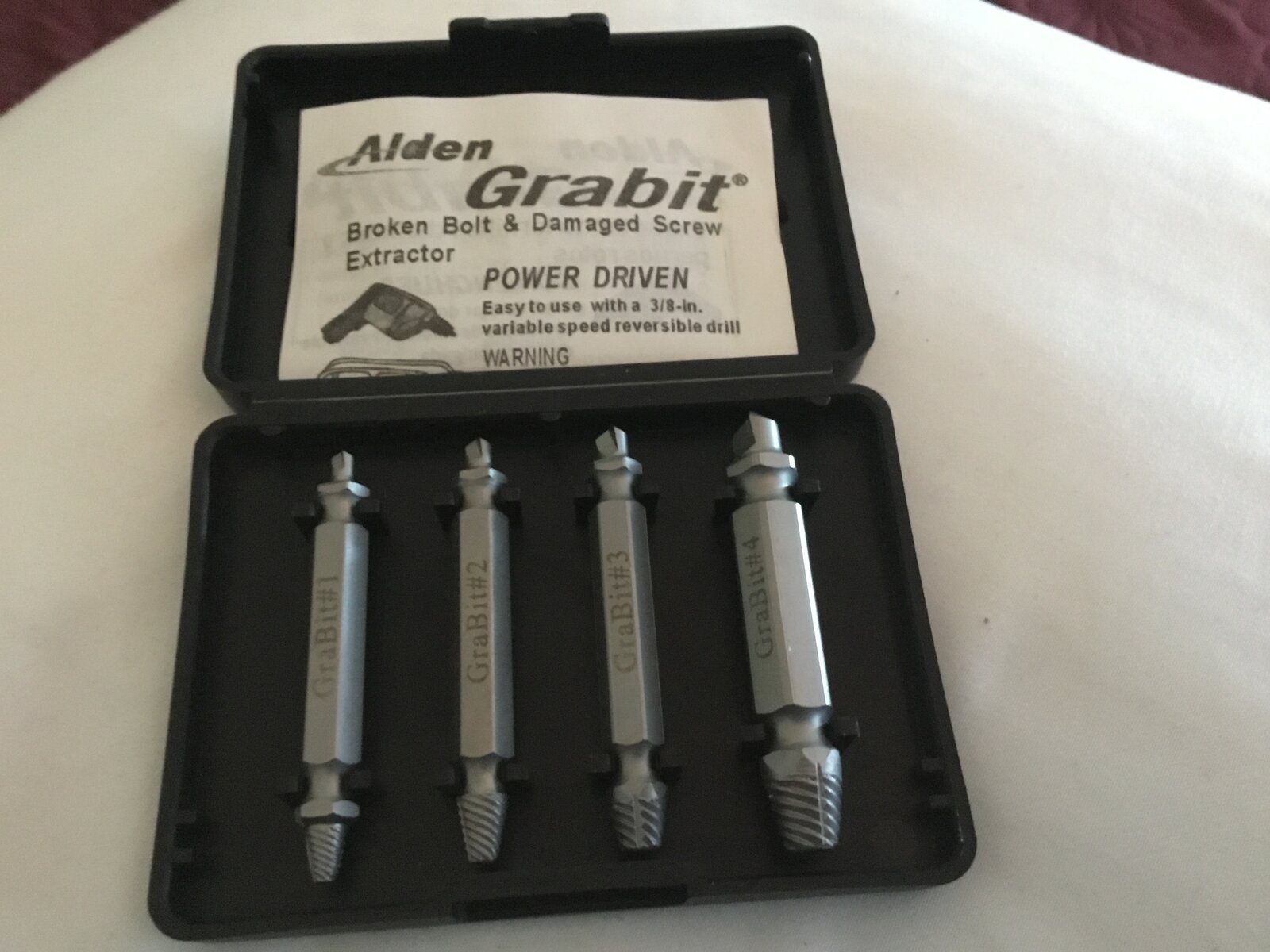

You could try this:
$13.00 on Amazon. Another tool I bought years ago "just in case" but have not used yet. 🤷🏼‍♂️
