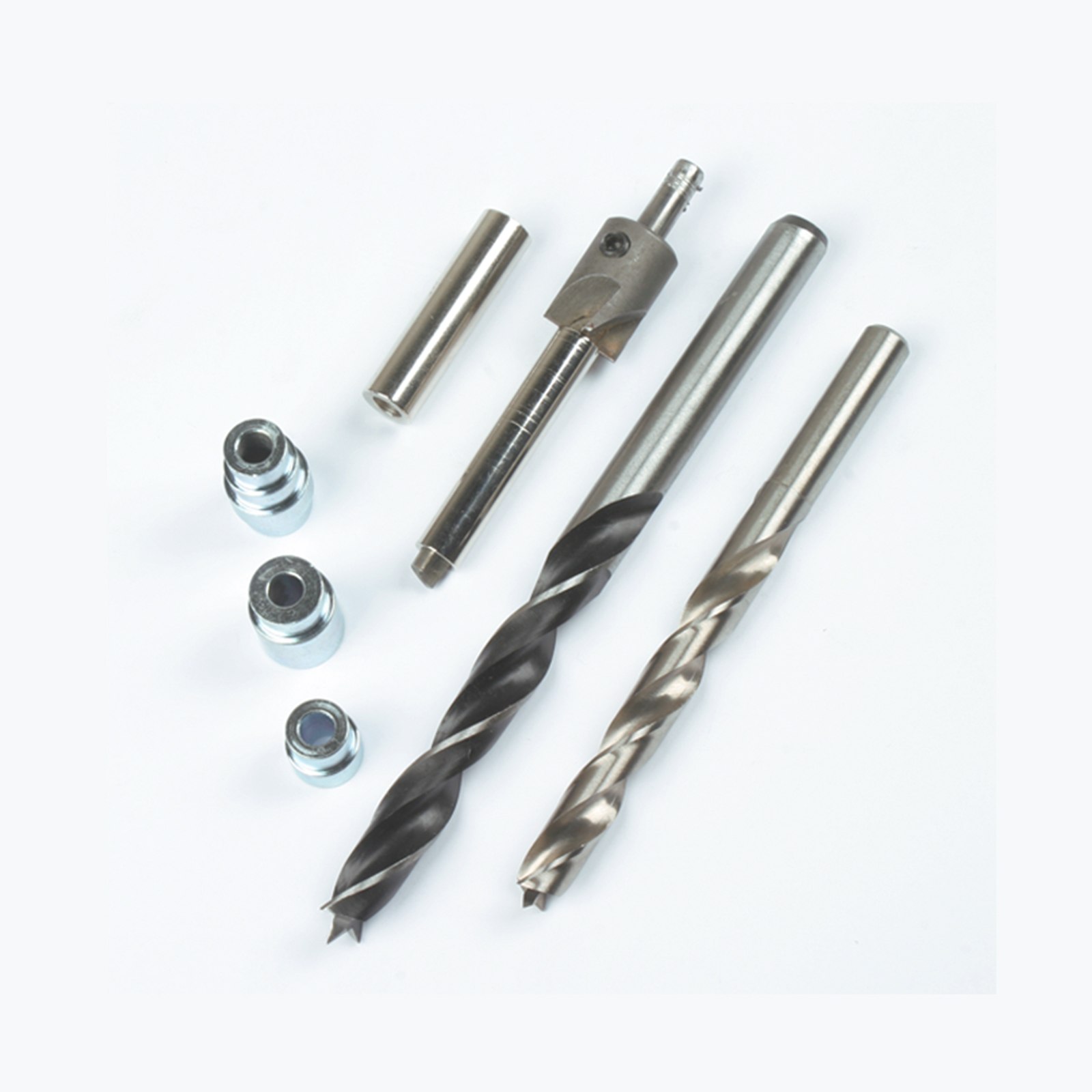

My son has requested this pen from PSI (Broadwell Art Deco Rhodium and 22kt Gold Fountain Pen Kit PKART3F). However, when looking at the drill bit sizes in the accessories section in the catalog it calls for a 27/64 and a 12.5mm bit. When I look at the build instructions they call for a 12.5mm and 10.5mm drill bit. Has anyone made this kit before and if so what size drill bits did you use? According to a conversion chart a 27/64 drill bit in fractional sizes is 10.7156 in metric. Small difference but that could make a difference. Thanks in advance for any help.

Just to add fuel to the fire, I find it interesting/confusing that PSI offers this set of drills, bushings, and other tools for the Art Deco two barrel pen kits and this listing states the drill bit in question is a 10.5 mm drill bit :

I'm not sure what you mean in this last statement (WE are the penmakers, the instructions should be viewed as "suggestions" to be improved upon, not engineering drawings to be followed to the letter!) Yes I am the penmaker on this pen however, I didn't design the pen lit nor did I do any of the drawings when it was sent to the manufacturer. Based on that, I have found that the build instructions should be adhered to and followed when it comes to assembly. Some may think differently. The blank is my decision so I can do that however I want. The issue I bring up is the differences mentioned in the original post, PSI is suggesting two different bit options and I was asking for clarification which I've gotten.
I think the confusion in bit sizes has been answered. I'm sticking with the build instructions and using the 10.5 and 12.5 bits. Thanks for everyone's input and even the jokes 😂 ;)
