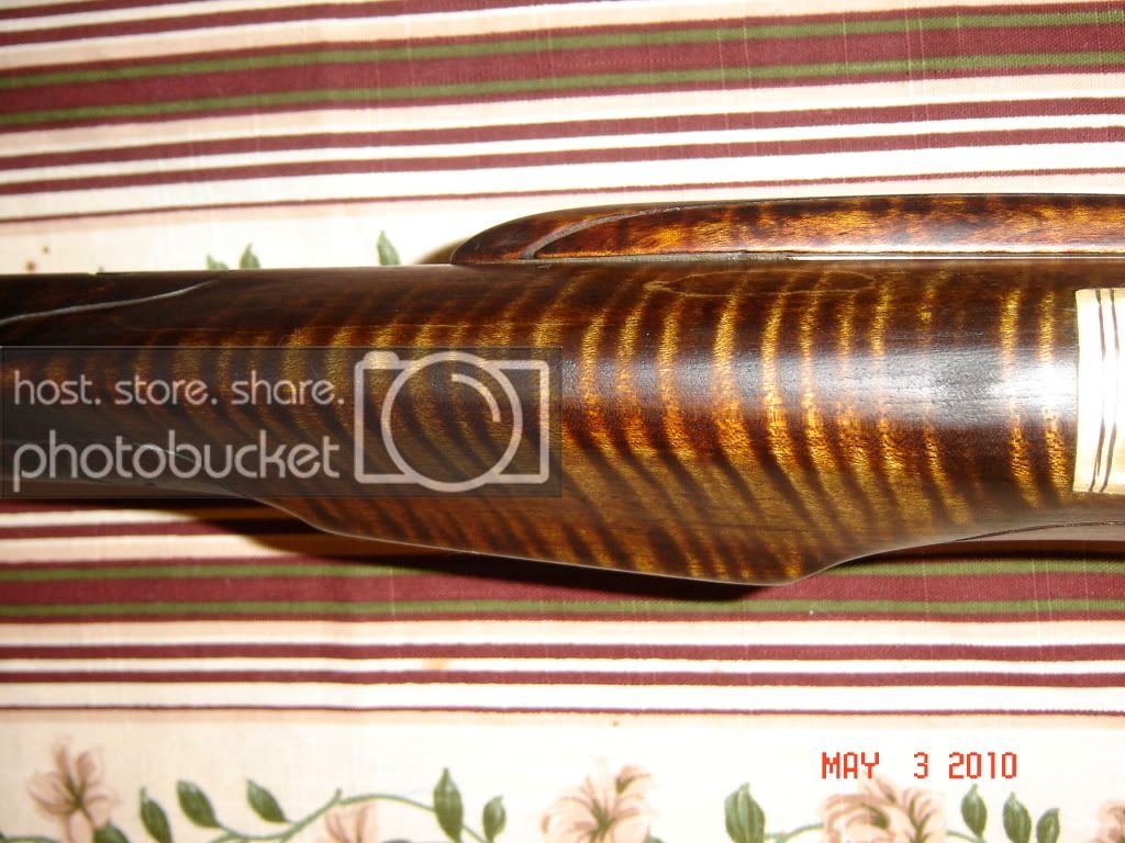

Ironic how no one mentioned what has been used on maple for centuries, Aquafortis.
Before:
After:
This is what every longrifle was made from and how they were finished. I dare ANYONE to match this with a BLO finish. Yes a BLO finish does indeed look nice and I use that to but it pails compared.

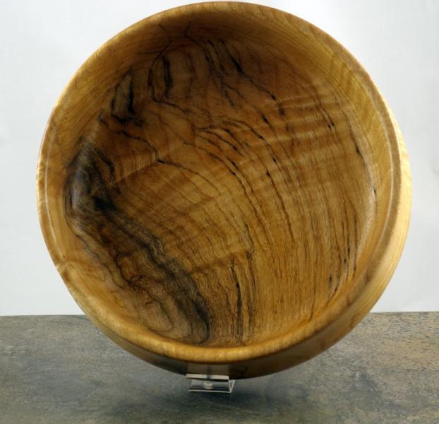

Mahoney's utility finish. It is not just walnut oil. It dries hard, is food safe and darkens the wood minimally. Available from a number of places. Second choice BLO. I Use BLO to finish custom gun stocks. On those to get a deep finish it takes a number of applications. As stated Tung is good stuff but can be hard to find. Most is a blend. The bowl in the image is finished with Mahoney's
