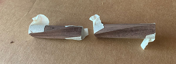

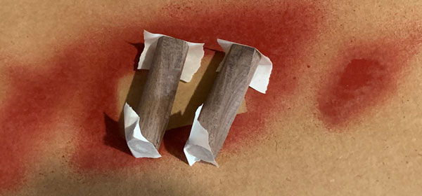

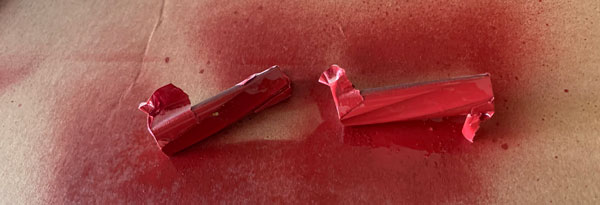

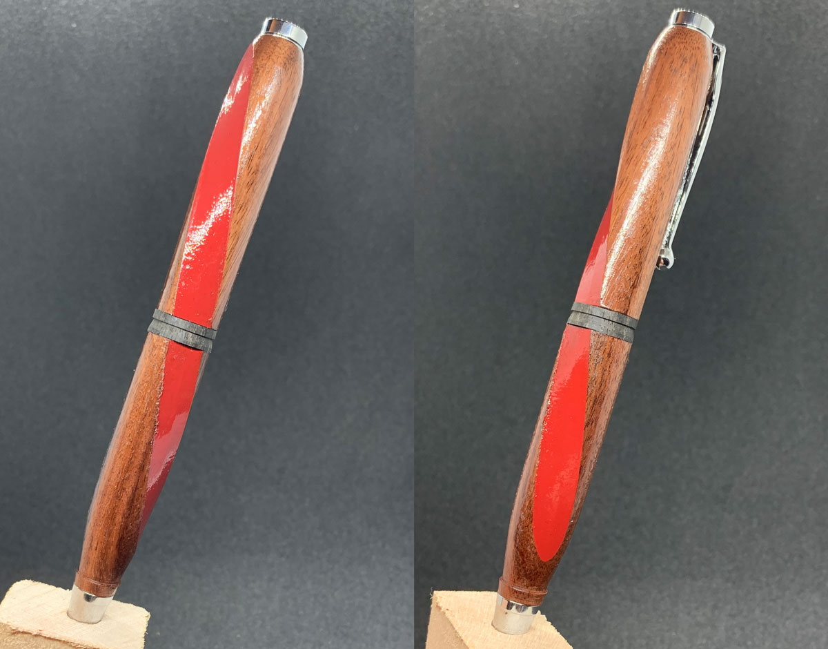

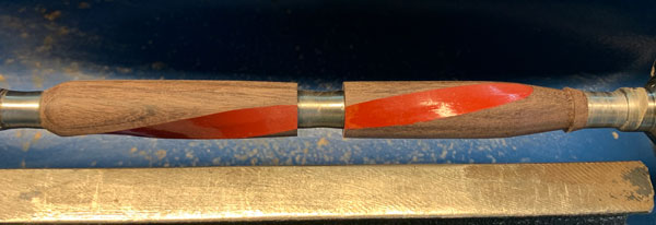

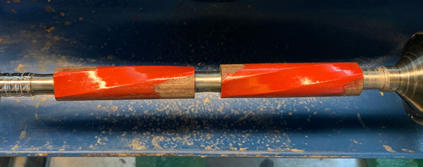

Unsure if this is right or wrong... but I went ahead and used a can of red rustoleum on a blank I ran through my twisting router jig.
Then I turned and finished with an ebony center band. Thanks for looking!

Not sure about the durability of the Rustoleum Paint on it's own, but that aside, I like the technique.
I could see an alcohol dye application here that would be maybe more appealing for most wood enthusiasts!

Good feedback! I wanted to try the technique and see what happened. Finding a durable pigment is one of the things I need to investigate. Thanks for the alcohol dye suggestion.
So far it's holding up... but it's only been 48 hours. ;)

How do you learn if you don't try out different things. Top marks for effort its different for me Red takes your eye straight away maybe something less striking but very well done.
