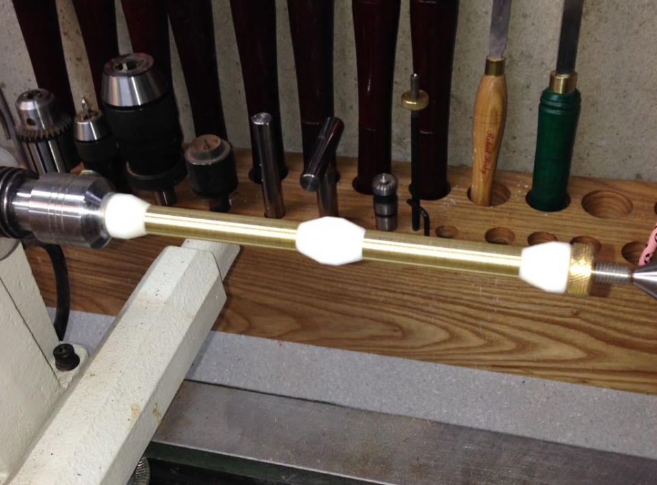

This may have been covered before, but I did not find it doing a quick search. I use my old pen mandrel with Delrin bushings to sand and finish blanks. After sanding a few brass tubes by hand the other day, I decided there has to be an easier, more uniform way.
I just use the same setup as I do for finishing. I use really fine sandpaper, since they clean up very fast.
OK, here are my personal thoughts on tube sanding. I hear about people sanding them on the lathe but I don't believe that's the best way to do it. My belief is if you use a very coarse sandpaper or emory paper and put lots of pressure on it as you rub it across the tube, you will put bigger scratches in the tube resulting in more of a bite for the glue to hold on to. But that's my opinion and there could be other reasons not to do it my way.
Rod
Nice setup Lee! I'm not sure uniformity is s concern over making sure the entire thing is scuffed....IMHO!! I put them over a pencil and hit it with 100g on my ROS. 2k pens and I keep trying to improve how I do things. The ROS seems to give me great scuffing over the entire blank, but again, uniformity hasn't been my goal.
That's a good looking setup Les. I used to sand mine on the lathe with 120 grit, just enough to get the nice spiral down the length of the tube. I realized that I would do it with less fiddling with the lathe if I used the 1x30 belt sander. I hold the tubes by hand, get one end the get the other. Works really well and it's fast. Not that speed is important, I just don't like changing the lathe setup often
I should have explained my primary reason for this. I am not a seller so I am not looking for the most efficient way to do this -- this method does require a little more setup. In the past I would sand around the rings, to basically create rings or ridges to provide more grab. But at times I felt like the gaps were just too great. Some of this was a lousy drilling process using my drill press, and getting probably more oversized holes than would be typical. I switched to drilling blanks on the lathe, using the new Nova Pen Drilling jaws on a Nova Midi chuck.
My goal was to get a really smooth, and close, fit between tube and blank. Besides drilling on the lathe, I recently started drilling with undersized bits, as well. For example, I'm using a Z bit instead of a 27/64" bit on a Virage kit. By having a pretty close fit between tube and blanks, a minimal amount of adhesive is required, whether epoxy, polyurethane glue, or CA.
