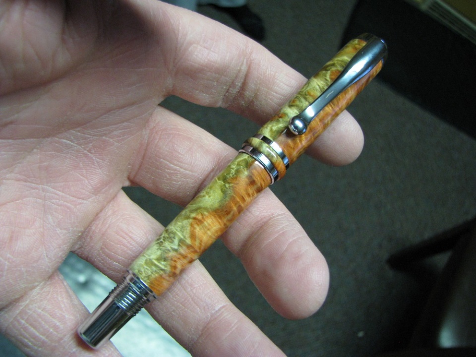

I needed to disassemble the cap portion of one of my favorite pens I've made. For some reason the trim ring on the pen ended up with something black on it. My best guess is that even though I waited a couple days after it was finished to put it in a pen pouch, the CA wasn't fully cured and it transferred some of the dye to the trim ring. Tried a variety of solvents, including CA debonder, to remove it with no success.
So I figured I'd disassemble the cap and make a new trim ring from wood - I still have the cut-offs from the exact blank used to make this pen back in November.
The kit is a Triton in Chrome w/ TiGold accents. Wood is stabilized Flamed Boxelder Burl.

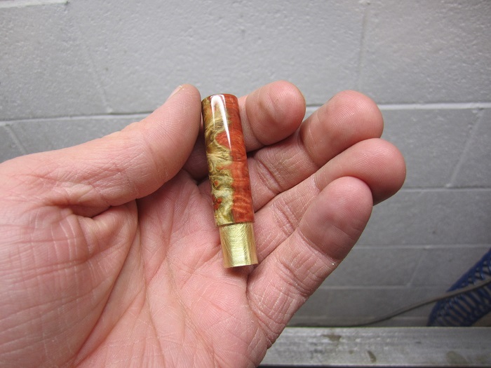

When knocking out the threaded insert/bottom portion of the cap, the brass tube ended up sliding part way out - separating from the glue I used to glue in the tube. I do not remember which glue I used - back in November I used CA, Gorilla Glue, and Epoxy on a variety of pens to see which worked better for me.
How would you go about trying to slide the tube back in? It's going to need some sort of force to get it back in, I know that for certain.
I could disassemble the kit and use it to make another pen, but I would really like to salvage this one as it is - this is one of my favorite pens I've made and this quality of FBE Burl is extremely hard to come by, so I don't want to end up losing this blank as I've only got 3 more left of this quality.

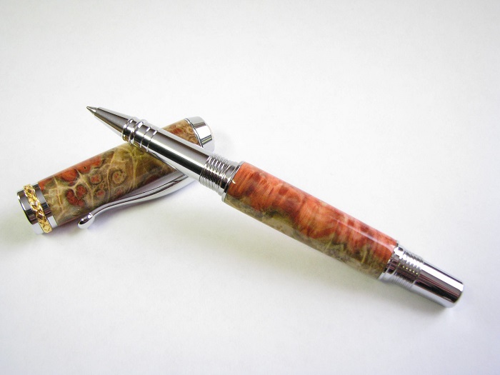

I've attached an image of the problem, as well as the pen from when it was first finished.

If the material cannot be completely removed from the tube sand the exposed portion of the tube and slowly press the material back over the tube using a pen press or screw clamp with wood pads. Seal the ends with thin CA. You should them be able to reassemble the pen.
If you cannot get the tube completely back, use the same size tube and glue in from the opposite side. You will then have sections on both ends to cut off and trim, but your entire blank will be supported by brass.
Make sure if you do this you sand/clean the inside of the tube afterward. Where the two sections meet you'll have glue run-out that could interfere with assembly.
You now realize you have a glue issue that you need to address and correct. Either not enough, did not dry and cure, hole too big and glue did not fill void. I bet it was not epoxy. I am betting CA.
Cut the end off and reinsert it on other end and glue it in. Do not try to push it in. What good is that going to do.???? It will loosen whatever bond is left on the remaining portion of the tube.
Probably the best solution would be to see if you could knock the tube completely out and start over. That would be what I would try . Now you run the risk of cracks in the blank. Not a pretty scenario. Need to learn from it though or these problems will occur again. Good luck.
put thin ca on the part of the tube that is out and push back in on something flat ,stand on end let the ca run indide down to the part that was not out got to work fast . i have done this a time or 2 ...worked for me

This morning I turned a new trim ring from a cut-off from the blank that, for some reason, I had saved since making the pen in November. Needing to replace a damaged trim ring was the reason for needing to disassemble the pen in the first place. This is the first custom trim ring I've made - though I've been wanting to do a ring & finial replacement on a pen for a while, but haven't had a chance yet.
And, having been careful with the glue and everything else in the process, I didn't even have to refinish the upper portion which had the tube slide out! (Sorry for the horrible quality follow-up picture.)
Thanks for the suggestions and help! Don't know if I would've pulled it off so gracefully if I hadn't been able to get some help from y'all!
