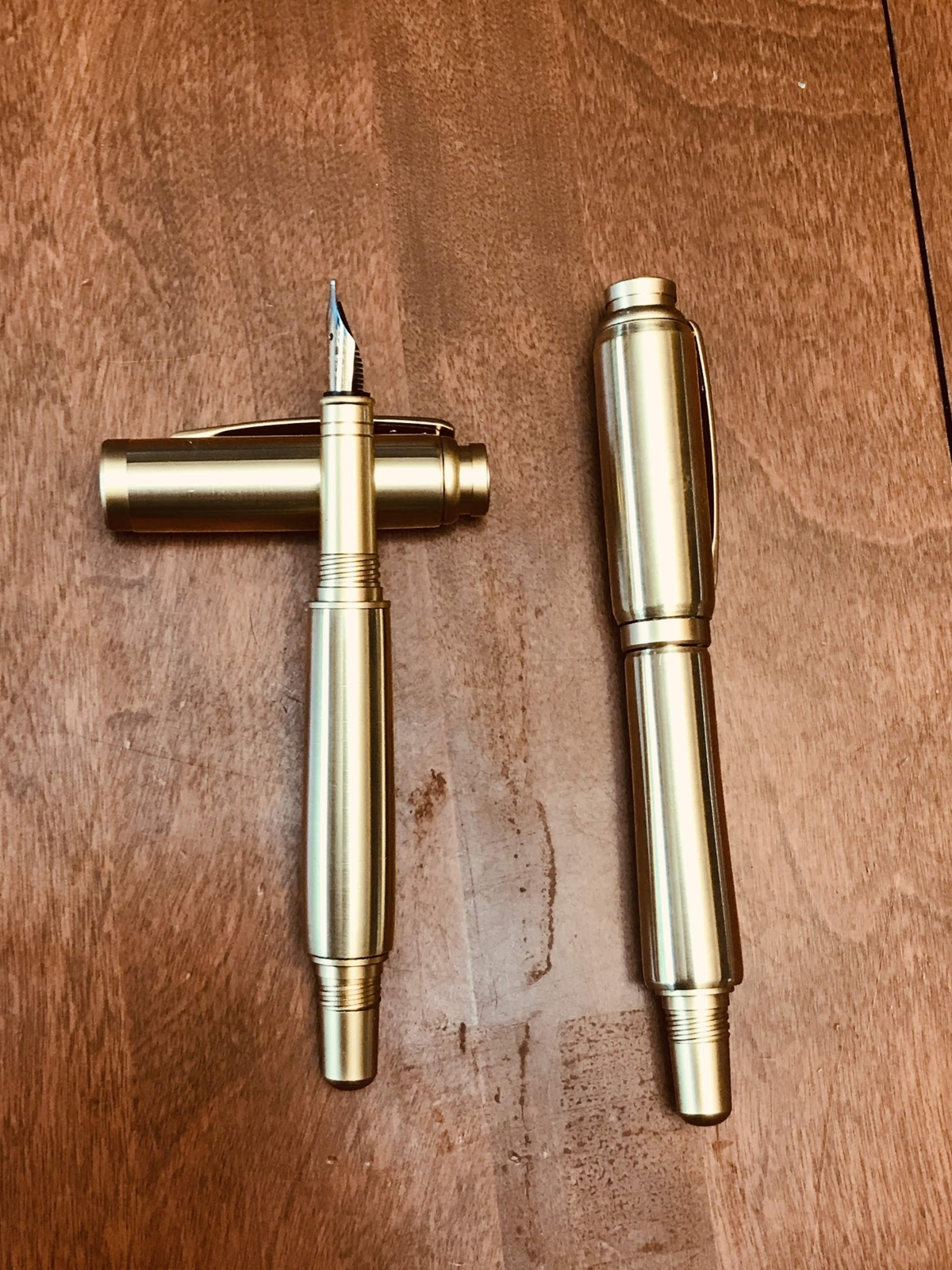

A few weeks ago I did an aluminum fountain pen. Here is the brass version. These are the Commander kits. There's no finish other than polish. The picture hides some of the detail but the pens have a brushed brass look. I prefer that to polished, and they will not show wear as quickly.

Very well done, and very distinctive! Could you spray on a light coat of poly or something to keep it from tarnishing? It's so nice now, I would just hate to see it weather....

I keep going back to look at your really nice pens and something caught my eye. How did you get the section and the receiver to look like brass? Did you turn and thread them as well?
Careful planning. :) The kit is the Commander in gold, and the color is close to the brass, plus the lighting in the photo makes it look even more so. That is another reason I finished the brass with a brushed look, it more closely matches the kit finish.
On some chrome (and other color) pen components, if one accidentally buffs them a tad too much (DAMHIKT :oops:) , the brass base shows through. DrD, I was wondering the same thing.
