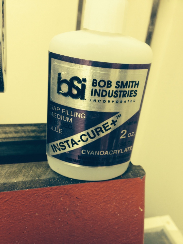

This glue works well.
I also use it for gluing leather tips on pool cues. Shop online. 2oz bottle for $10.
