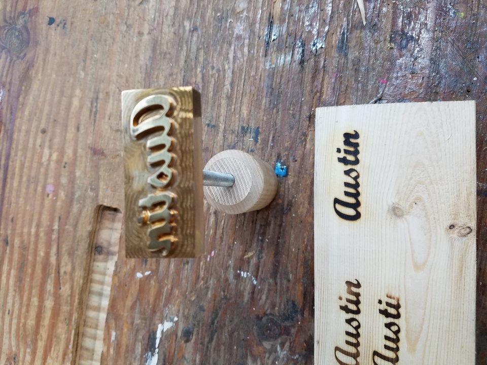

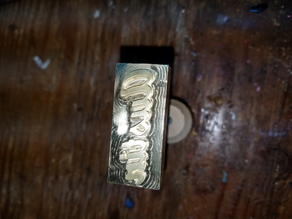

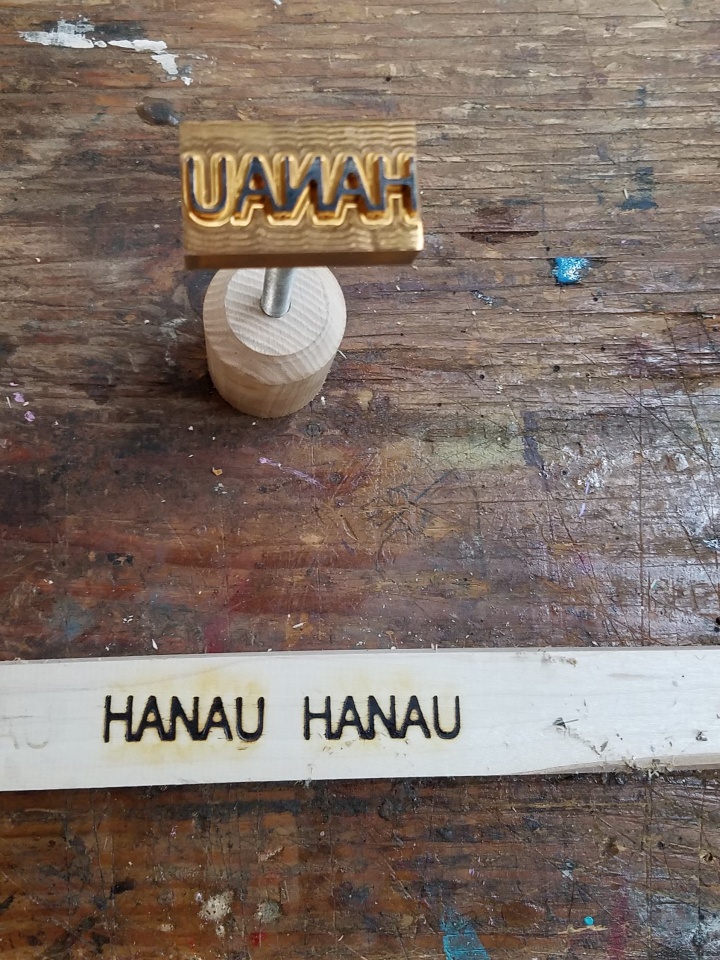

Been trying to get time to mess around with making a branding iron.
So far pretty happy with it.
made using a 1/2" x 1"x 2 1/2" brass.
Eventually want to make cutting boards and to be able to brand them.
how you did it?
Made it on a cnc milling machine.

Thanks
I used a 1/8 carbide end mill think it was 10ipm
1/16 end mill at 3ipm
A little over hour on the mill.
This was made on a cnc mill that I built.
The brass I got of ebqy
