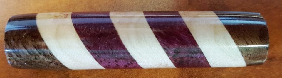

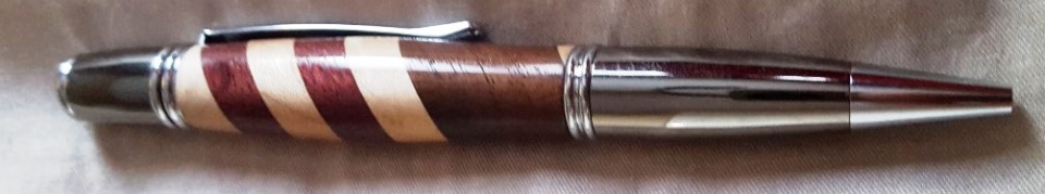

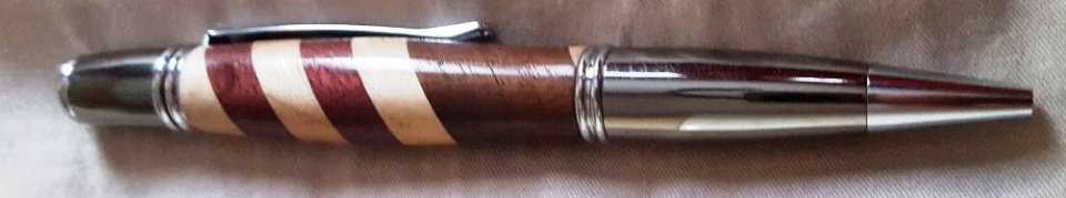

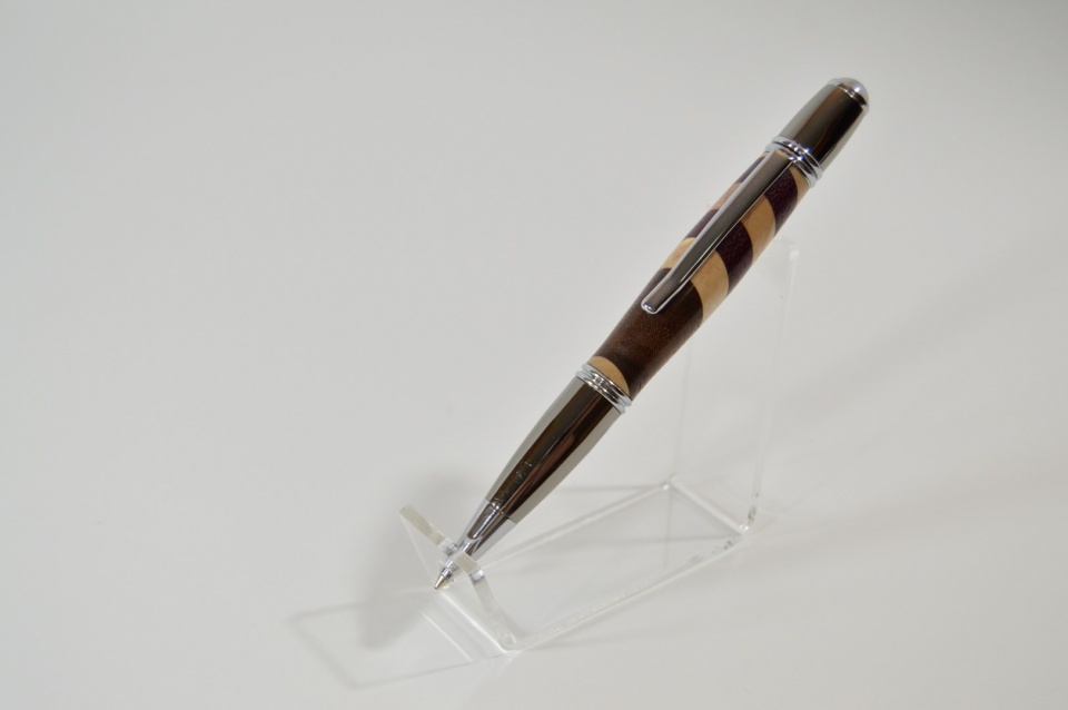

First ever pen - finished with docs wood turners finish (already coming off)
This pen is a blank of walnut, maple, and purple heart.

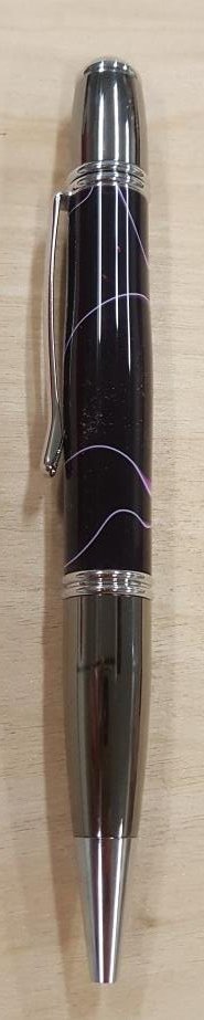

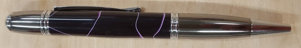

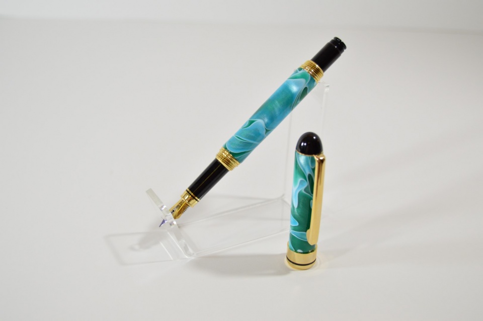

Second pen ever was my wife's first attempt at the lathe ever - purple lavabrite acrylic. Couldn't be more proud, absolutely incredible what micromesh can do

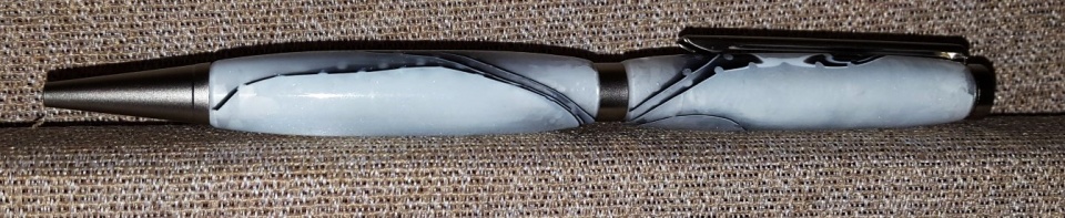

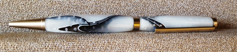

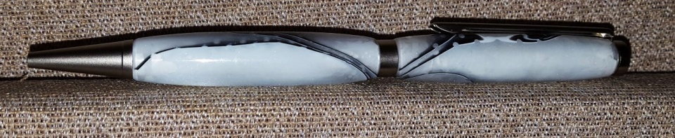

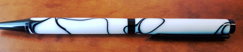

Third pen (my second) - black and white slim line. Guys at woodcraft say it's ok, but looking for feedback.

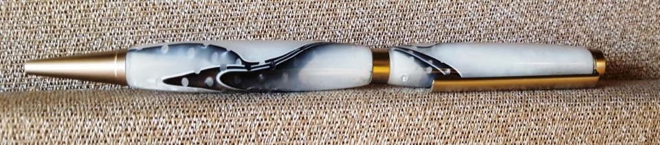

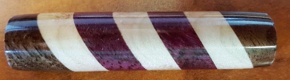

Fourth pen - actually just a blank from the second half of the first pen with first ever CA glue finish on it. Easier than I thought it would be, but admittedly needs a bit more polishing.

Welcome! The slimline is very nice! You already have an eye to be able to line up patterns from one tube to the other. Very good in keeping the diameters consistent throughout on this pen.
The purple one has just the slightest bump in the middle. I am assuming this is on purpose as it appears to very symmetrical. Bumps and ellipses you will find are very much a personal preference.
Overall good start! Welcome!
lhowell, thanks for the honest comments. Much appreciated.
I have been finding that it is hard to get honest feedback of potential flaws.
The bump in the middle was intentional and symmetrical.
She wanted it to be a bit smoother in its transitions, but the shape was overall exactly what she was going for.
I was nervous about the slimline, everyone we spoke too said it's the hardest one to do well.

Second, thank you! Every time I open one of these threads I mentally prepare for a horrid-looking (to me) "pregnant" wasp-waisted slim line. I am pleasantly surprised by all your pens, from what I can see in the photos (which I'm thinking you will likely improve at some point) your fitment is good (the slim looks really nice), as is your finish. Perhaps what looks like some sanding marks on the wooden one, but it might be from the finish as well. Someone above has noted the shaping oddity with your wife's pen (which is also great for a first go!).
Keep up the great work!

Nice pens don't think photos show the detail enough to comment on finish etc.

The First Pen, Nick, you have done a Great Job on the Joints of the Segmentation, they are Excellent.
IMHO I think you have been a little too ambitious, with using three Timbers.
The Walnut and Maple would have been fine on their own.
The Purple Heart is just sitting on it's own outside the Segmentation.

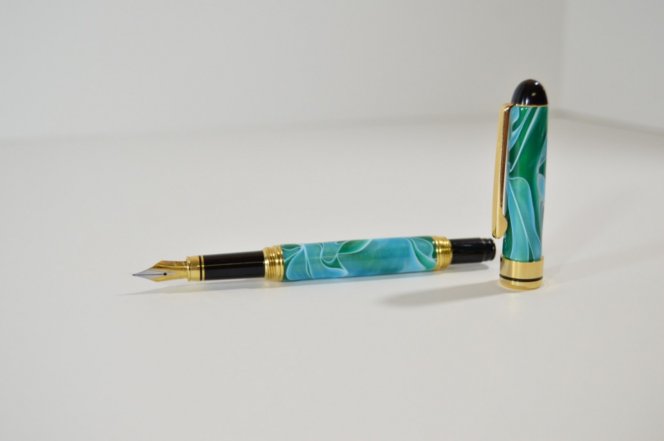

The Second Pen, Photo's 2 & 3, Christy, this Pen is Excellent, Superb Blank, Great Fit and Terrific Finish.
The Third Pen, the Slimline, Nick. I love the Blank, it looks Great.
However it looks like you may not have turned it down to the Bushings.
It may be the angle of the Photograph, but the Nose seems to be well below the Transition of the Blank. Similarly with the Center Band.
The Finish looks Great.
You commented that you had some trepidation due to the reputation of the Slimline.
I consider them one of the Hardest Pens to Make.
Firstly the 7 mm drill size, and the diameter of the Hardware, means that you have to turn off a lot of material, to get to the Bushing Diameter.
If you have had any problems with gluing the Tube inside the Blank, or if your drilled hole was a little over, or if you have a fragile or Cantankerous Blank all of a sudden you can have a breakout.
As well as the Difficulties mentioned in turning a Blank, Now you have to Turn Two.
All on a pen that has a hardware value of a couple of dollars.
Having said all that I don't mind turning them, they keep you awake and on your Game.

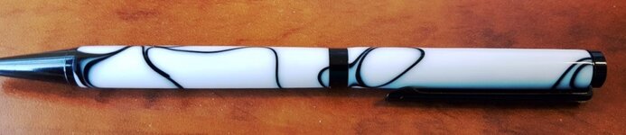

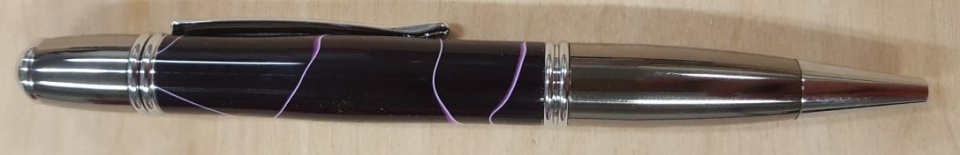

Please see second slim line attempt below.

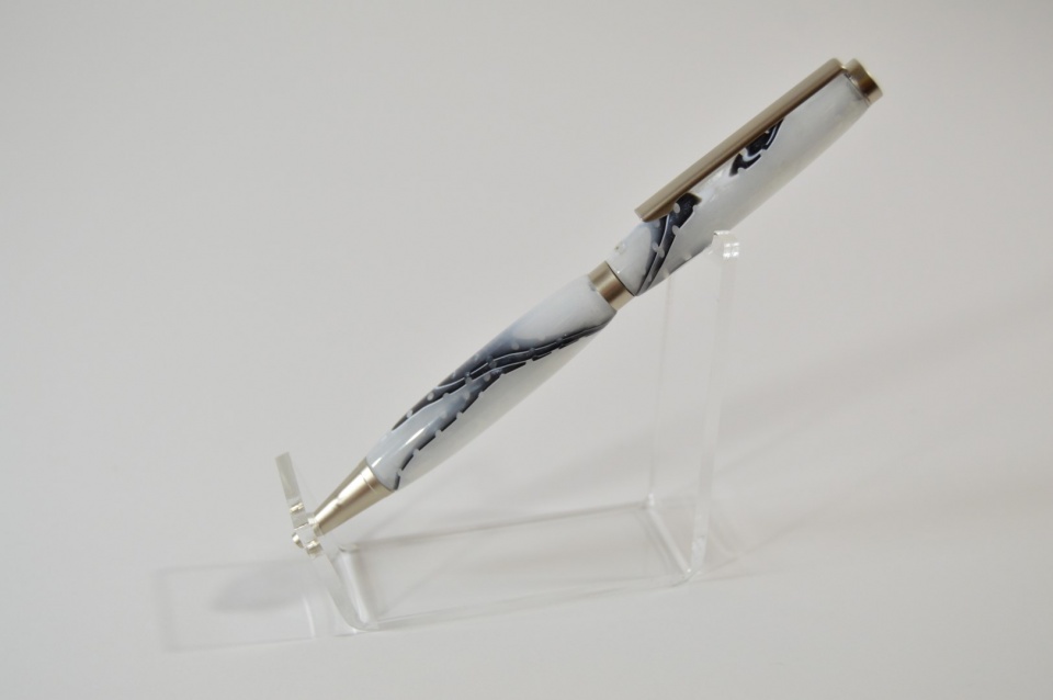

The transitions to the center band, nib, cap are not as smooth as I would have liked, but it is a learning process. Also, the blank had a bubble in it that is prominently featured near the clip point. I only found this when sanding and polishing.
Filled it with CA glue, cured, added 3 coats of CA as a finish and then sanded/polished.
It's ok, but I was NOT happy the blank I bought had hidden bubbles inside.
oh well, here's to learning some more.
PS: Christy has one chucked up and ready to sand/finish. So maybe another to share in a day or two. It's our first attempt at a fountain pen. She is doing an AWESOME job. So glad I married this one.:smile::biggrin:

Thank you!
Hi, Everyone!

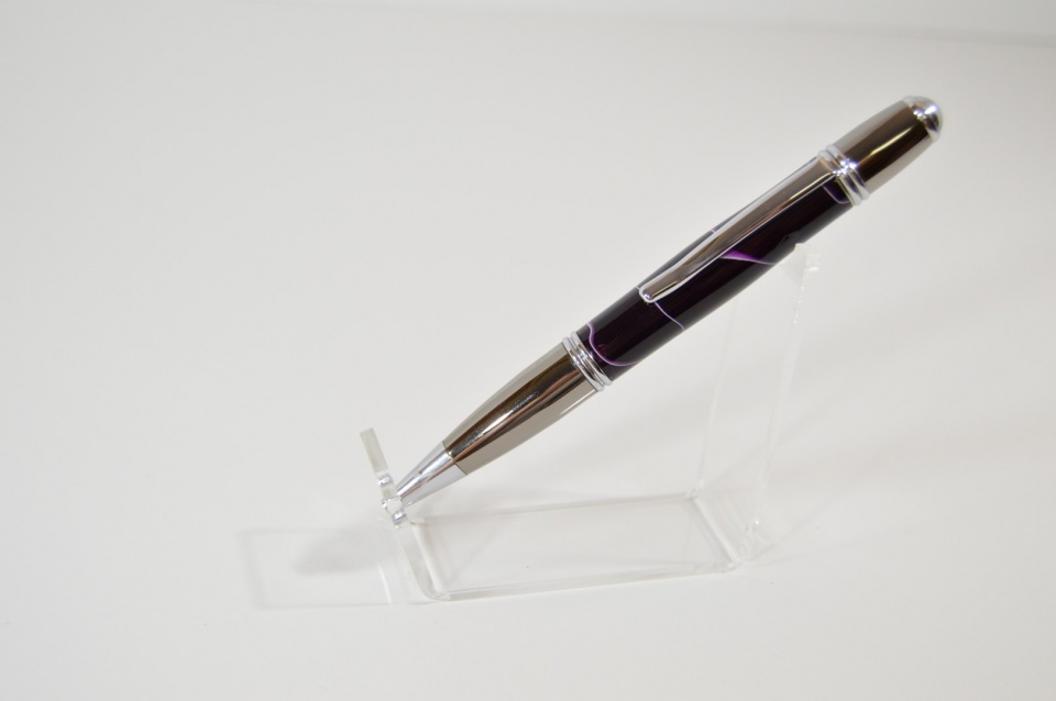

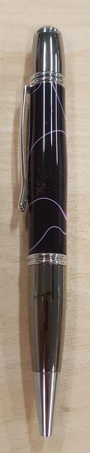

Thanks so much for the feedback. It's been very constructive and helpful. We spent some time taking better pictures last night (one pen is at Nick's work, so it hasn't been re-pictured yet).
For those who've posted their links in their profile, I've taken a look at your work and it's fantastic! We're glad to be a part of such a talented and helpful community!:biggrin:
