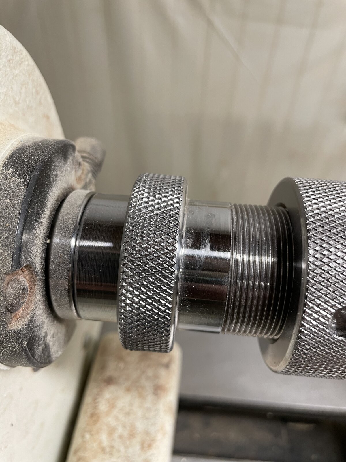

Doesn't look to me like your collet chuck is screwed all the way on. Here's a picture of mine, same lathe and probably the same chuck. Notice no gap

Make sure the lathe is level. I agree about the chuck not being screwed all the way on. It should sit against the ring for sure. All chucks do that. If you have a dead center, pop that in the headstock and watch it spin. If no movement it is either the threads or the chuck. try spinning the chuck on more. I would get a plastic flat washer between the chuck and the flat silver part. keeps from locking on there.
I agree with Ken, the threads do NOT hold the chuck "true", it has to seat on the spindle backplate to be held true. Measure the distance from the end of the spindle nose to the backplate on both lathes and see if there is a difference.
