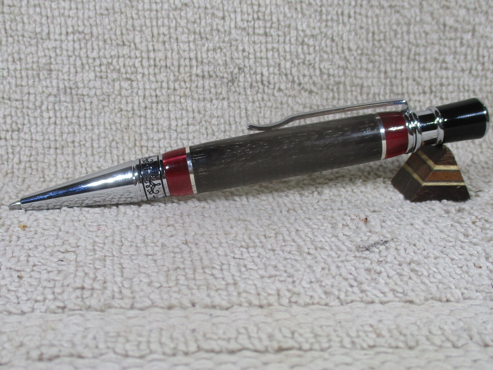

Aquilo kit from the Beaufort Ink stable just out. An excellent kit which uses the same tube, bushes and drill bit as a couple other of their kits.
Bog Oak with Kirinite ends. Wish my photography was better.

I saw on the UK forum that you used silver for the separators? How is that to work with?
I have a neighbour who is a silversmith and he helps with converting the silver into rings....one of two ways......using a jeweller's punch it is easy to punch out the correct size of ring and he is able to melt down the waste..... or buy lengths of flat top silver, bend to shape and solder. This involves no waste.
I use 2-part epoxy when glueing everything onto the tube and as it is a pretty soft metal turning is simple.
