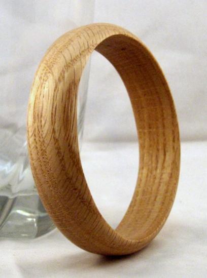

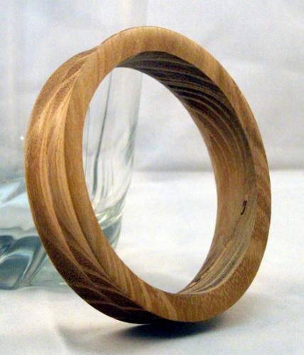

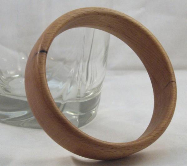

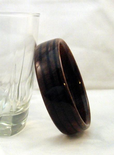

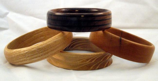

A brace of bracelets here. Black walnut, maple, red oak, and Honeylocust. The maple is salvaged from a steeple that fell after 100 years. Customer hasn't decided which she wants, but my wife is hoping it's not the walnut or locust.

Alice, these are all approx 2.75" diameter. That's the size that fits my wife :)
There aren't really standard sizes, but I'm finding that 2.5" fits over small hands, 2.75" medium to large, and I'll try a 3" pretty soon.
One concern is that these are face-grain turned, so there are weak spots at the end grain. The wood is still 1/4" thick (the oak is closer to 1/2") so it has some strength, but It's likely to break if pressure is applied at the wrong place.

So would one solid piece 3" round sliced off the end be better?. Then it would be expensive to find pieces that thick. Would pieces glued up to that thickness work?. Carl
fishlux
Aug 21, 2009
71
Delaware Ohio
Carl,
The first few I made, and I think the walnut too, were from branches 3"-4" diameter. Since the pith is removed, there's much less danger of splitting.
I think the most efficient and possibly prettiest way, is glue to pieces 3"-4" square and 1/2"-3/4" thick. Set them so the grain is offset 90 degrees. That gives you a very strong piece. The down side is that you have a line running around the bracelet and the grain looks odd. Using a piece of contrasting veneer makes that less an issue.
