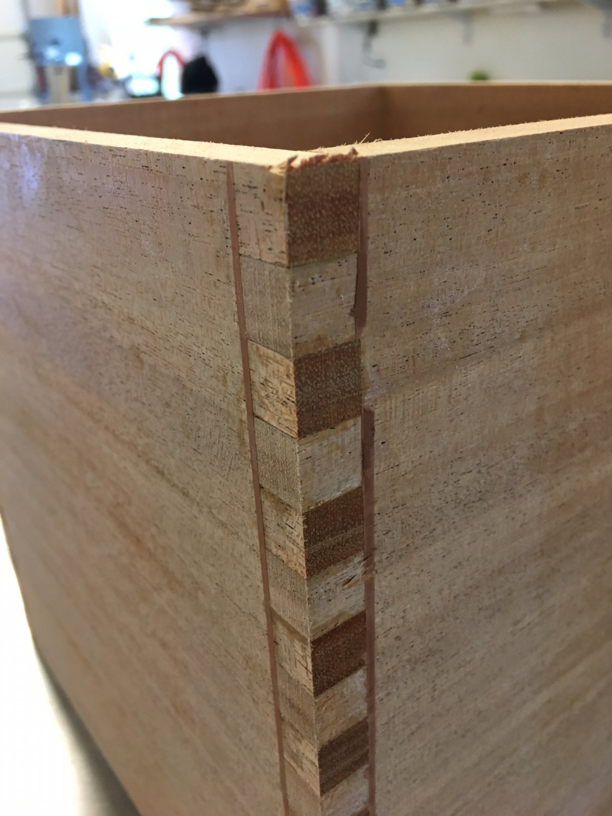

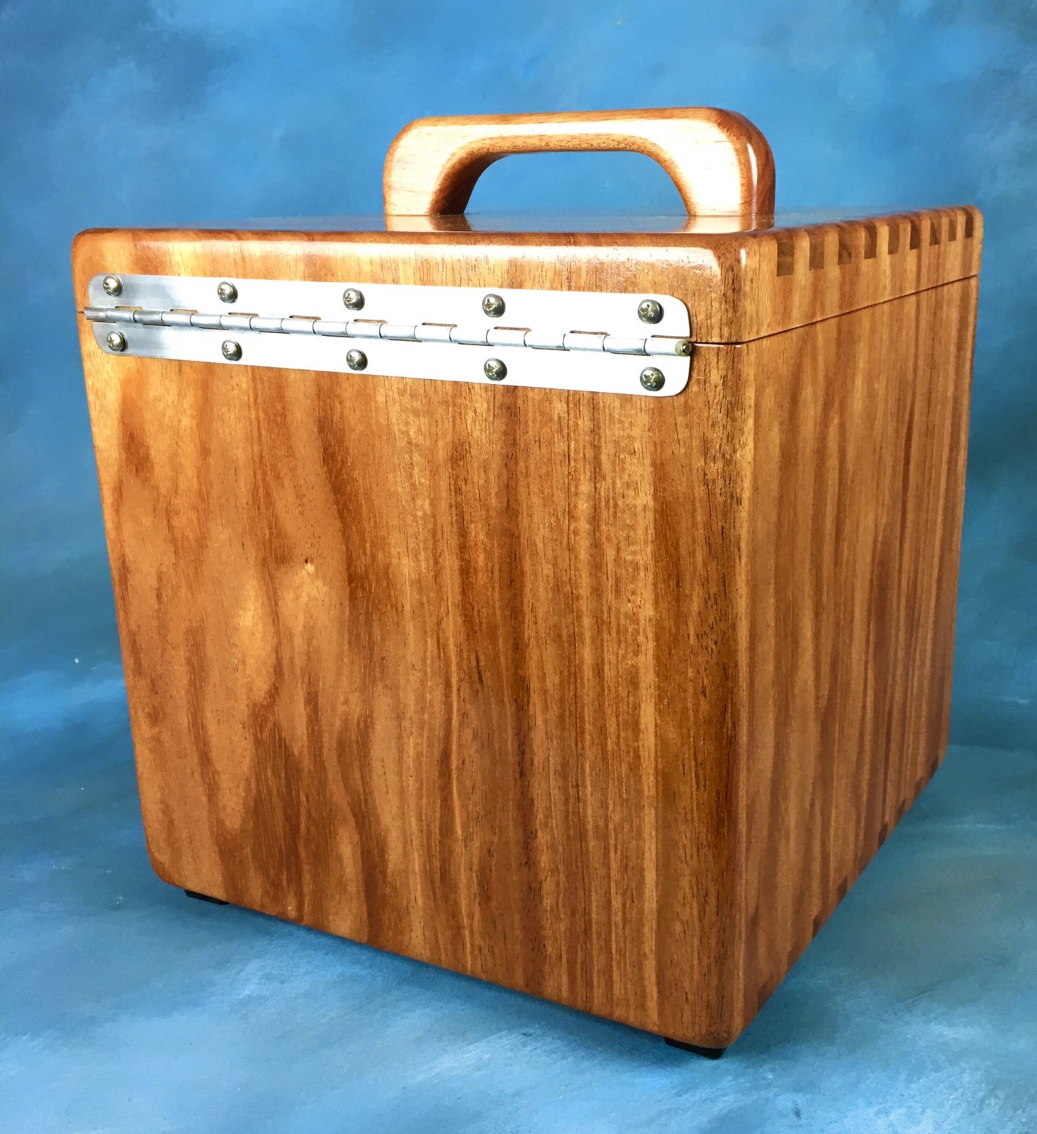

I'm not sure how many of you make box joints but the are very strong and attractive. See photos for the look in a finished box.
The issue is that you want to cut them to fit tightly, but sometimes after tediously adding glue to forty of so joints it can swell them. Then your beautiful box won't go together! Don't ask how I almost knew this.

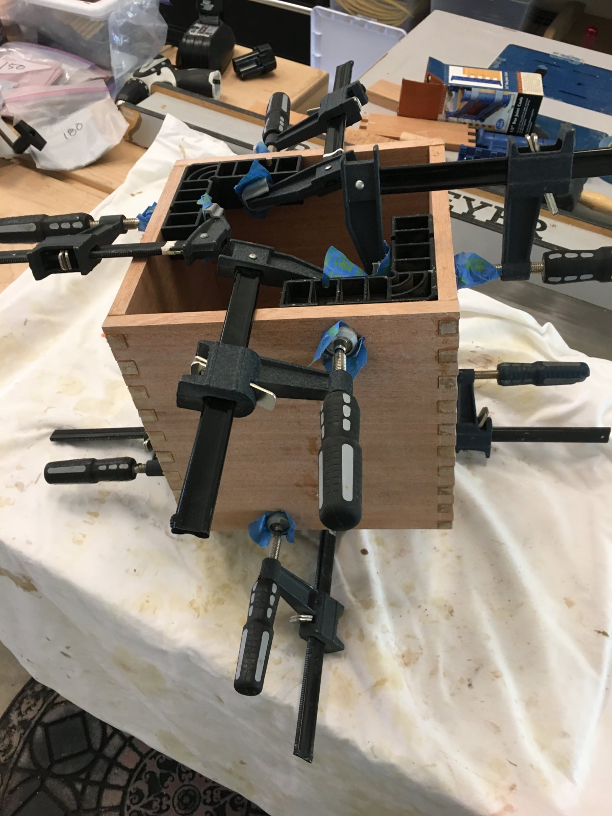

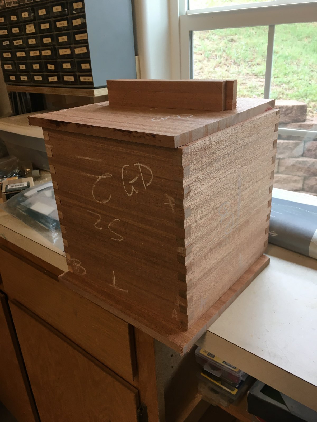

Shown is a very tight dry fit that required clamps to seat. Adding glue could have been catastrophic. I came up with a sanding block JUST LESS in width than the 1/2" gaps with two layers of 400 grit sandpaper. A couple of strokes per gap was all it needed to make the dry fit easier and more importantly it worked with glue.

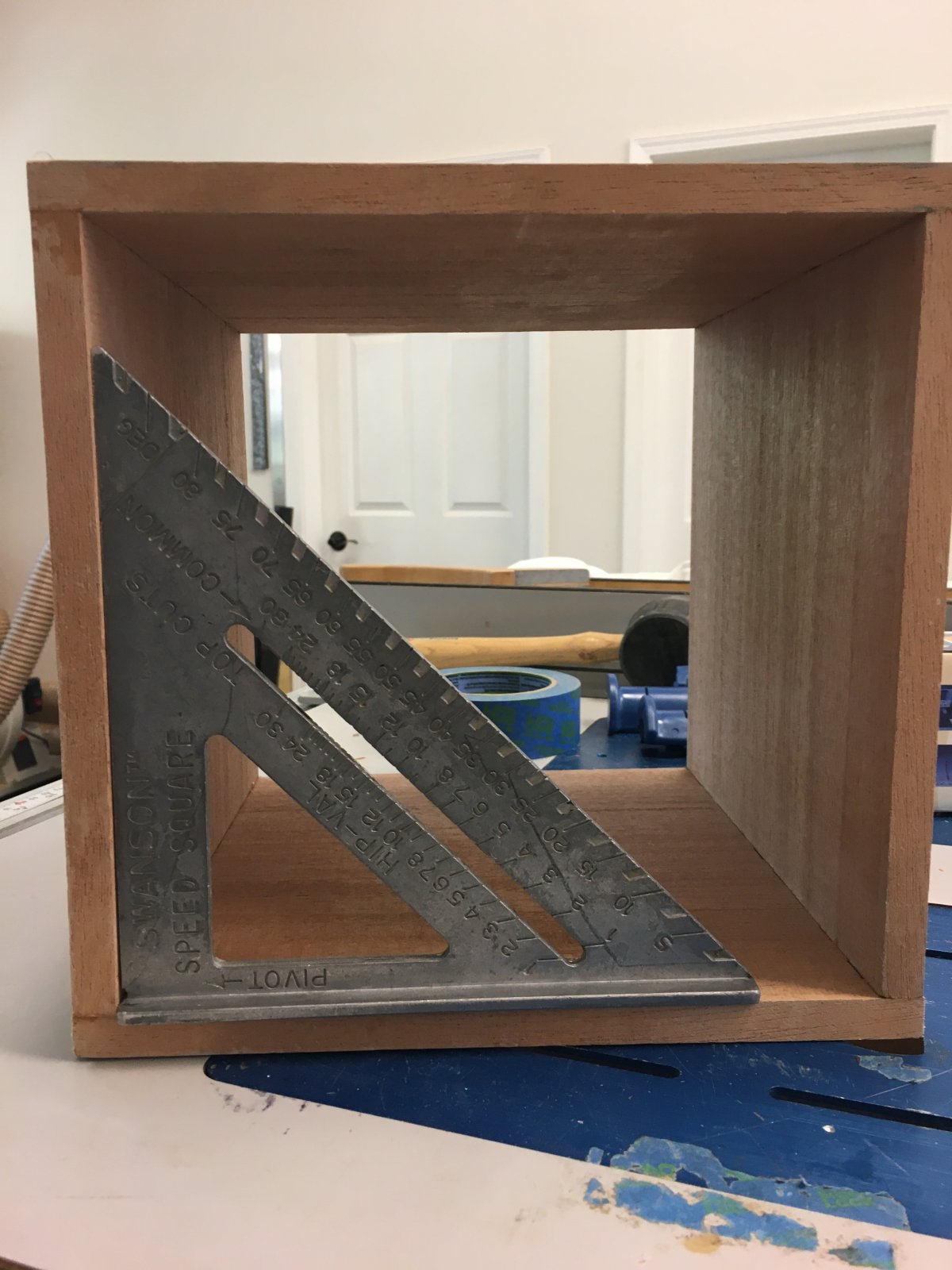

The third photo is after seating the joints and 4 clamps were applied to square the box. I'm a bit anal about joints so most were puttied to fill tiny gaps with mahogany wood filler. It will sand tomorrow to flush and the microscopic putty will disappear like in the finished box.
It is square!

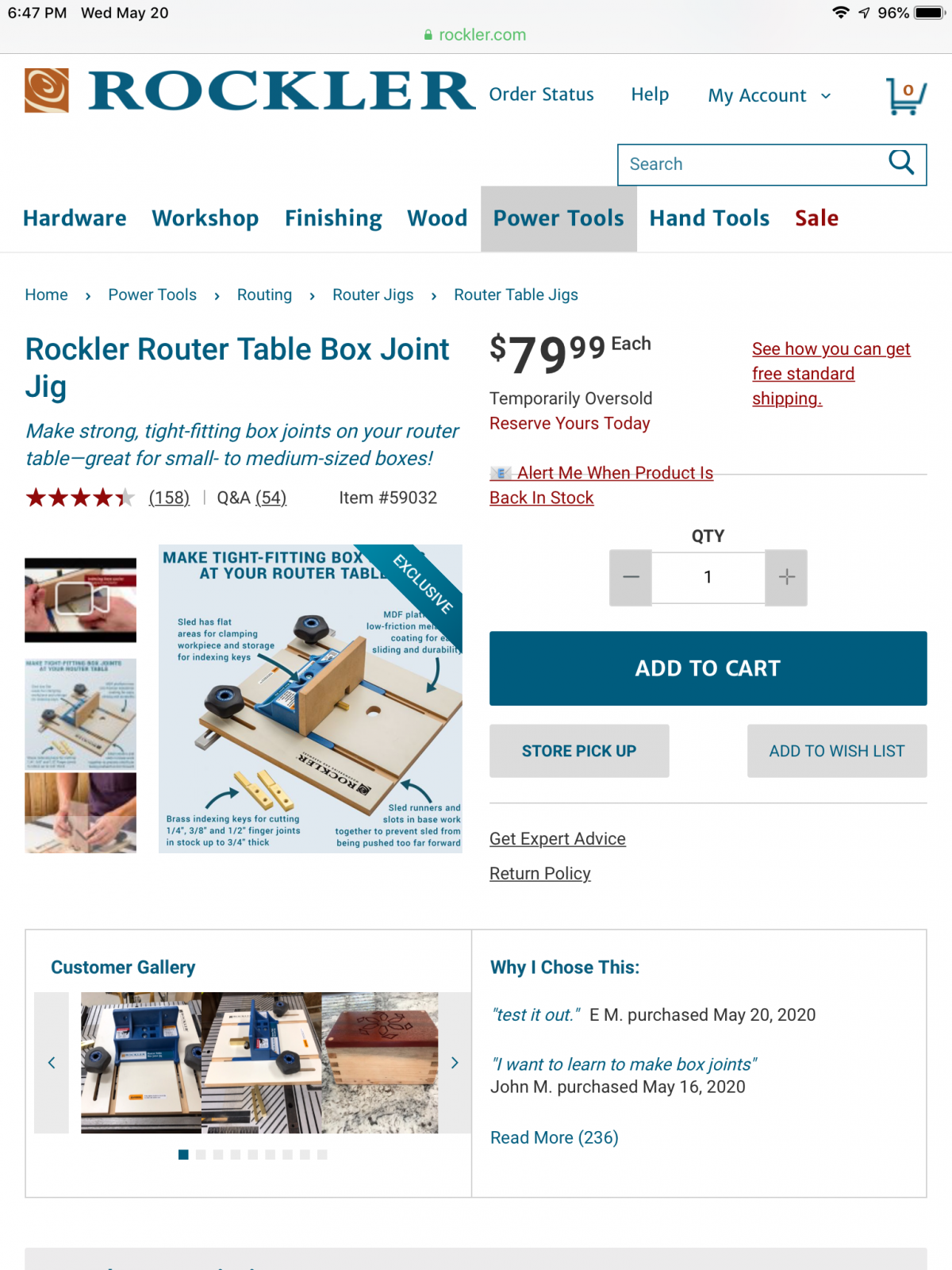

I use this jig from Rockler. Add three quality spiral cut bits in different sizes and you are set. The jig gets used so much in my shop that I may buy a new one. The skill is in test cuts using the SAME material you will use for your box. After the test cuts are satisfactory, make sure everything is tight and cut. My goal is to get them as tight as possible yet get them to go together. Any time my joints go together easily it is sign to reduce the distance from the router bit to the key. If you very closely look at his joints, they fit together easily yet have chips, tear out and spaces. Most table saw blades will give this kind of result even with 80 tooth Freud blades. When the box is glued together and sanded these will be unacceptable to me. Each one must be filled with wood dough and big ones can be seen easily in the finished box. Since I sell boxes my sales would drop to zero with those joints. I have 1/64th or less gaps in a few of the joints and have decided to fill the entire row just to be sure. Today I sanded the filled joints and there were still two very tiny gaps left that I filled. I made a book shelf for my classroom a long time ago and had some so so dovetails. I filled them and they looked fine with my classroom reference books on my desk, so sale no way.
