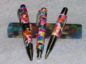

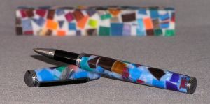

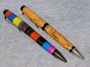

Buy lots of saw blades
Chop saw, band saw, scroll saw, and about 4-5 days. Oh don't' forget your haz-mat suite and respirator. It's FUN
The oven works on some not all. Best thing I would say to do is cut the balls up get your outer layer and think segmented. Cut them into smaller 3/4" +/- and glue them together you can get a nice colorful pen. Don't forget to paint your tube and inside of the drilled hole. Most all are transparent.
6 or 7 different balls glued together / other pen is and old fishing rod handle
the bottom pictures are about 15 balls chopped up and cast in ploy resin
Have Fun
Bruce

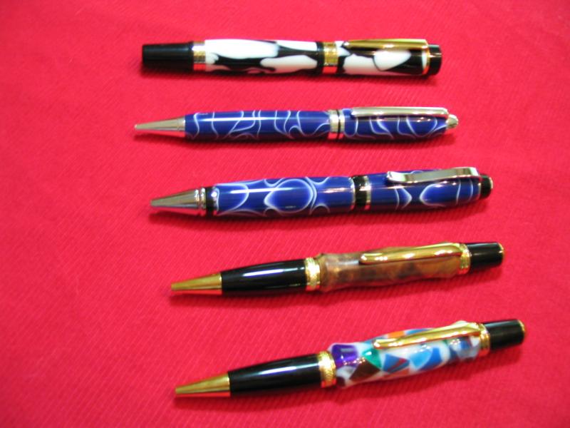

bowling ball blanks
i'm kinda glad to see this come up. just yesterday i drilled and glued a tube in a BB blank that i got from Bruce119. did a wall street last summer and it came out great. i gave it to my nephew to celebrate his ninth 300 game. gonna get another turned today or tomorrow for stock/fall craft shows. the first one that i did is the bottom pen in the pic.
