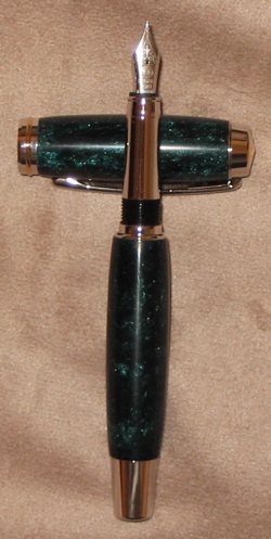

This is a platinum Jr Gent fountain pen in green bowling ball material. I got the blank from Sheila (POC). The finish is TSW and looks much better in person than it does in the picture. As always, thanks for looking.

Fred thats nice work as usual. Follow up question for you. How do you like turning BB blanks? Did you buff them? Sorry thats two questions.

Wayne, I personally love turning the bowling ball material. It's more forgiving than acrylic and doesn't catch as easily and it finishes beautifully. I didn't buff this pen, but I usually do and may end up doing it with this one. I wet sanded down to 2000, then used EEE wax and CA before 1 coat of TSW.
