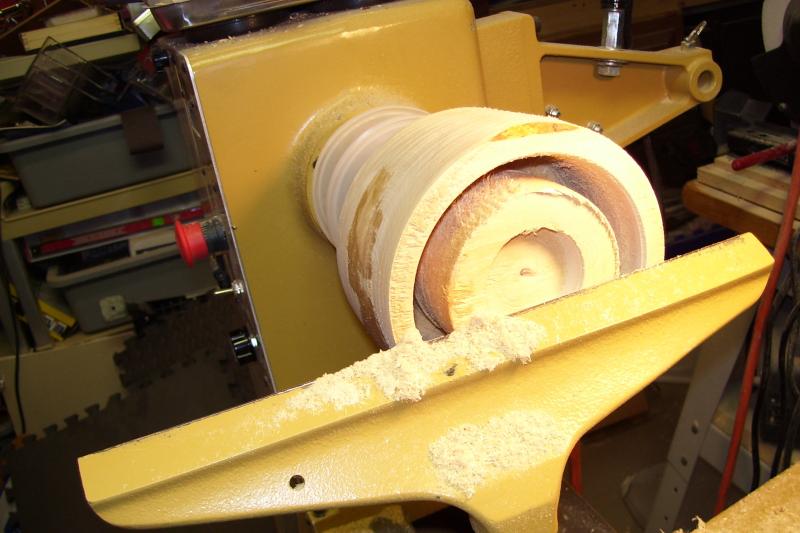

This appeals to me as well. I saw a set-up for the mini lathes. I sold my old Jet mini and just have the VS and a Powermatic 4224. The 4224 can do it with ease, 3hp and AC drive. AC drive gives tons of torque at any RPM... 1-4000+
The VS Jets and Turncrafters will work too hard and wear out or burn up a motor/controller.
Attached is a photo of the 4224 with a bowl I tried with homemade coring tool...
