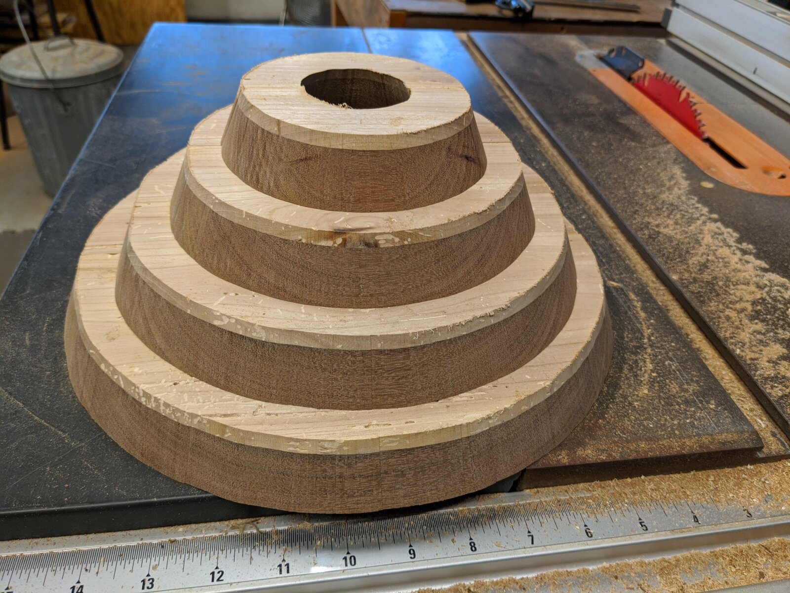

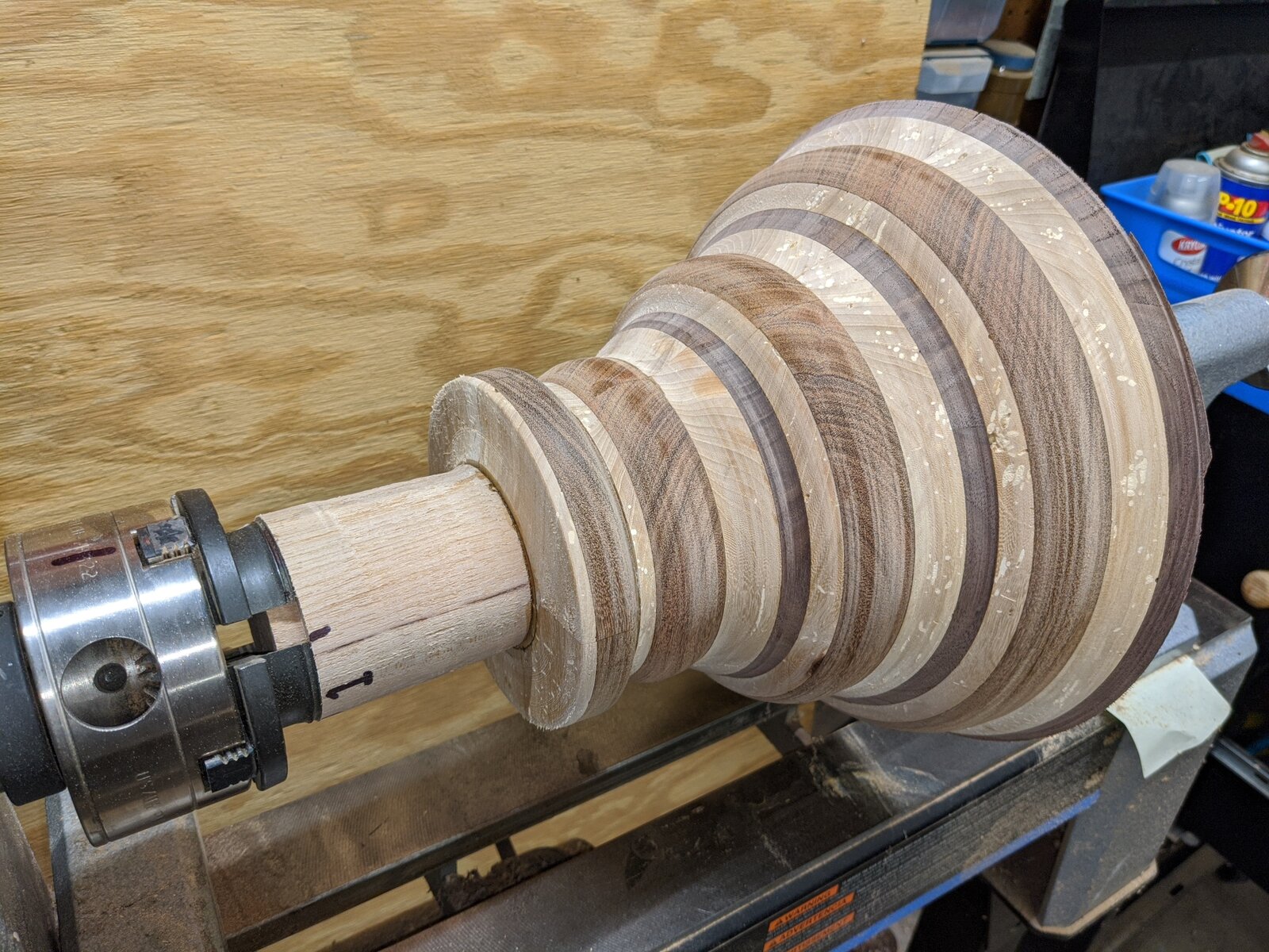

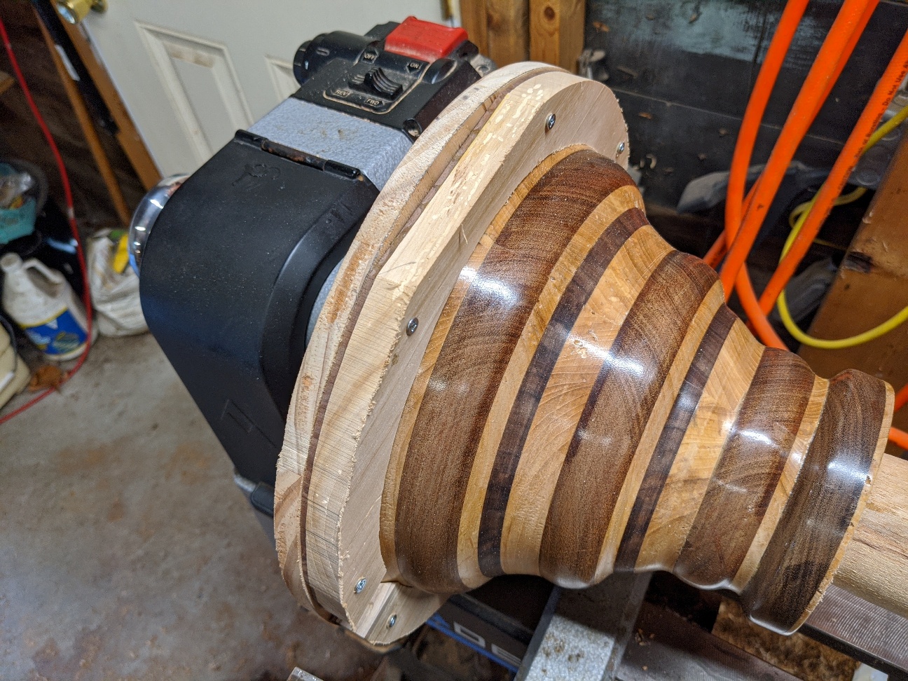

Started off as an experiment. Didn't exactly know all the requirements. Watched a few videos. Decided to experiment. Laminated some Mahogany to piece of Oak. Found I didnt have enough surface area to reliably glue it all together. Had to make take some Walnut and laminate it with some Cherry to make a few intermediary pieces. Figured I really screwed it up but said what the heck. Then I had to figure out how to hold this 11.5" diameter monster to remove the glue block and finish the bottom.

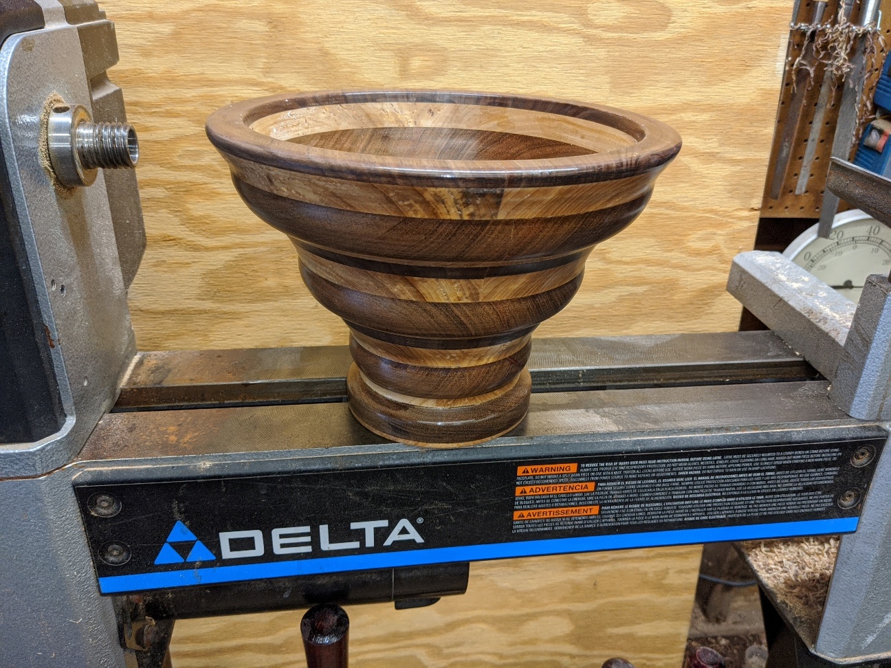

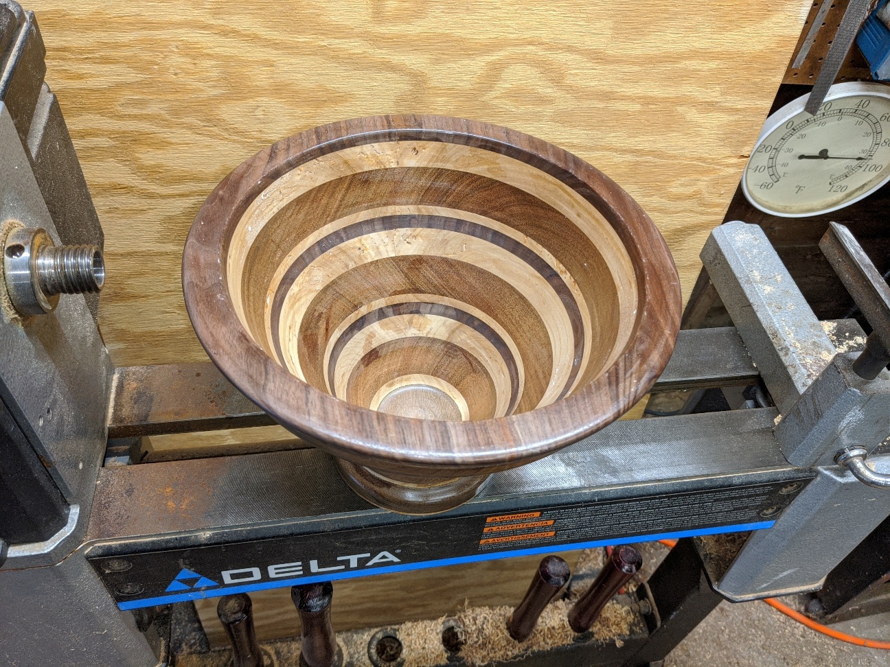

Turned out rather nice for a screwed up experiment.
