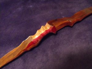

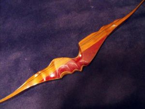

I used to work on Glass recurve bows with my dad when I was younger. Started this one a while back but have moved since then and dont have a place to work on it. My shop is a 8x12 porch and the bowbox would take up half. Besides I got into turning and was distracted by the lathe.
It's clear glass/walnut limb and the riser is also walnut/purpleheart and maple racing stripes. I Still need to finish forming the grip and tiller the thing.......
Its not really too hard just lots of work if you dont have the powertools....... Even with the powertools its alot of work.
