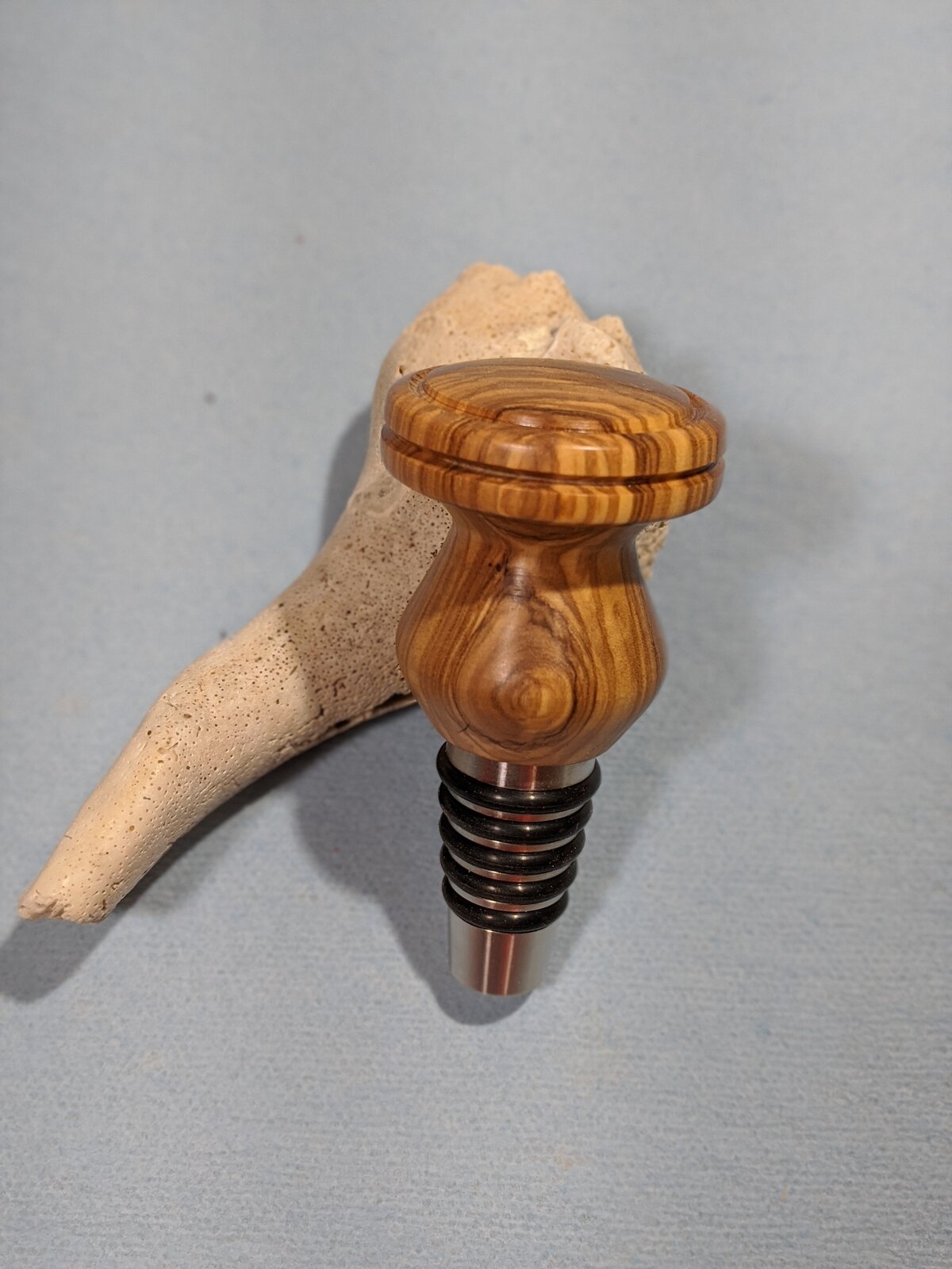

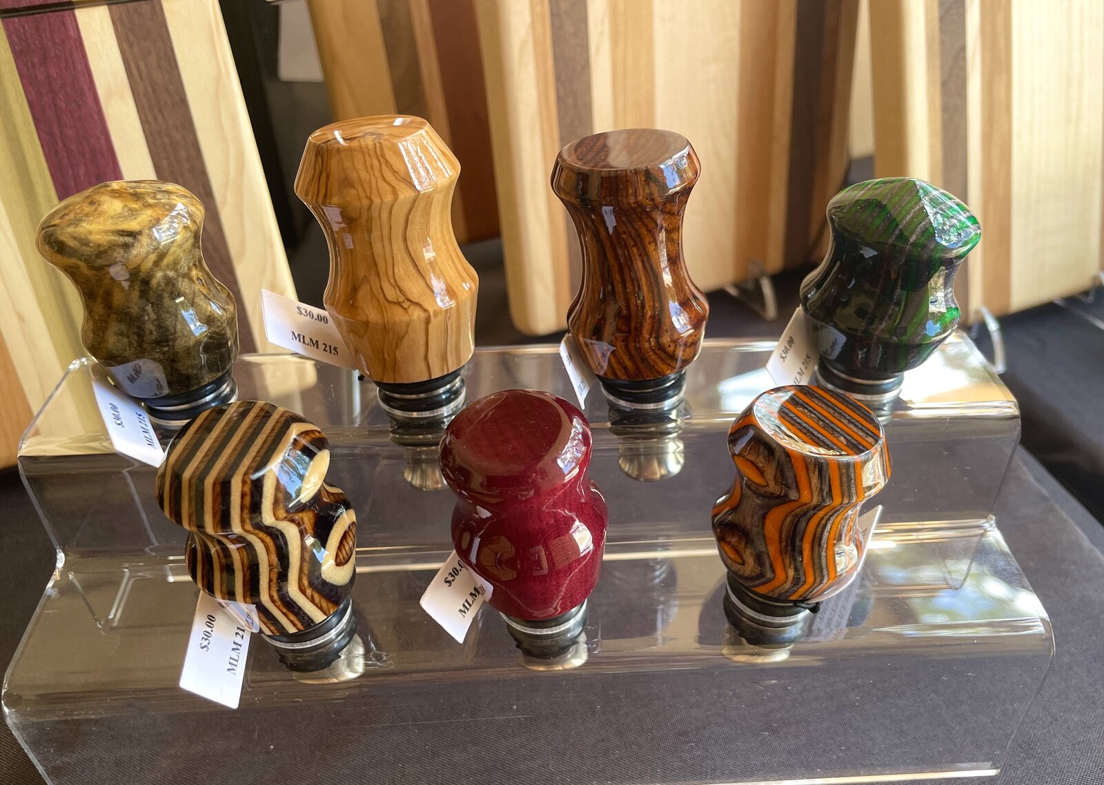

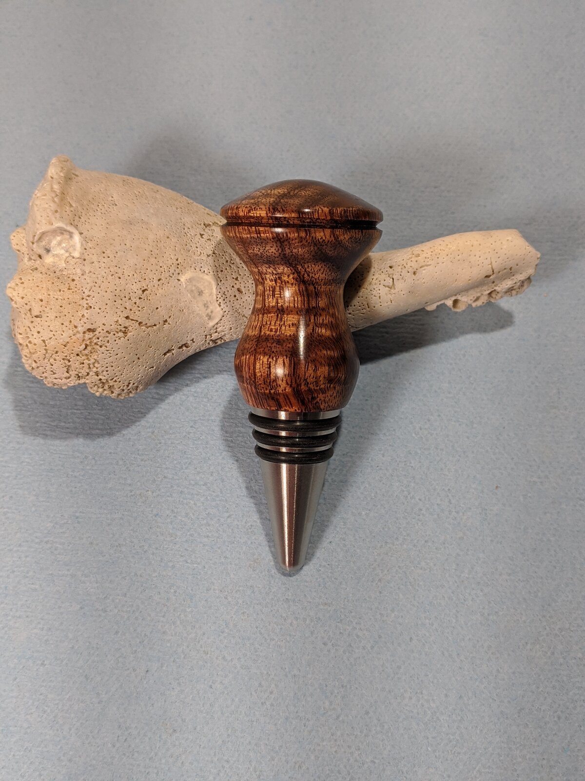

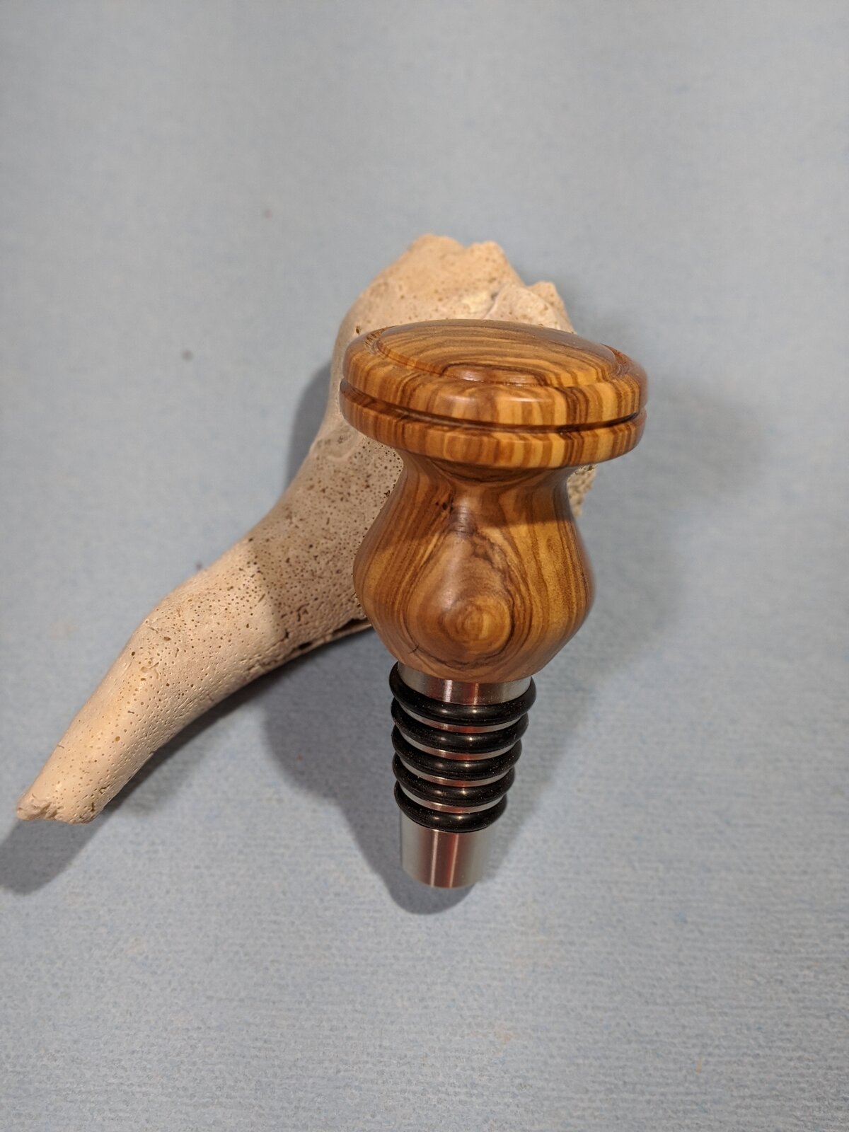

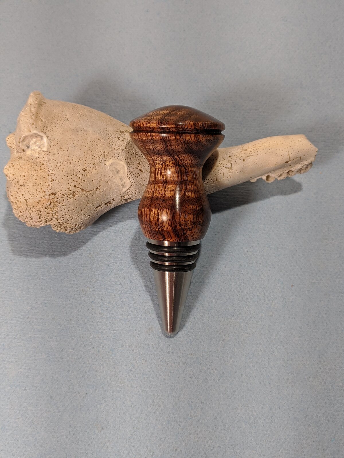

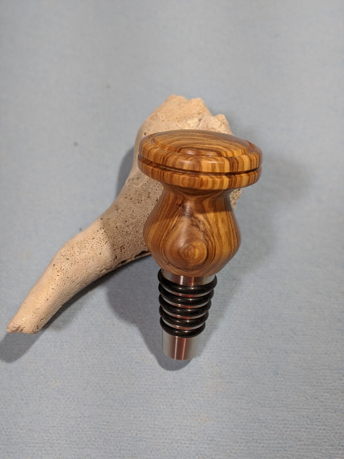

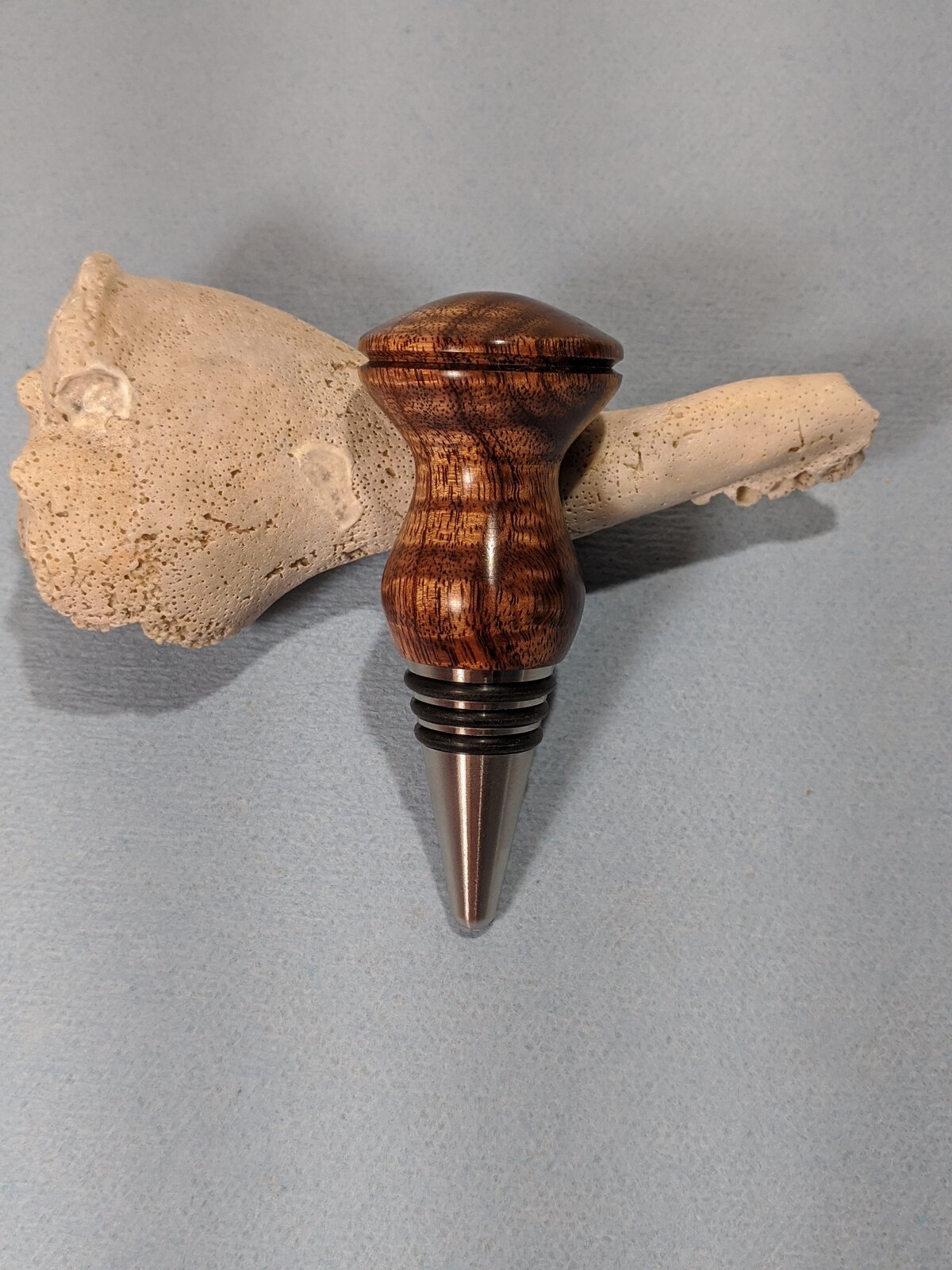

Hey Michael. I get all my stopper guts from Ruth Niles. I use her chuck and the brass inserts that work great. I don't sell a lot of them but I've gotten some good reviews on some that I have sold. Here's a picture of some that I've done. Submit your pictures to Ruth and she'll put them on her website. Also be sure to sign up for her news letter, she sometimes has discounts posted there. Good luck on your hunt. One suggestion, go with Stainless Steel.

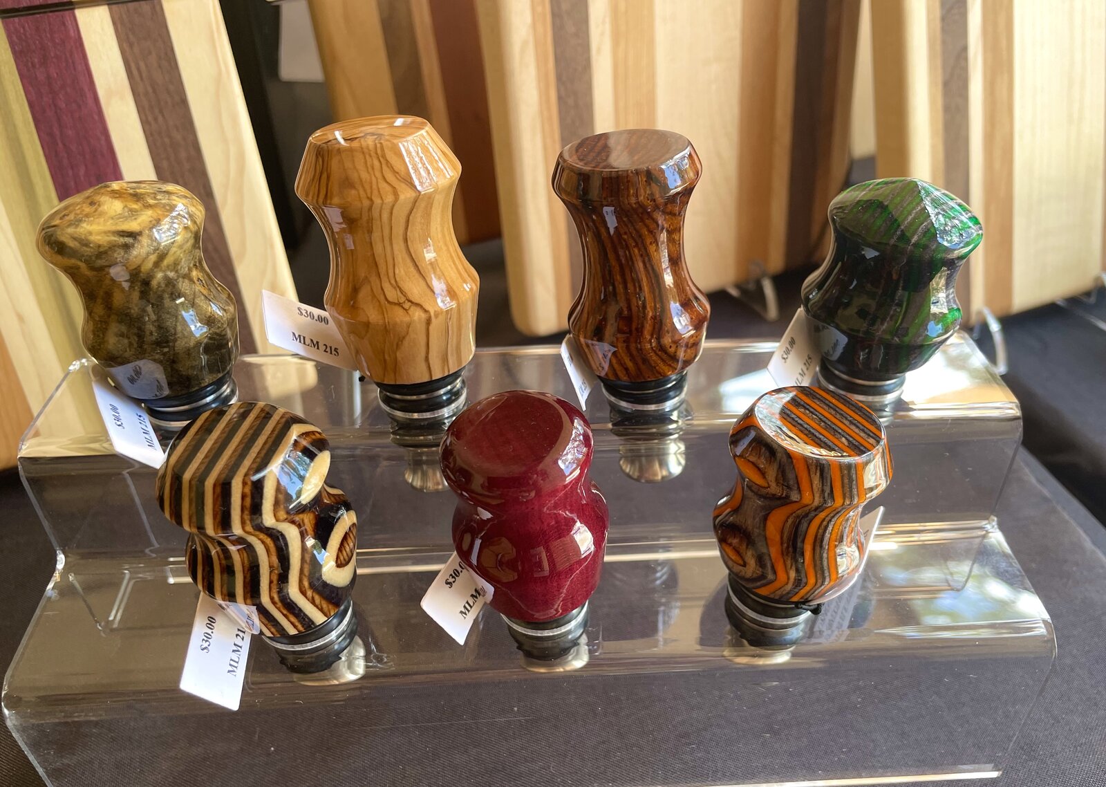

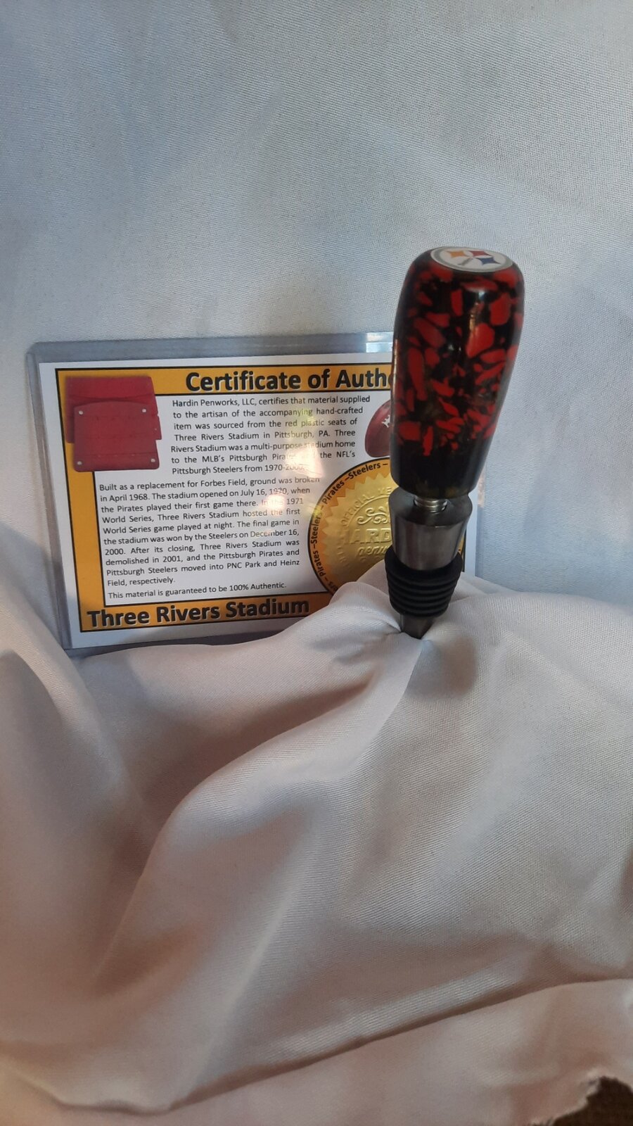

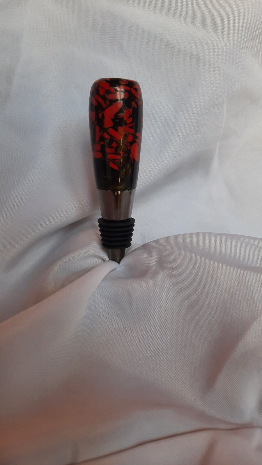

No quitting here
I have I guess 6 or 8 done for last week's show.

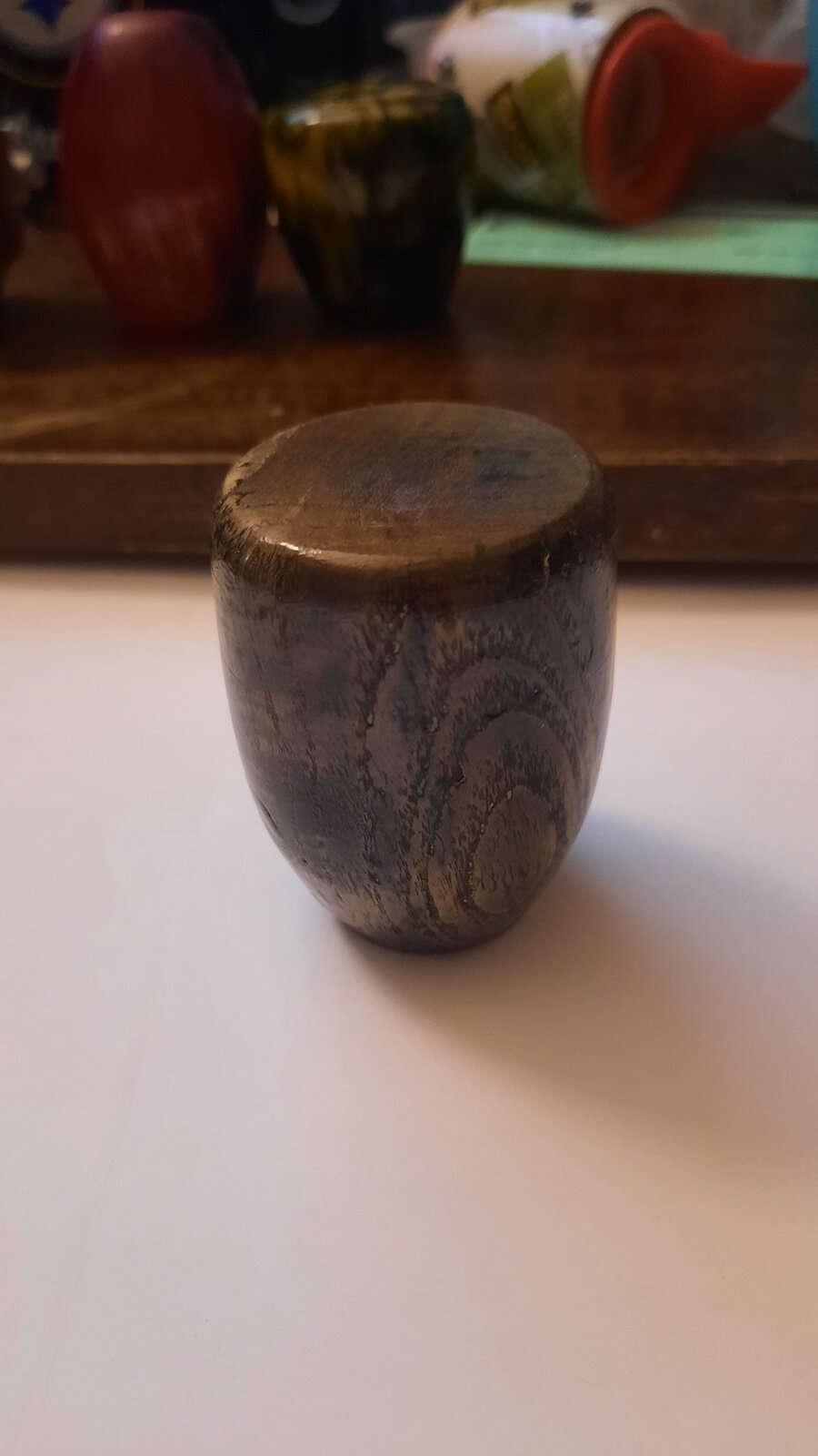

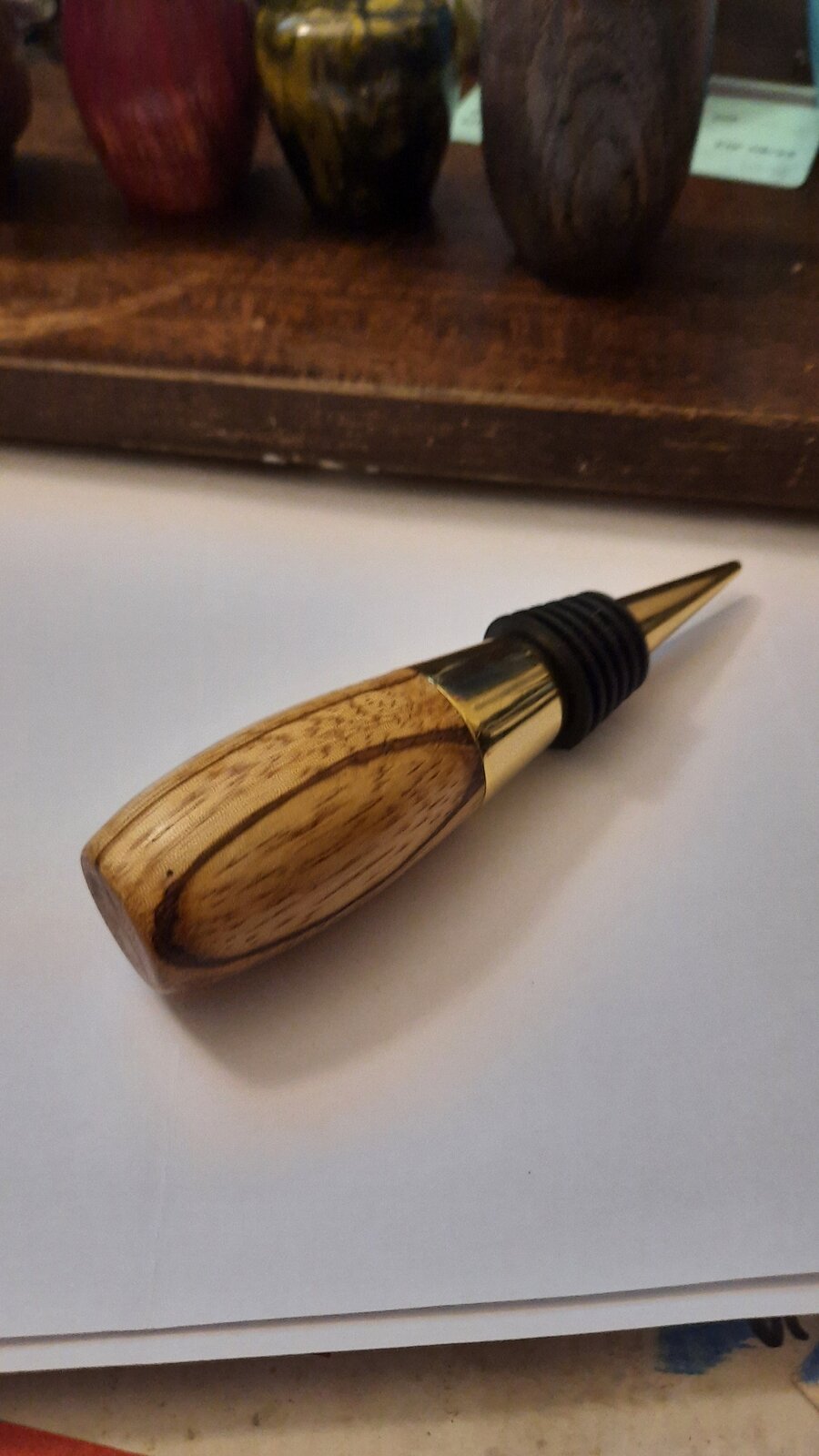

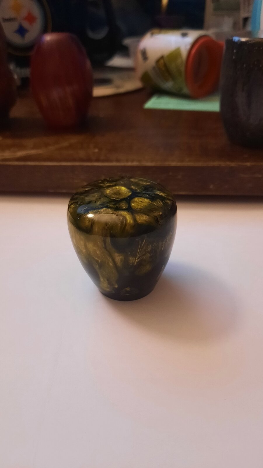

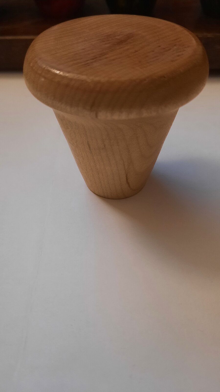

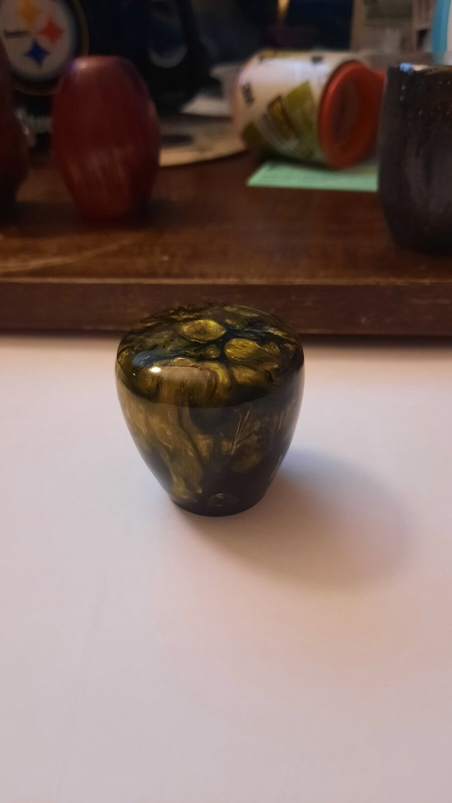

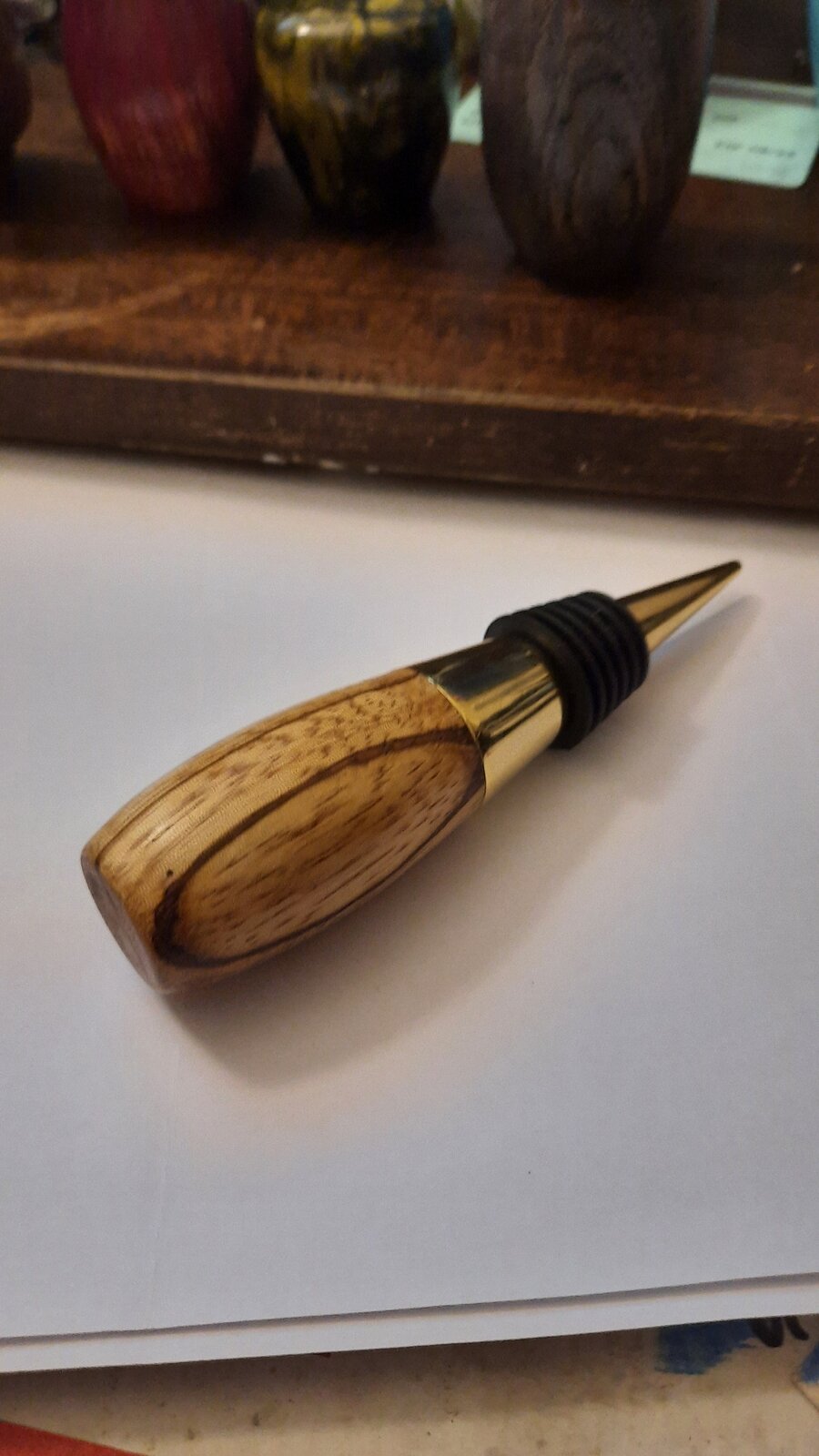

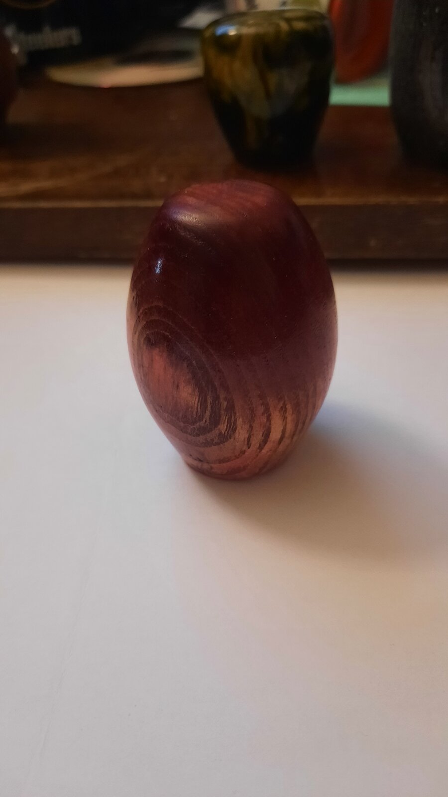

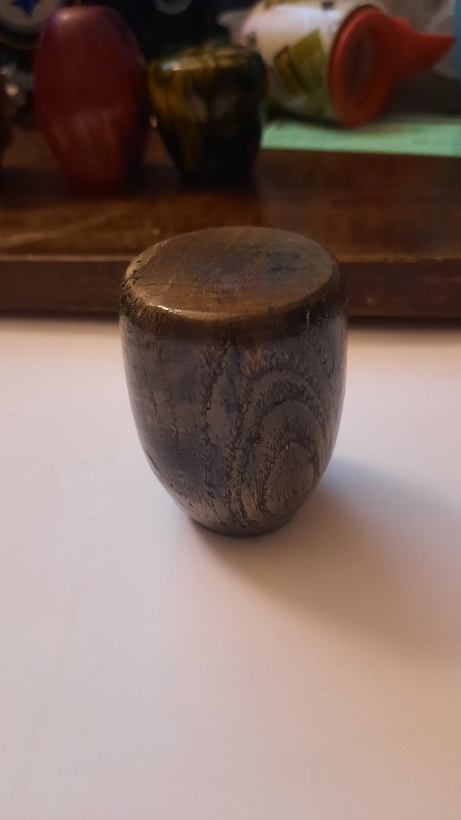

Here are a few I finished. The gold one is with Zebrawood. I am having an issue I think with some of my wood being so dry. Maple is awesome (a reclaimed headboard) Walnut and Ash. Love ash, and a pour of my own.
