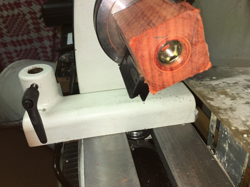

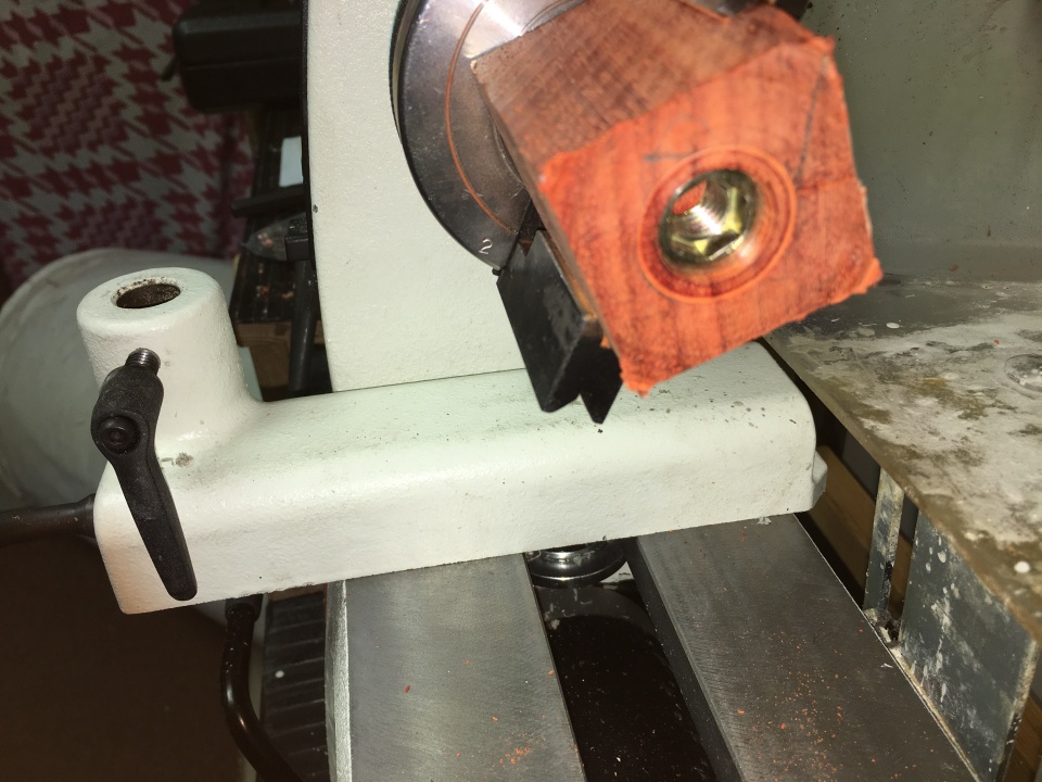

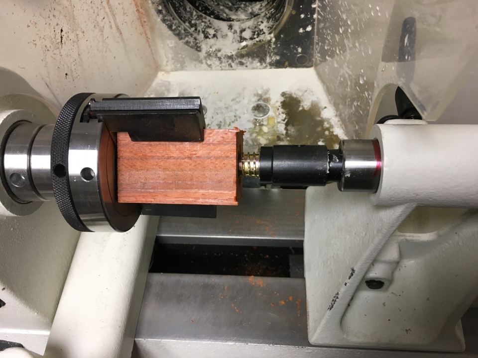

My first little hiccup. I'm
using the Niles kits & bits exclusively. Question to those using the insert technique. I used a 1/2" Forstner to drill
Into the base of the blank. I cannot get the insert to self thread. It will not take/grab. I'm
applying pressure but that's not working. What am
I doing wrong.
I don't use the Nilies hdw, but sometimes (esp with a soft wood) I can't cut threads or get a blank to grip my stopper mandrel tight enough. When that happens, I drill out a 1/2" or 3/4" hole about 1" deep and glue in a piece of dowel rod. Let it set, the. Start over - never a problem with the harder dowel plug & no one knows it's there.
Good tip. Thanks
Call me . P M sent.

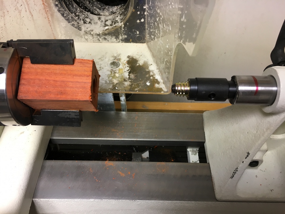

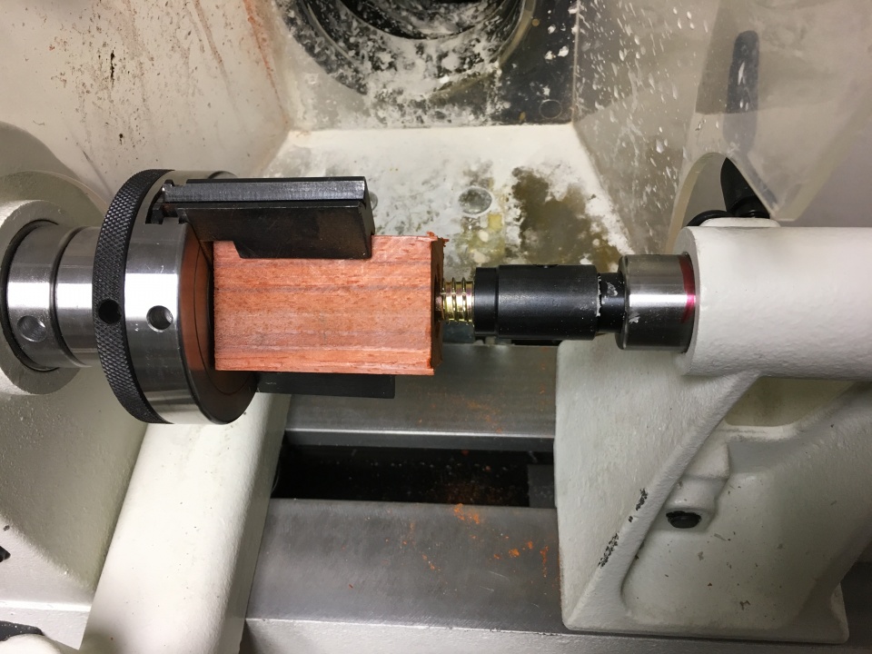

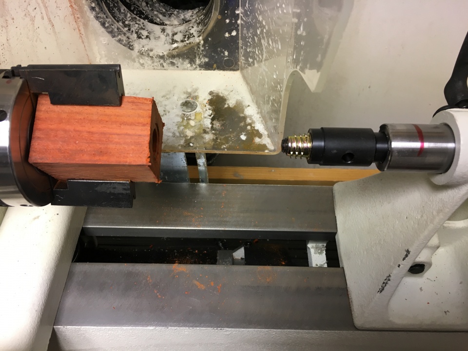

I got the insert inserted. The insert would not take thread using a hex wrench. Out of conversation I
screwed the brass insert onto the threaded mandrel and let the tail stock assist.
Also some power by "Armstrong". Turned headstock manually. I will
call Ruth for the best method.

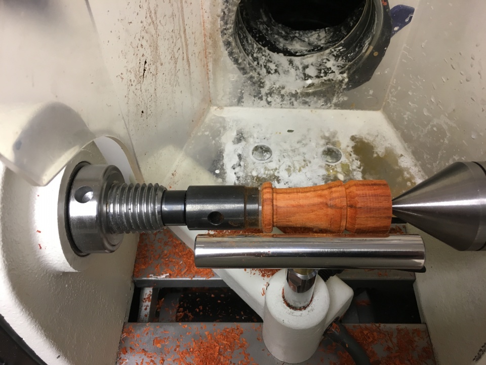

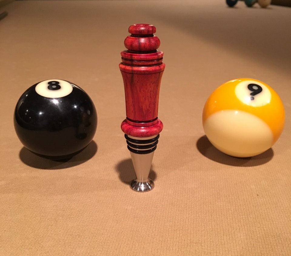

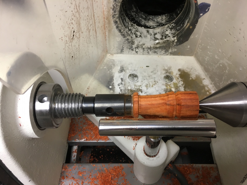

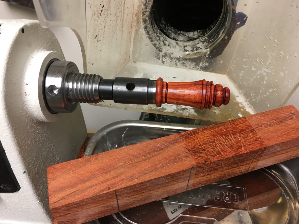

It started out as a hat but went south. I'll put on a few coats of Bulleye finish/sealer and move on. Bottle stoppers are a prelude(for me)to Pool
Cue joint protectors.

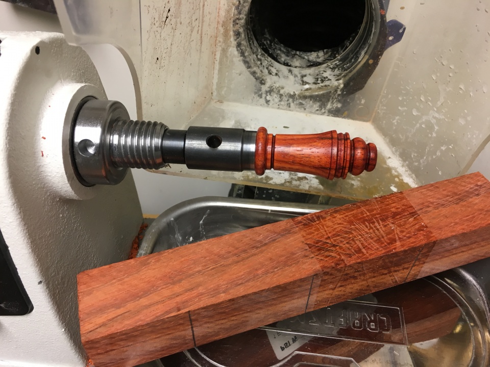

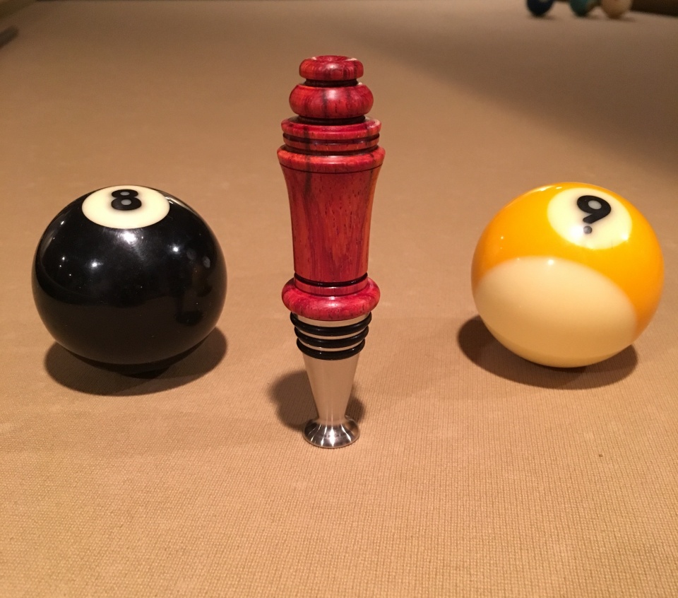

The detailed spindle work came out fantastic. I'm quite impressed with your creativity.
Thank you. That is my mind on chisels. :biggrin::biggrin:.

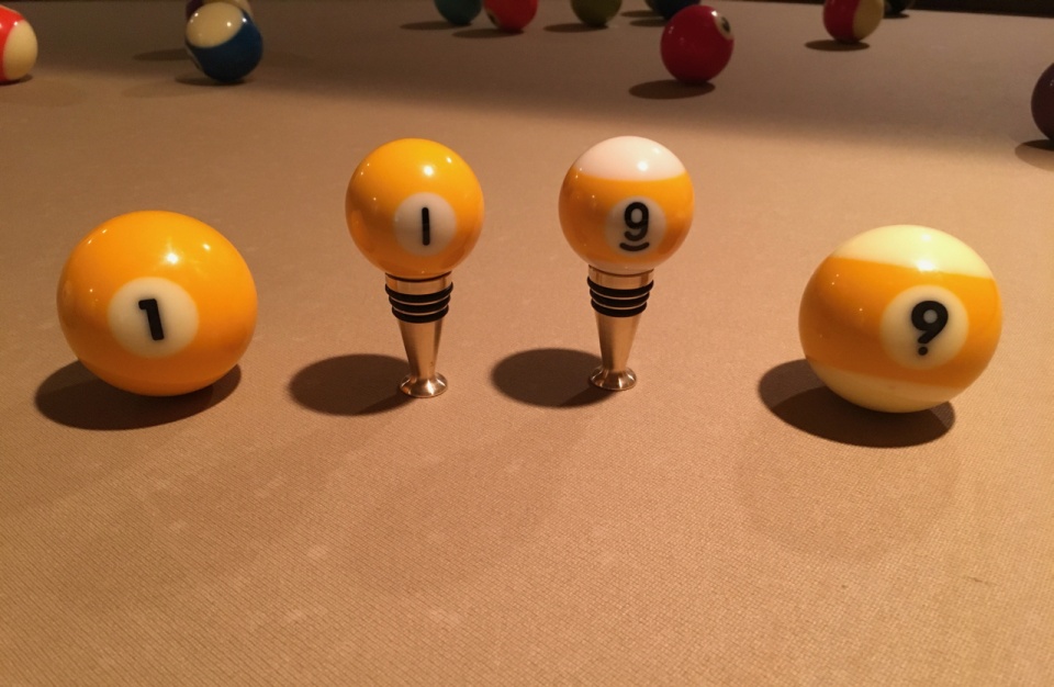

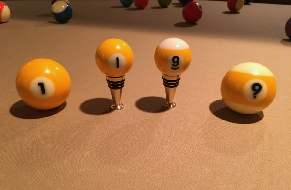

I'd like to hear what a good selling price would be for these. Kindly PM do not post here. These are Niles stoppers. And no...the mini balls are not Brunswick Centennials. Thank you.
