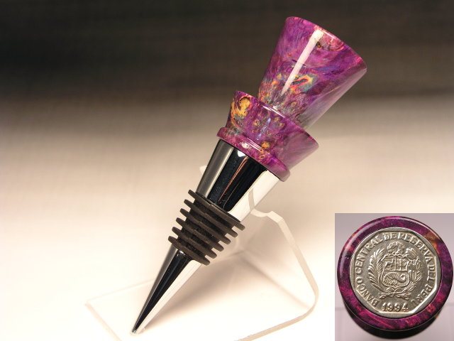

The same best finishes for pens are the same best finishes for bottle stoppers. Made 4 today and 2 got Mylands Friction Polish and 2 got the full CA finish. I like CA the best.
Edit to add...after thinking about it..the best finish for a bottle stopper is when you pull it from the bottle and pour a glass.
