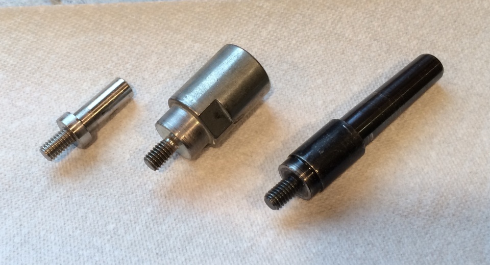

James.... I checked mine again and took a pic for you. As said before, it helps if you chose whose stoppers you want to use and then get the mandrel/s for that brand for starters. If they have multiple sizes, you would probably save on shipping by ordering all at once and getting two or three sizes in the same company. If you want to go the route of having mandrels for a couple of different brands/ diameters, go for it.
In the pic you will see one which has an interchangeable collar. That might be a good way to go but when I checked CSUSA website, it looks like you can only buy these as individual mandrels instead of one mandrel with different collars.
Another route is to get a 3/8x16 bolt from the hardware store, cut off the head and use this as your mandrel. You can drill and turn your own collars to any size you like with very little $$. This would work in a collet Chuck, a 4 jaw Chuck with pin (Not Pen) jaws or even a drill chuck.
I believe my screw on mandrel was from PSI.
the Woodcraft stoppers and mandrel take a smaller thread size as I recall.
Hope this helps.....bottom line...your choice.

/QUOTE]Should you recommend getting the three sizes? I'd rather get more sizes and be ready for things. Rather spending the day looking for a tool that I needed anyways.
Sent from my SM-G930V using Tapatalk
Hope this helps.....bottom line...your choice.[/QUOTE]Do you know what the thread sizes are on those? I know that Arizona silhouette. Has the most options. They have the niles. Also the berea woods mandrel that works on there's only (not super sure) they have a few more. But then they also sell 2 different size mini colors. .947 and .737.

To join the thread; James; A couple of random things.
Acrylic bottle stopper blanks should be threaded prior to mounting on the mandrel. It is easy to break the blank if not threaded to match the mandrel.
When using a MT taper mounted mandrel you will find a threaded hole in the base of the taper. This is for a drawbar to ensure the mandrel doesn't come loose during use.
I use a live center in the tail stock, but I cover the metal with a leg tip to prevent marring the top of the stopper.
Live centers come in a variety of configurations. Most lathes are supplied with a simple 60deg metal cone center., or sometimes a live center with a point surrounded with a ring.
A funny thing about turning is that you will eventually get GAS - gear acquisition syndrome - which means you never encounter a tool that you don't want to own. DAMHIKT One of the options is a live center that has a threaded stud on the end that faces toward the turning and headstock, and that often come with a variety of interchangeable 'noses' that screw onto that end. Mine has the same threading (1"x8tpi) as the headstock spindle on my lathe. And advantage of owning one of these is that you can make your own 'nose' from scraps of wood. I have made several that feature an HDPE insert that presses against the turning when it is being used. HDPE is very slippery, so the absence of friction means that it doesn't mar the turning.
I've decided to get the Niles Bottle stopper mandrel. Which one do you guys think is better? The tapered 2mt. It the screw on 1x8tpi?
Six of one, half-dozen of the other - - -
  • While there are a few large lathes that have a 3MT spindle (and some small lathes with a 1MT spindle, most lathes are 2MT. So opting for the MT version gives you the ability to upgrade lathes in the future without having to replace existing tooling.
  • However, when you use an MT bottle stopper mandrel, you really need to also use a drawbar so secure the mandrel in the headstock when you are finishing off the end of the stopper and must back away the tailstock. If you don't use a drawbar, it is possible for vibration to cause the MT fixing to work its way out of the female taper - that's dangerous. Commercial drawbars are hard to find, so you really have to make your own;fortunately, the parts don't cost a lot. Also, if you use MT accessories, you need to have a tool to clean out the taper in the headstock - if you don't keep the female taper clean, the male taper won't seat properly. That can cause a variety of problems.
So - if you don't need to plan for a future upgrade, and you don't mind dealing with a drawbar, the MT version might be a better choice. Conversely, if you want to avoid the drawbar, and you don't anticipate ever upgrading to a larger lathe, the threaded version would be better.
Incidentally - a drawbar is nothing more than a length of all-thread rod that screws into a hole in the small end of the male MT fixing, along with a knob/nut that screws onto the end of the drawbar to pull the MT fixing into the female taper in the headstock spindle. Note that the threading of the rod must match the threading of the hole in your MT fixing - they are commonly either 1/4x20 or 3/8x16. Also, while you can purchase tools (eg, CSUSA's 'green weenie') to clean the female taper, that's another instance where you can make your own for a lot less. Just pick up a brass shotgun barrel cleaning brush (20ga), and mount it in a handle that you turn from a scrap of wood.
Why not get the mandrel that you grip in the jaws of your headstock chuck ?
https://nilesbottlestoppers.com/product/2ss-155/
The difference in accuracy between it and the MT mandrel is negligible for bottlestoppers
If you don't already have a headstock chuck you can be sure you will need/want one eventually ... so now's the time ?
I do have a head stock chuck. (Nova comet II) I use it pretty much for drilling with pen jaws. I don't think I'll be upgrading to a lathe anytime soon. So the 1x8tpi chuck would work fine. The tapered one would work too I clean and maintain my lathe at least once a month. And they actually sell a draw bar on there site for like $5 bucks.
Personally I'd go with the 1x8 by a long shot. I've had far better luck with threaded stuff than I have with tapered stuff.
