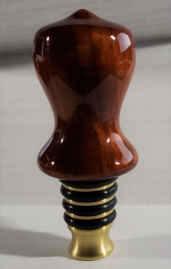

My mom like these things. I prefer to "countersink" them about 1/6 to an 1/8th.
CA Mercury Flex 2 coats thin and 5 medium, sanded and buffed (no MM). Used gas station bathroom shop towels to apply CA.
Thanks for looking.

Very nice Tony! I just ordered me a 5 bottle stopper kit the other day. Gonna try my luck with them. I like your countersunk idea also.
Thank you. It was Ruth Niles idea to countersink..I don't want to appropriate her creativity. I use a 7/8th Forstner (sp?) bit, then I drill the hole.

Beautiful Tony!! My first several stoppers were Ruth Niles based on some reading. They seemed a bit expensive, but had an excellent reputation. Then, somebody threw a few plated stoppers in with a wood purchase--i really saw the difference in quality and the price difference suddenly didn't seem so big. Stainless and heavy. I really like her bottle openers as well, and they make a nice set.
I also recess almost all of mine, makes for a classy look. A 7/8" Forstner is perfect, and then there is an automatic starter location for the tap bit.

That's a wonderful bottle stopper Tony!! I like your design and of course, your CA finish is impeccable .
What was the wood you used?
Thank you all. I don't remember the name. It was like a open grain, burnt orange, medium brown color. Rockler had a bunch of assorted 8" x 2" X 2" wood blocks. I bought a bunch and cut them up for BS's. None were more than 4.99 a stick.

I find it easier to get a very good finish with larger objects (like BSs). I don't know why.
