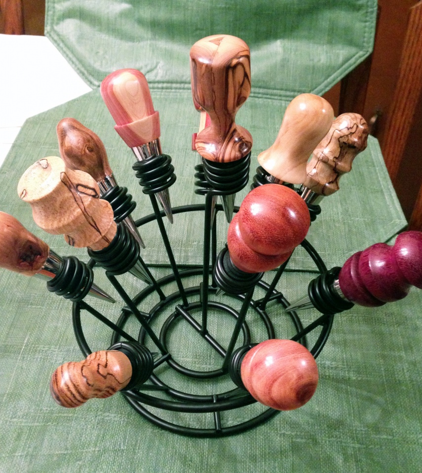

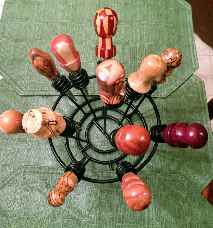

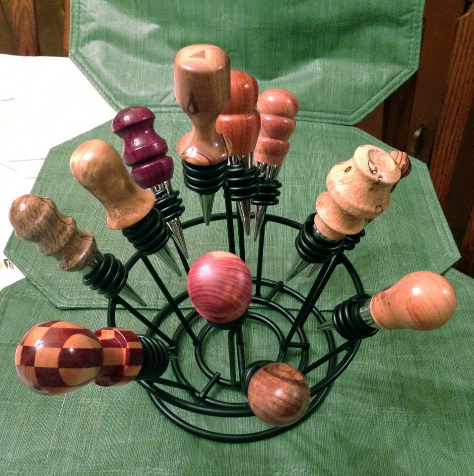

I made this set of SS bottle stoppers for our church's Oktoberfest auction on Oct 4. The stoppers are made from Bethlehem Olivewood, Black Cherry, Cedar, Cottonwood, Hormingo Negro (Macacauba), Huisache, Laminated Maple & Padauk, Mesquite, Spalted Pecan, Purpleheart, Spalted Sycamore and Zebrawood.
I didn't have a BOW stopper blank so I made one by gluing two pen blanks together then cut them in half & gluing the two halves together.
I got the stand from Amazon for just under $12.
