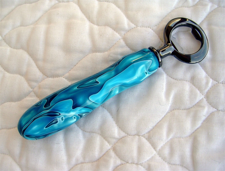

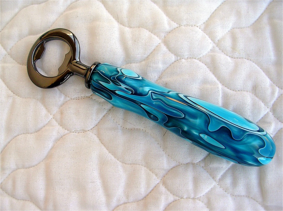

I tried one of the bottle opener kits. It came out okay.

I think it looks nice as well. Do you just turn the handle between centers?

Michael,
I was supplied with a 1-1/2 square by 6 inch blank for this commission job.
I trimmed the blank to 5 inches long and 1-1/4 square before starting. The plans called for drilling a 3/8 hole a specific depth so the 3/8-16 threaded opener could be epoxied into the finished handle. I went a different route.
Since the threads were cast they were a poor fit into a threaded hole. I ran a die over them to make them crisp.
I mounted the blank into a scroll chuck and drilled a hole with a 5/16 bit ( the tap drill ) I did a small counterbore with a 3/8 drill to assure I had clearance for the portion the die did not cleanup.
With the lathe powered OFF, I hand tapped the hole using soapy water and a spiral end machine tap. It took a bit of stopping and starting to clear chips and avoid a broken tap.
I checked to see the hardware would seat all the way.
I removed the blank and CA glued a short pen blank scrap to the other end. I mounted it back into the scroll chock and center drilled into the scrap.
I turned the blank between a 60 degree dead center and 60 degree live center. I only had a very small area to clean up by hand after sanding before parting off.
