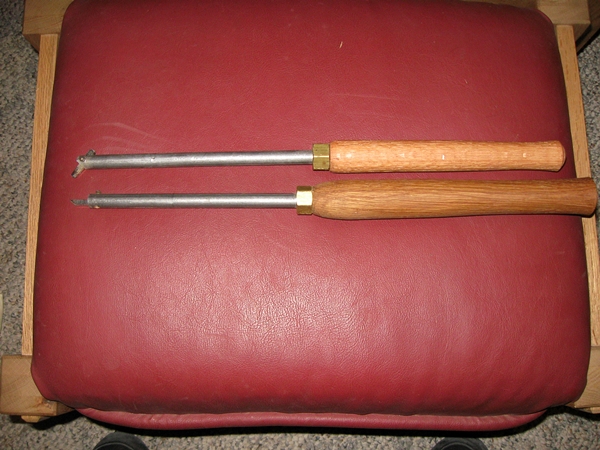

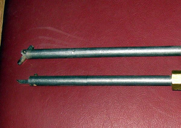

I like to turn thing in addition to pens, like boxes and bowls. I read an article on making boring tools and with some additional answers to questions I asked on Sawmill Creek I decided to give it a try. These tools really work great and hog out the wood. I have less than $20 invested and enough material left over to make a couple more with curved shanks. The shanks are 1/2" steel and the bits are 3/16" HS tool bits. The bits are easily to grind to any profile you like and easy to sharpen. I find that I also use them in spindle work.

They are simple to make. I ordered the bits from monster tools. Bought the still rod and screws from Lowe's.
Great looking tools and I have a bit of additional advice to make them better to avoid snags on the set screws.
My first set of tools was the same design, but since then, I was informed of 3/16" diameter tool steel. The same idea except the tool steel is silver soldered into the ends. I'm not sure where it can be purchased in the USA, but I know it is available in different diameters.
