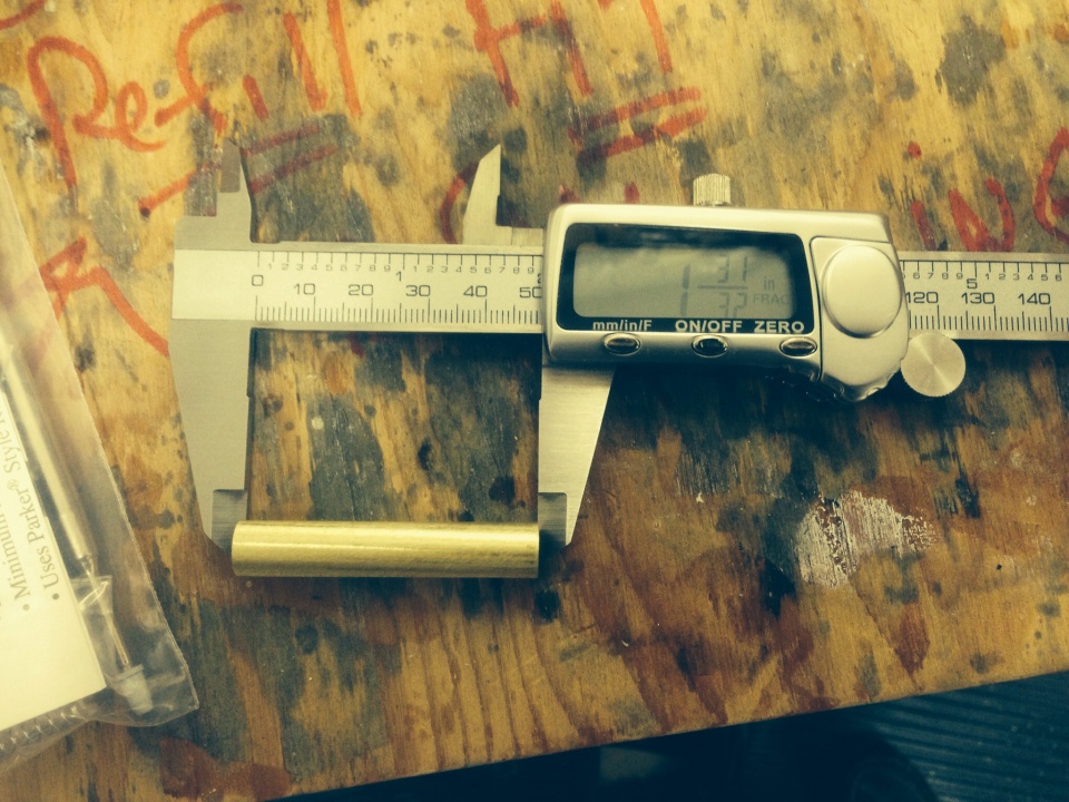

If you are careful with the tube and length you should not have a problem. I have made several bolt action pens and not had any trouble with them yet. On others where I have made mistakes and ended up with a 7 mm transmission too deep or shortened a tube/barrel then I have had trouble.
