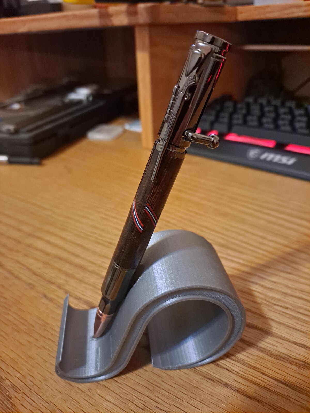

I like the bolt action mechanism, but I really wish there was more variety to the body styles that use it.
Pheasantwood with red, white, and blue veneer stripes. Leftover blank from a different pen I made for my girlfriend. This is the fourth blank used on this kit because the first two were crappy pieces of black palm and the third was a poorly assembled (didn't really expect it to work) segmented piece.

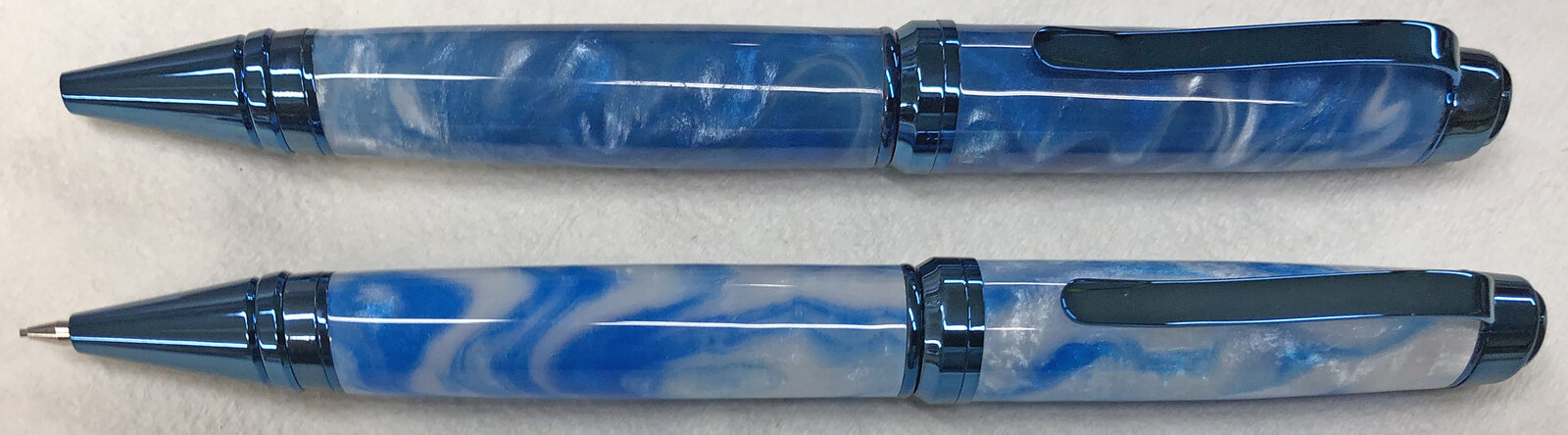

I have converted several non-click pen styles to pencils by simply replacing the Parker refill with a Schmidt DSM 2006 Pencil Mechanism (0.7mm) with satisfactory results; however, I have never tried one on a Bolt Action style.
Considering how it works on a twist style like the Cigar, I would assume that it should work with a Bolt Action type transmission. Extend the bolt to extend the lead and retract the bolt to grip the lead for writing.
For only $3.00 it might be worth a try. You can get the 2006 model (plastic) on Exotic Blanks. I think Ed also carries the Schmidt DSM 2007 (metal) version for just a little more, but the last time I checked they were out of stock.
Regards,
Dave
PS On the Cigar conversions I made (picture of set below), I also swapped out the Double-Action twist transmission with a Single-Action transmission. Although the Double-Action will work, it is not as intuitive for use with the Schmidt pencil converter. (Ed over at Exotic Blanks sells the Single-Action Cigar Transmissions also - they come in a 5-pack for $4.95).
