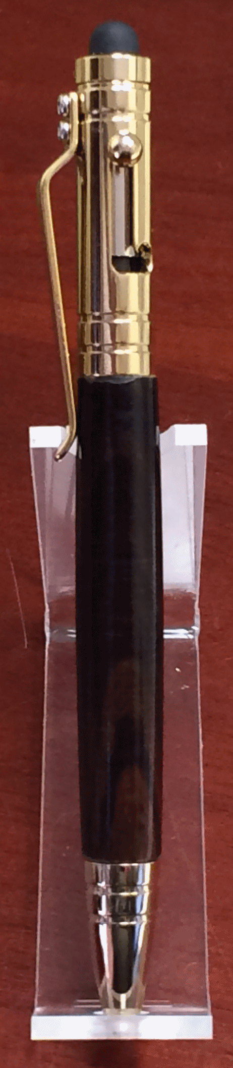

This is a PSI Bolt Action Tec pen which I made for my son.
View in Gallery
The pen kit is the 24KT Gold with an Arizona Desert Ironwood blank that was cut on a bias. The blank is finished with CA.
One a bad note, the barrel is a little bit too long and as a result the refill tip does not extend past the end of the nib. I will be disassembling the pen and trimming the ends of the barrel to correct the problem.

I got off a little early today, and when I got home I went to the shop and got out my transfer punches, my pen vise grips and my stubby hammer. It took longer to dig everything out than it did to disassemble the pen. Now I just have to shorten the tube to the correct length and put everything back together.

Spectacular Pen, Elwin.
I am sure your Son will Treasure It.
At the Top of the Blank, at the Bolt Mechanism Join, there is something at the joint line, is it a Chip, or just a piece of Fluff?
It is hard to tell, as the photograph could do with a Tad less Contrast.
Congratulations, on an Excellent Recovery.

There is a chip at the top end of the blank, however, when I shorten the barrel it will go away.
Hi Elwin..when you shortened the barrel, did the point retract all the way into the nib (or whatever the part that covers the point is called)? I have not always had success with that. I hope you do/did.

You know where the clip screws on ? ... put a dot of epoxy under that part of the clip.
I don't like wiggly clips.
Nice pen ... gotta love Desert Ironwood !!!!
