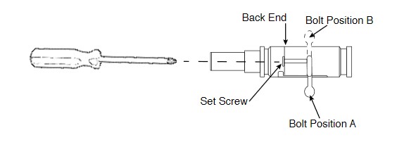

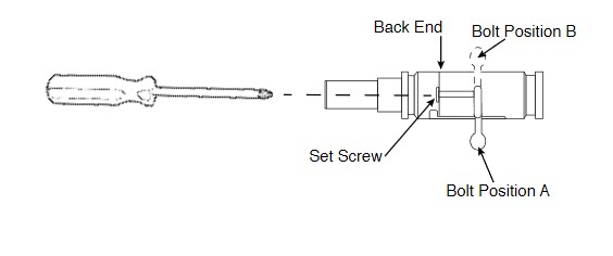

The back cap threads right off ...
After this, you can reach the bolt screw from the back end, unscrew it so that you can remove the bolt by unscrewing it.
Finally, with the bolt removed, the slide can also be removed or re-positioned for left or right hand operation of the bolt action pen. (they made it this way intentionally for exactly this purpose)

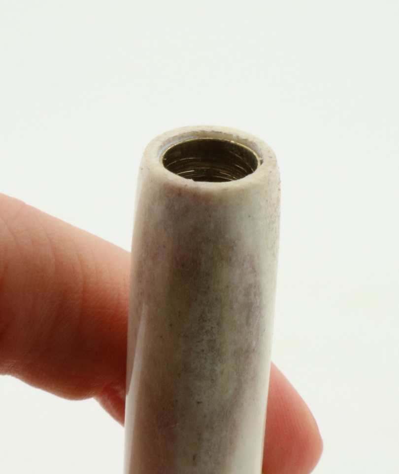

I removed the cap. when i look inside i dot not see any screw. the screw is on the other end. I can not reach it when the pen is assembled
maybe i am not using the same kits that you have.

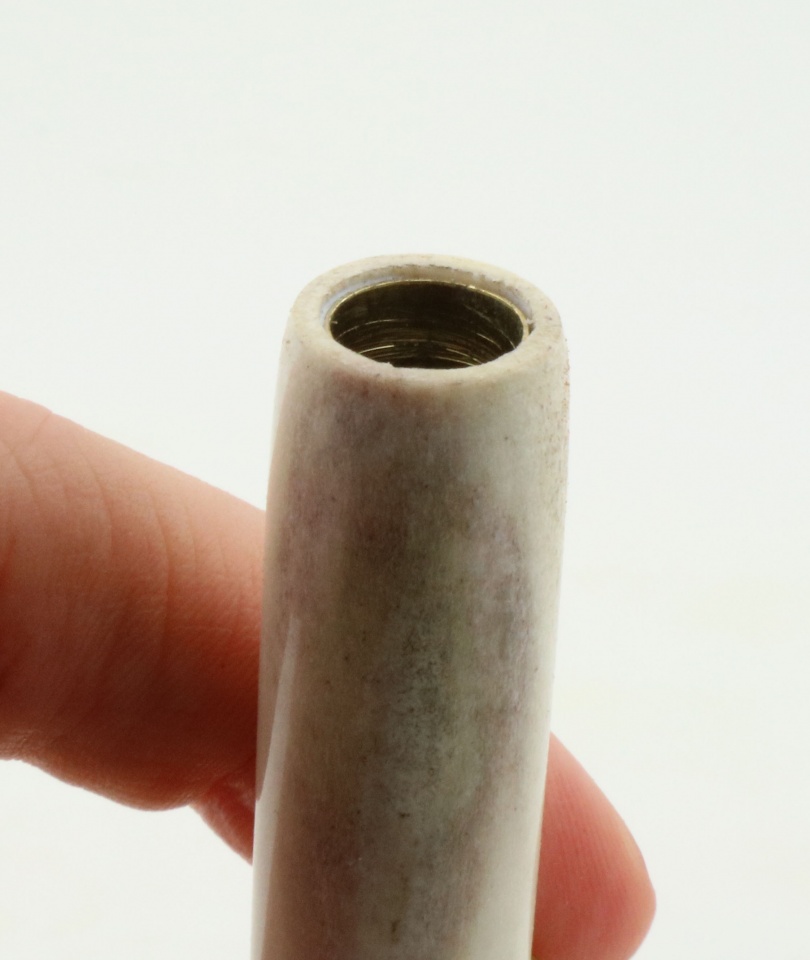

found my problem, i disassembled the pen. it needs more trimming
