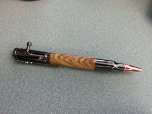

3. PSI website description: This completely original and irresistibly fun Bolt Action pen will be hard for any hunting or target-shooting enthusiast to put down. Every detail, from the one of a kind bolt action mechanism to the precision engineered components, was carefully designed to ensure uniqueness and reliability. The realistic bolt-action handle smoothly advances and retracts to securely lock the refill in place. Includes a bolt action rifle clip and a replica 30 caliber cartridge and rose gold bullet tip for added authenticity. That description pretty well captures the pen itself. If I were to use my own words I would say it's a unique pen with a bolt action click mechanism. The front of the pen resembles the front end of a .30 caliber bullet and the back of the pen resembles the rear end of a .30 caliber cartridge.
4. The assembly instructions are straightforward and easy to follow. Assembly was simple with no complications. You will need a 3/8" drill and either a set of bushings or a micrometer with the pen kit instructions near by. I used a pen press, which I believe made it easier due to the length of the fully assembled pen. You can change the position of the bolt. To do so you use a Phillips head screw driver to loosen a retaining screw inside the back-end. They say this is for converting the bolt from a right-handed user to a left-handed user. This really seems to convert the bolt from what shooters have called a backwards-functioning bolt to a normal functioning bolt. Of note (it does actually have a note on this in the instructions) it is important to double check that retaining screw for tightness, otherwise the bolt can become loose and spin around freely. It is possible to tighten after assembly but a long skinny Phillips head is required then.
5. Photographs attached
6. The fit and finish of the kit are good. Of the many kits I have purchased and put together there have been no defects or blemishes. The kit calls for a minimum blank size of 5/8 by 2 ¼ inches the brass tube itself is 1 31/32 inches. There is a slight difference in the regular and magnum kits. The regular has the front end pressed into the kit while the magnum has a threaded ring pressed into the kit. This makes it so the regular gets an ink refill by unscrewing the bullet itself and the magnum unscrews the front cartridge.

Interesting, all the bolt actions were mounted upsidedown
