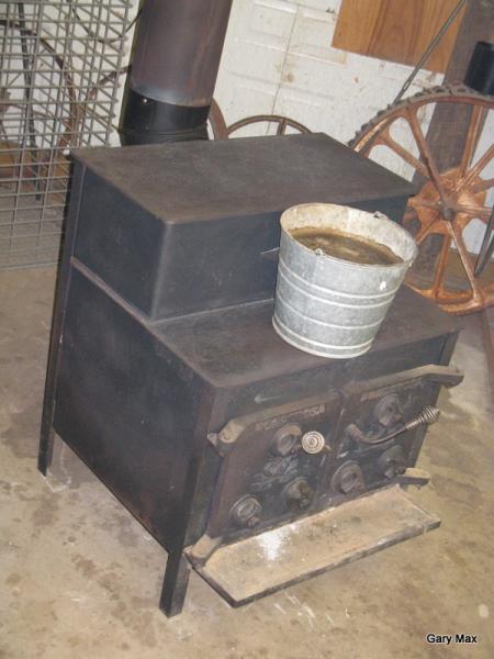

Fired up the wood stove today----first time this year.
I have some Hickory Burl that was sealed in Anchorseal a couple of months ago that I am wanting to dry.
Here's the easy way to dry blanks I know of.
2 1/2 gallon bucket of water and a hot stove---I just leave it sit and brew all day long.
Tonight they will be placed on a drying rack to dry.
I just sit the bucket on the stove when I build a fire and forget about it.
They come to a full boil in about a hour.
I do remove the blanks from the water while it is hot. Just pick the whole thing up and toss it in the drive then pick up the blanks.
This also removes the Anchorseal.
Drying roughed out bowl blanks is how I got started doing this to pen blanks.
I have a 20 gallon Stainless steel tank for bowl blanks.
There is a soap mixture used to soak green wood in to keep it from cracking too. I can't remember the exact amounts though. I have it written down somewhere.:redface:
For the folks that have asked----there is no presale for these blanks.
They will take a couple of weeks to air dry.
The are on the drying rack now and are looking great.
