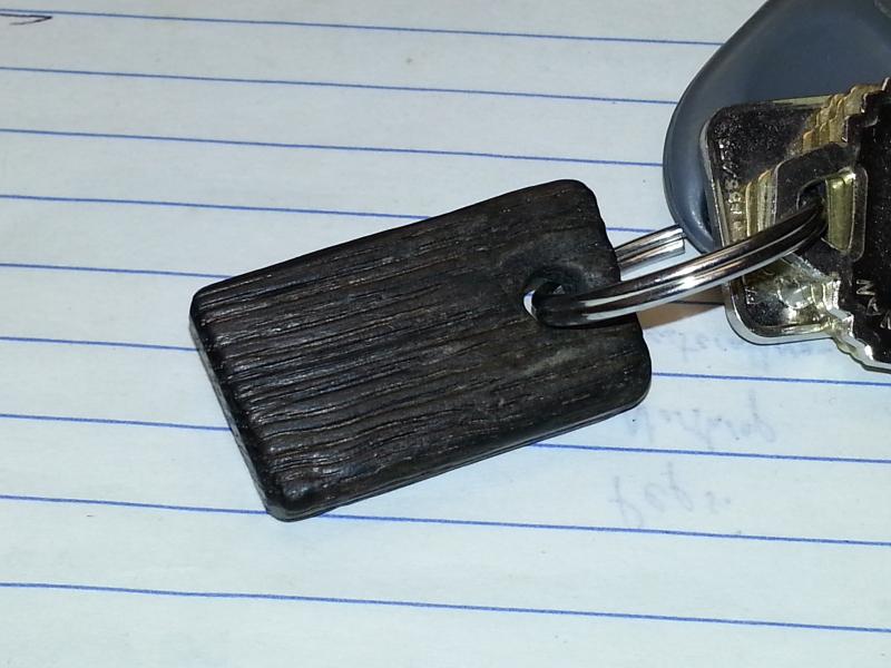

here is an unprotected keychain I made several years ago.
It will hold up fine without any sealant/finish.
The most I use on my pens is a lacquer.
