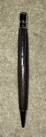

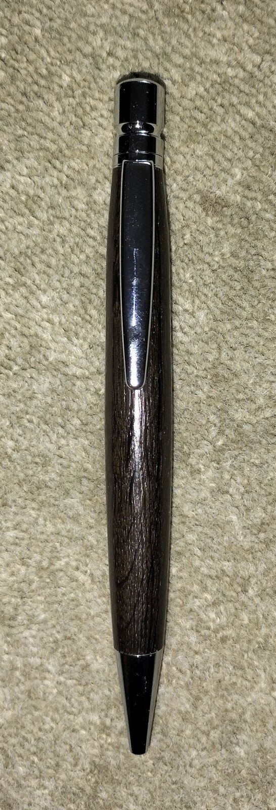

Recently purchased 5 Bog Oak Pen blanks and quite excited to turn them. They turned and finished well. Very open grain surface and interesting colours from grey to black. And at least 5000 years old. I think a Matt finish would be more suitable.
Please feel free to comment

I've started putting a matte or low gloss finish on bog oak. It looks good when you can see the open grain, in my opinion anyway. The diagonal medullary rays look nice in this one. I had one that turned out similarly, and hope for more as I bought 10 blanks of it last time around.

Yes this is my first attempt and showing off the open grain seems an excellent idea I may try Lime Wax.
Thanks for your reply.

I just had some pens plus arrive today. Have not tried it yet, but a couple light coats of thin CA has worked well for me, just burnishing with a scrap of t-shirt instead of sanding/polishing.

This one was finished in what I consider my standard that is Sand to 600 then sanding sealer followed by Friction. Polish and Microcrystaline wax.
I no longer.use CA.
I think I will experiment in producing a Matt finish.
Thanks again for your comments.

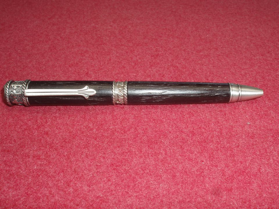

I turned some bog oak pens and learned the same thing - CA is not a good finish for them. A CA finish turns the bog oak black and takes out all the interesting details.
I still have some Hut Crystal Coat on hand. While I do not recommend Hut Crystal Coat in general, a friction polish like that makes a better finish for the bog oak pens than the CA I had tried before.

Thank you for your suggestions. I never use CA having spent many hours working with it and sticky fingers. I can get a good finish using the method mentioned previously.

That's a great looking Pen and I like the finish. What Pen kit have you used.

Thank you. It is a "Faith, Hope, Love" pen kit. I bought it at the local Rockler store, but it is also available from Penn State. Sorry, but I I do not know a local source in the UK.

You can get a soft matt finish with ca by going through then micromesh and the dropping back 3-4 pads and it will take the gloss down
... and I like and use that same technique for a matte CA finish myself.
The problem with those bog oak blanks (and sometimes other very dark woods) is that they darken to black and lose a lot of "character" with a CA finish - matte or otherwise.

I made more than a 1000+ pens from Bog Oak and found out that the best finish is a food-grade walnut oil. Give it plenty of time to soak in, buff it with steel wool, clean the residue and that's all. If you want a little more shine, the white diamond polish will do the trick without killing the texture.
I have one BO pen cracked finished this way - it was laying under a spotlight in a jewelry shop all winter. That's not a fault of wood:)
