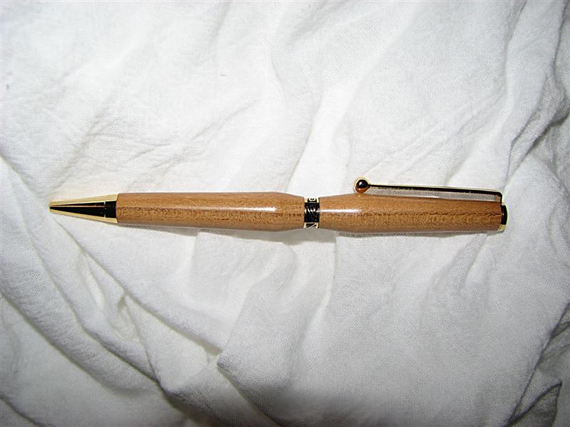

I found out that I got this half sister way back in 1980 and that's a good story all on its own since mom & dad had been married over 30 years at the time. But any who, Cheri had been adopted out at birth and none of the rest of the family new about her. Any who she turned out to be a horse trainer in Texas and found us in Colorado just before Christmas 1980. When she came up to see us she brought me a chunk of wood that she called Bodock Iron Wood. And said that it had been the center post in the coral to tie the horse to. This one had been broken after many years of use so she gave it to me. Its very heavy and has a shaggy bark like scrub cedar does. When fresh cut its a bright yellow but soon turns a reddish brown. At least it did almost 30 years ago.
I have managed to cut a few blocks off of the chunk and they are a reddish brown with a close tight grain and very very hard to cut. I managed to turn a pen from it and here's a picture of it. Its been kept in a case since I made it last spring but I have just got a buyer for it. I need to find some more info on the Bodock wood but haven't had much luck. I like to make a little card for my pens telling about the wood that its made from. It seems to help make some of the sales that other wise wouldn't happen. So any who, do any of you know anything about this wood that you could help me with? All I know for sure is its very hard and very hard on cutting tools.
I also still have a few blanks and a couple bigger pieces of it if any one wants to buy some.

Dan, as usual on the subject of wood, Dario is right. Osage Orange has many names as a quick Google will show. Bodark is the name you meant to use in your title. It is famous as a wood for long bows.

The wood works nicely when it is somewhat green or fresh cut. After it has dried, it will destroy your tools.

More like "bow of the arc". Dried it will not destroy your tools. I turn quite a bit of OO. Granted, it is hard and tools need sharpening a bit more than with most other woods but "destroy"?, no. OO contains silica and that is what dulls the tools. There are stories about OO making sparks when cut with a chain saw. That is from hitting rocks.

Hey Frank, maybe destroy was a little strong but it is awful hard on sharp tools. I love to work with it and have quite a bit in my shop. And it is wood of the bow...Bois is French for wood and d'Arc is the bow. The Osage Indians were famous archers and made all their bows from the Bois d'Arc. That is why it is sometimes call Osage Orange and when the French found them using the wood for bows they gave it the French name.

Osage is one of my favorite woods to turn, by far. When I hone the skew on the leather stropping wheel, I can peel Osage off in 15-ft ribbons shooting over my shoulder--- even with the wood bone dry.
Just use caution when making an El Grande out of it--- it gets pretty squirrely on that reallllly thin upper tube. DAMHIKT

Another thing, that's a real nice shape you have on that pen there - it's not the same old same old hourglass shape that so many of us (myself included) do.
Thank you for the compliment. I'm not so sure that it is the wood Bodark or Osage Orange. I've been trying for the last several days to contact my sister about it and I haven't had any luck in talking to her yet.

Oh, one more thing, I just sold it the other day, for $40. Not bad for just a Slim Line.[;-Þ
I have turned several pens from bodock and have had a lot of trouble with it splitting. Can anyone give me some advice? Has anyone had similar problems?
