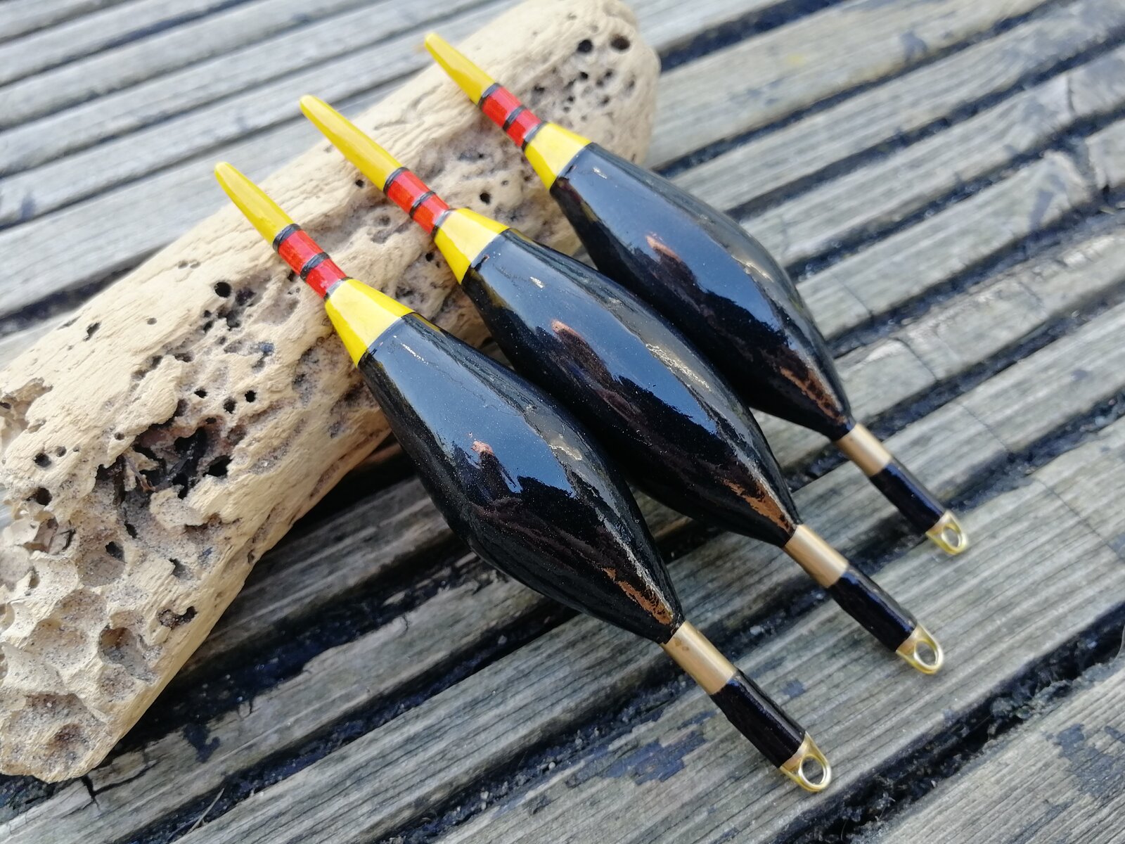

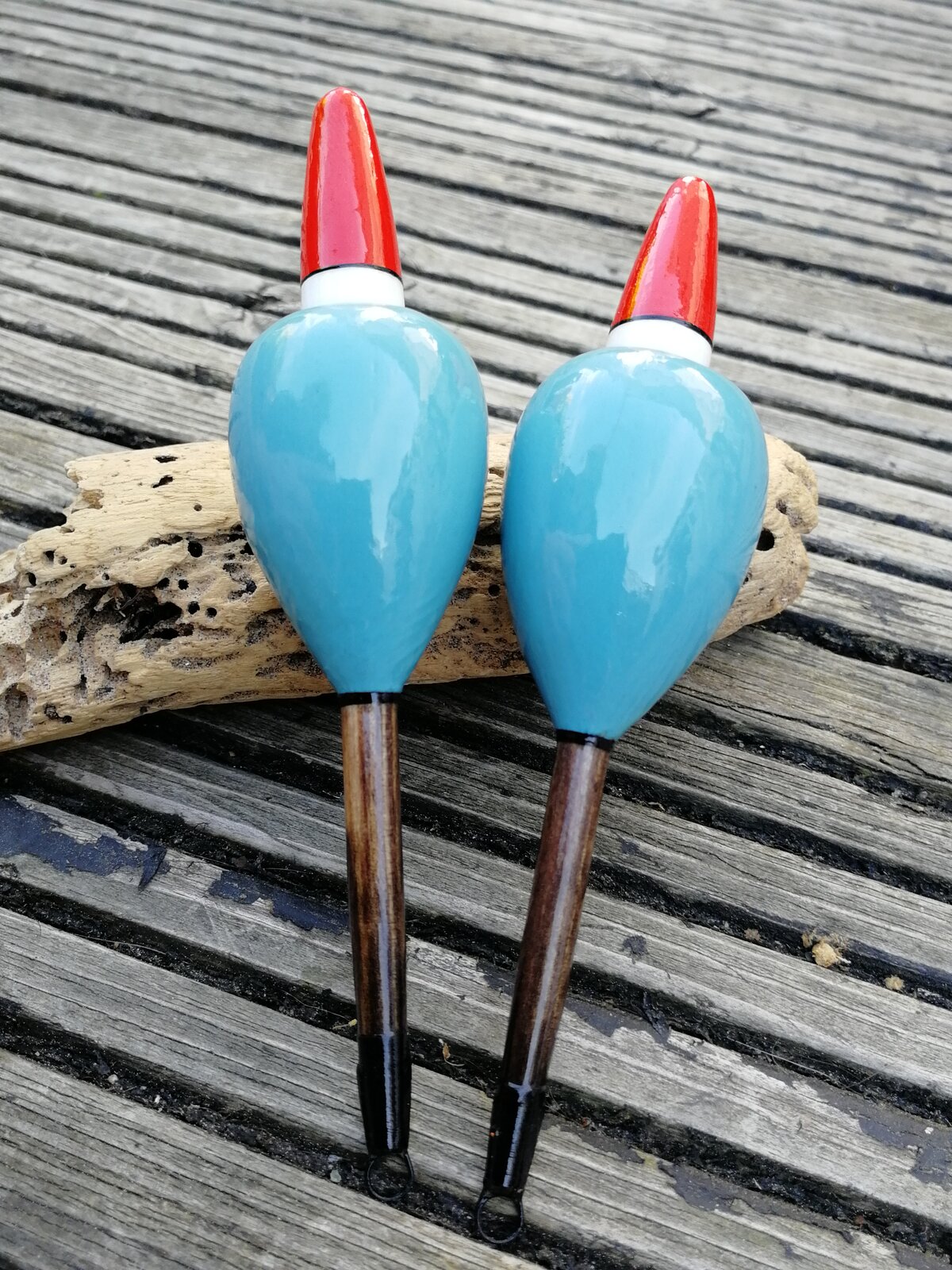

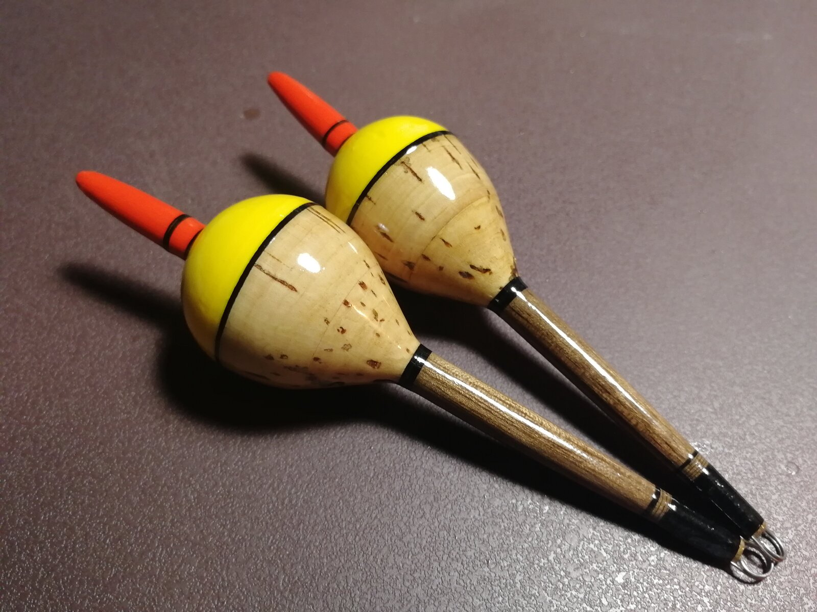

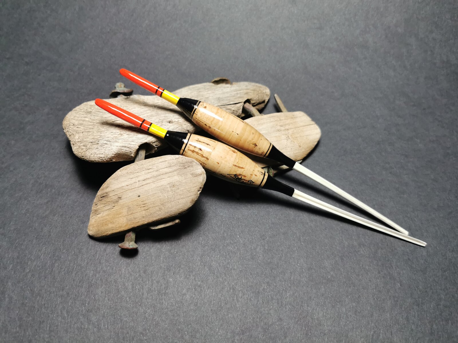

This is my 'other thing'!
Balsa or Cork is the material to use.
Any paint can be used,,,, acrylic, emulsion,,, anything. I used a waterborne flooring lacquer but polyurethane varnish is another one.

Those look beautiful!

Yeah, sorry. I buy balsa in bulk from a UK hobby supplier.

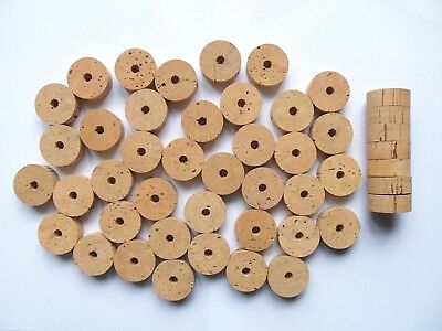

Cork, ebay. It all comes from Portugal anyway so you should be able to get it no problem.
I buy 1/2" x 1 1/4" Flor Grade Cork rings and laminate them using polyurethane glue, that way you can build up to the length you need then cut down to size.
Look at this on eBay

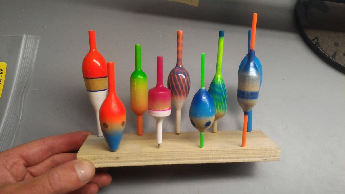

I've made quite a few bobbers, all slip bobber style. Some weighted, some not. I use basswood for all of mine.
These are awesome! So, do you drill all the way through for these? I mean, you have to, right? On some of the smaller in diameter ones, are they wood, or do you use something else like coffee stirrers or something?

I drill all the way through with an extra long #30 drill bit, then insert a 1/8" plastic tube, and add a bunch of thin CA at either end to hold it in place. The tube that I use I usually pick up at RC/hobby shops for use as antenna tubes, but I've used styrene tube too. Coffee straws may be another idea I hadn't thought about!
