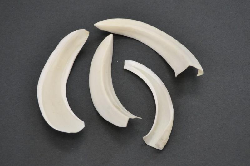

might be able to use it as inlay....they are hollow
here are some cut and cleaned

OK that awnsers that question. I had no idea they were that thin. On the bright side, I don't have to worry about ruining an expensive tusk. Thank for the help everyone!
