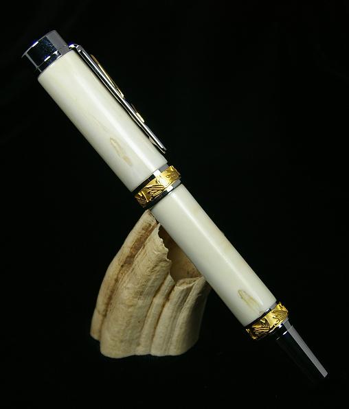

Haven't turned it but it is widely available and good quality. It's fairly limited to pens or a novelty though as it's not very big in diameter. Stress fractures can also be an issue. Here would be a good place to start........you can convince him a farm is a nice place to live!
