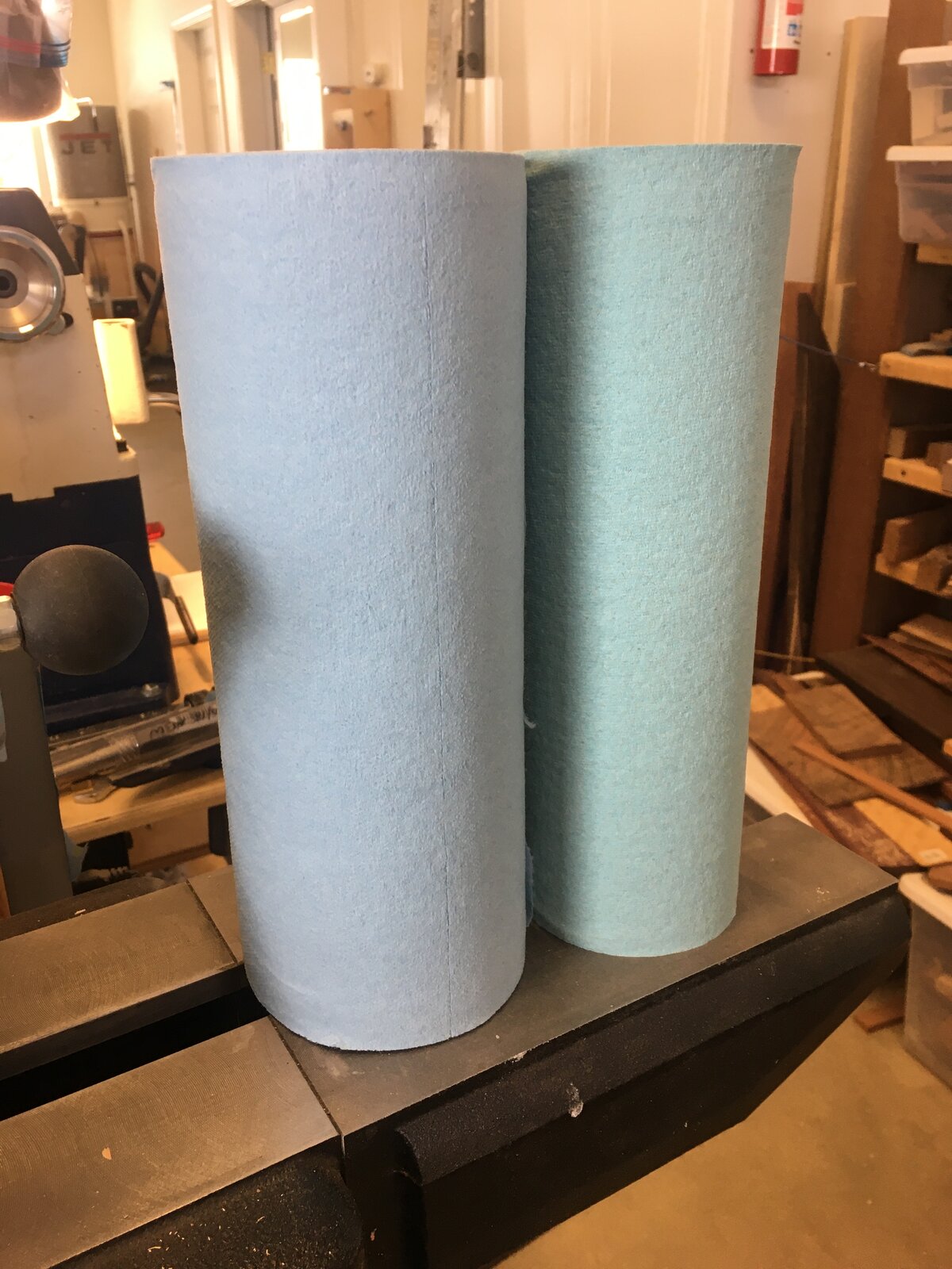

If you use blue towels to apply CA glue when finishing pens buy Scott blue towels. They are larger, softer and don't smoke when CA is applied. They have less off gassing too which makes the job less onerous. If your towels have a blue green tinge- buy some Scott towels and never look back.
If you use another method and are happy, great.

Appreciate the tip, I use the blue shop towels for over a decade. I know... there is a brand out there that just sizzles when you use it... can't remember which one... but I know it by its packaging.
"They have less off gassing..." Wow... I thought that was me. 🤔
And the color. See greenish tinge and skip it.
