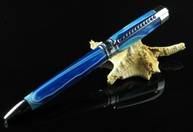

This is acrylic blank called "Water" from woodcraft that I turned the mounted it on "Princess" kit from PSI. It was sanded from 150 grit through 600 grit then micro meshed to 12,000. To bring out that luster finish I applied three coats of Meguiars Gold Class Carnauba Plus paste wax. (Yes, it's car wax). It resists oils from your skin and also any skin acids. It also does not smear or show finger prints as some wax's do. Hope you like it, all comments welcomed. Clyde
