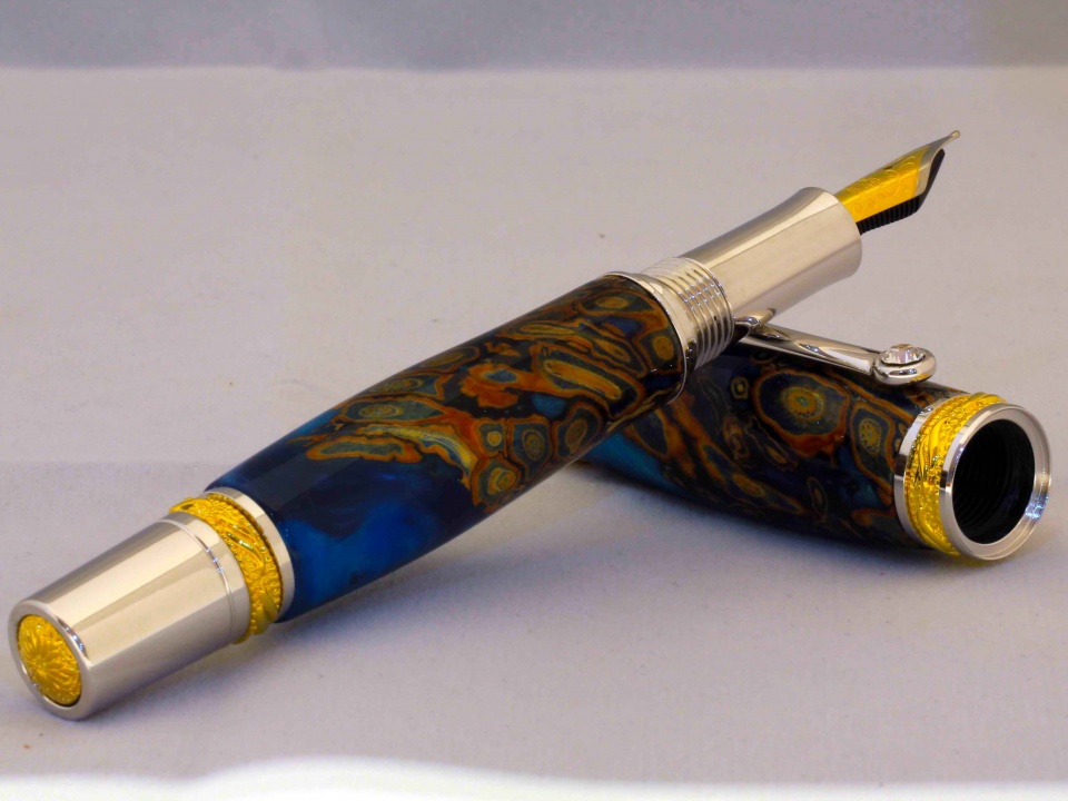

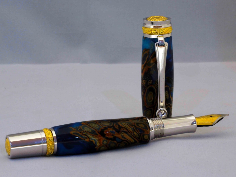

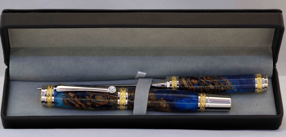

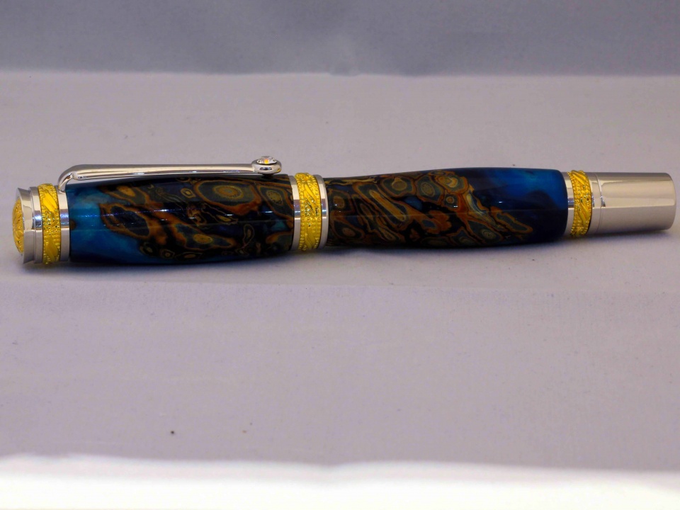

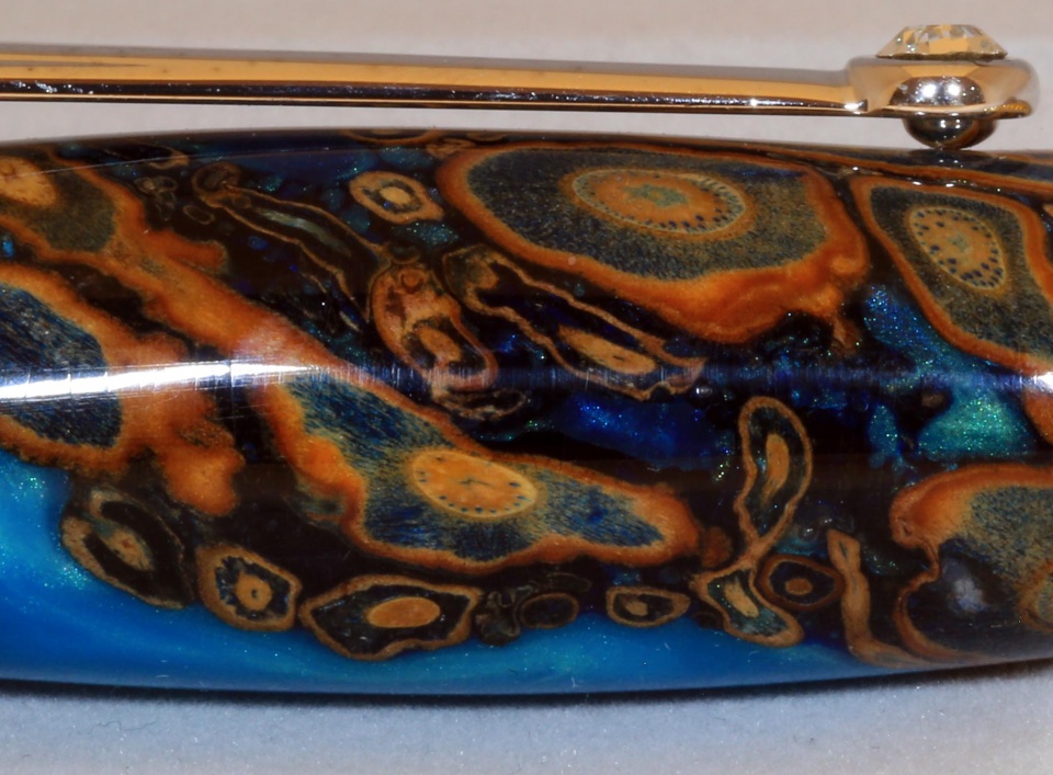

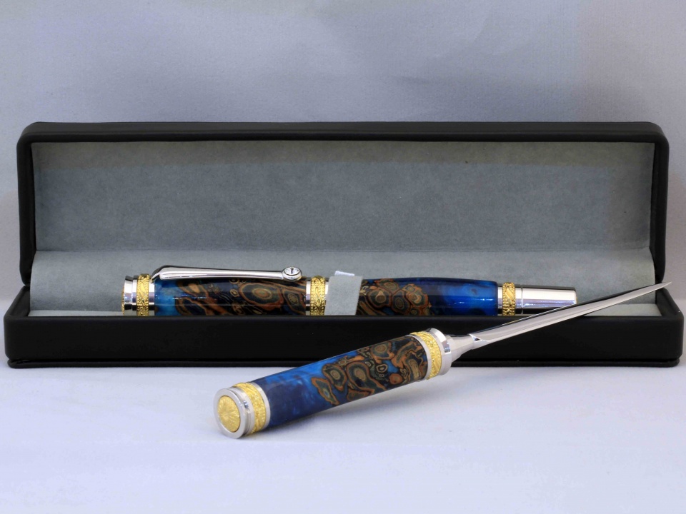

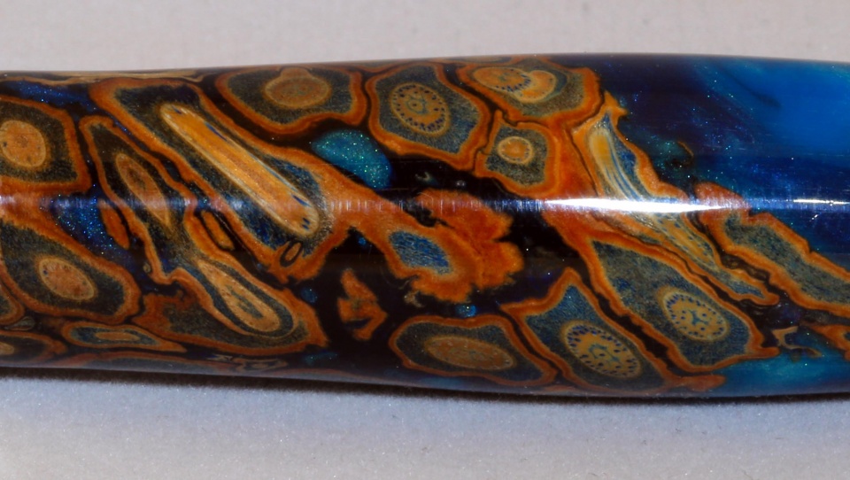

This is the pen that I entered for the contest. It was part of a set that I had an order for. The majestic kit seems to be well liked, this is my third order for a set. I had fun doing this. I loved the contest and saw so much talent. So much to aspire for and I was truly inspired. I am not sure if I would like to do kitless as yet, but certainly would love to try segmented pens. I have never done one, so if anyone has any articles or videos that they know of please do share. Of course as always C & C, tips and tricks are most welcome. I tried my new carbide tools to turn this set, and it worked well. Palm root is very fragile, but I got through without much of a problem. The palm root grain is much better appreciated when you have the pen in your hand, photos don't really do it justice I feel. It has a 3D sort of effect, which is unique. I've made a number of these pens now, and they are all highly sort after. It is finished with CA.

Sean: The blank is incredible with the colors! Did you cast it?
It is a great match with the kit.
Wonderful work - I have "Blank envy"...

Wow Sean, that is a work of art...!
Fit and finish are superb, even tough the good close up pics, always show things that the naked eye can't see, you may have to introduce a buffing wheel system to get that CA surface flawless, burnishing lines are a pain to see but, most times, they are there, only a good buffing wheel and some good buffing compound, together with a magnifying light/lamp, can clean those up and give a supper deep gloss finish, very difficult to achieve manually...!
As for the effects/colouration of that Palm root well, that's another story, huh...???:wink::biggrin:
Keep up the good work mate, you are doing very well...!
