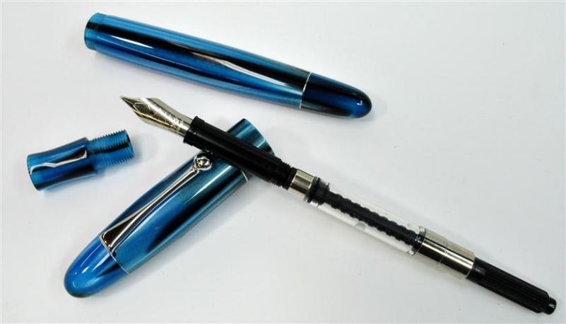

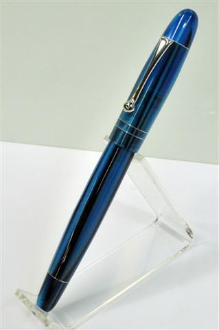

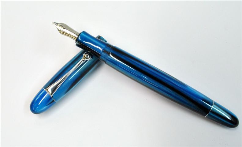

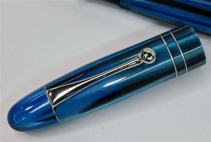

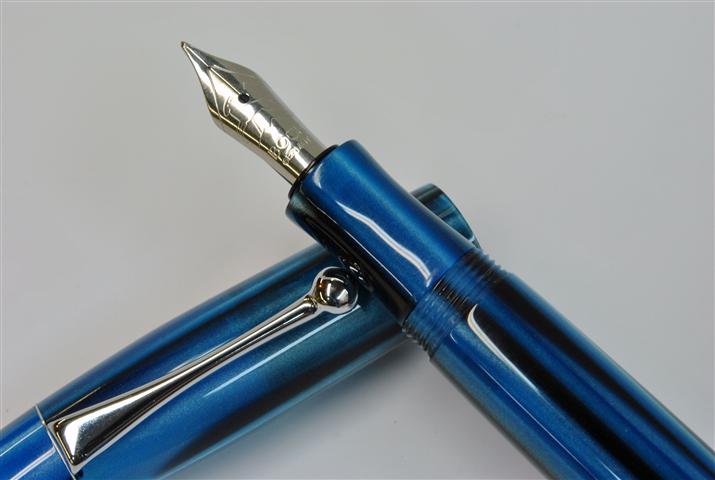

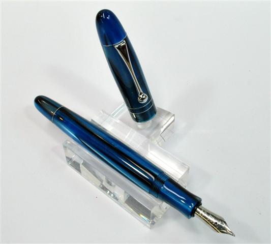

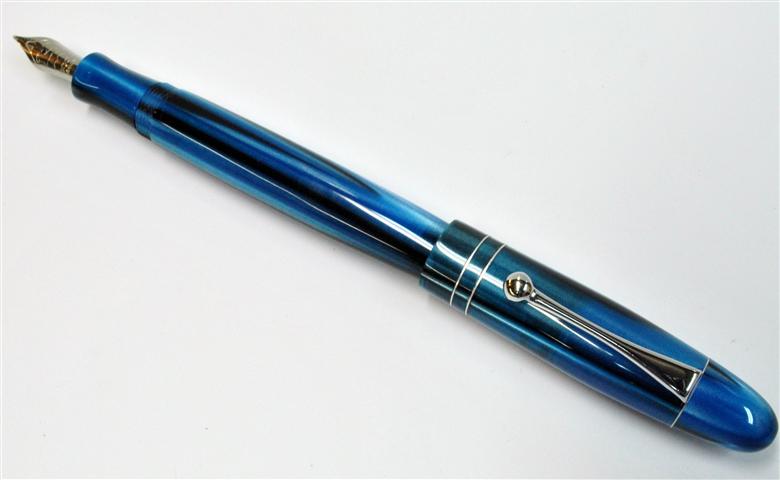

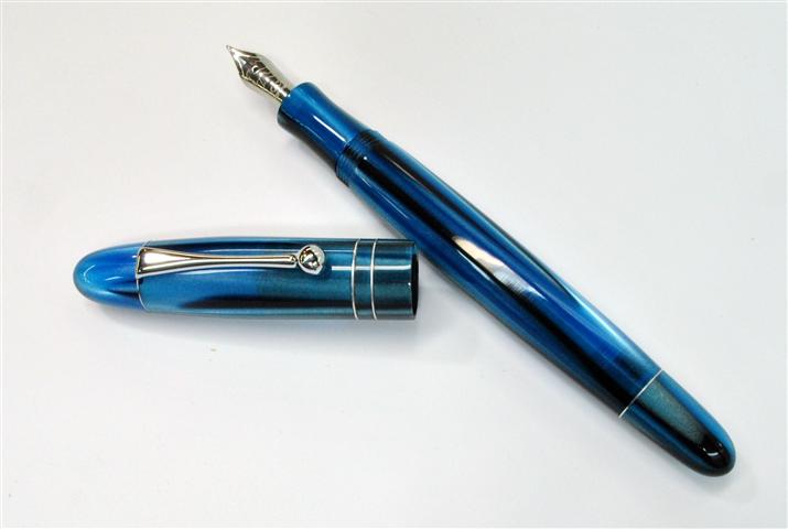

This pen is a little longer than I'd like, but I think the proportions are better than the Tiger Eye pen I recently posted. I have an idea to move the threads deeper into the cap to shorten the overall length and get the proportions right--next pen.

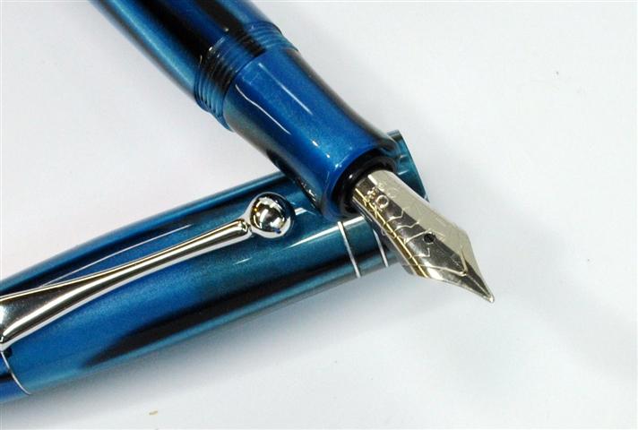

This is an imported Italian acrylic from Richard Geenwald. I used my last polished steel #5 Bock. I think #5 Bock holders are too long and am going to either squeeze #6 nibs into these small-waisted pens or try the Schmidt holders and nibs Mike at IndyPenDance is now carrying. The bands are aluminum.
I wanted to get the holder flush with the end of the section but there's very little threading on these Bocks and I knew if I messed around any more I'd end up trashing the section.
Thanks for looking.
Weight 20 g
Overall length 146 mm (5 3/4")
Posted length 165 mm (6 1/2")
Length uncapped 125 mm (5")
Cap diameter 14 mm
Barrel diameter 13 mm
Section diameter 10.8 mm
