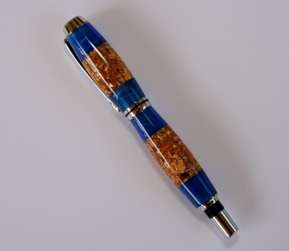

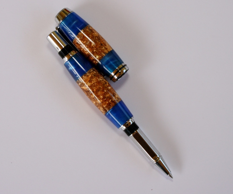

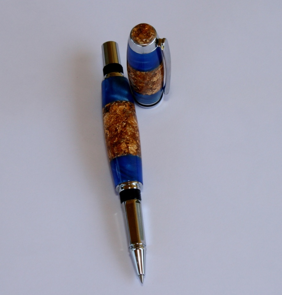

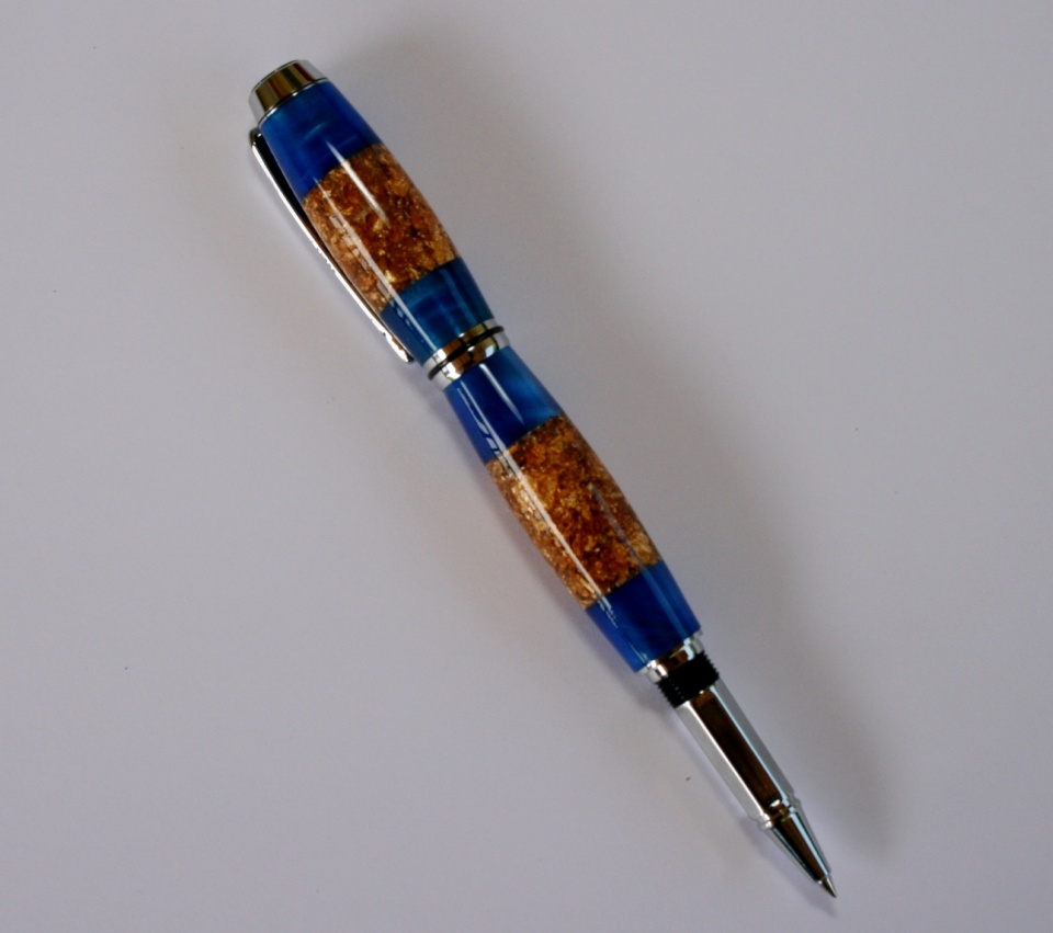

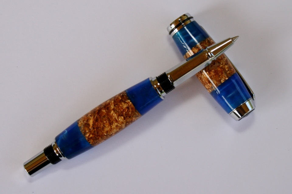

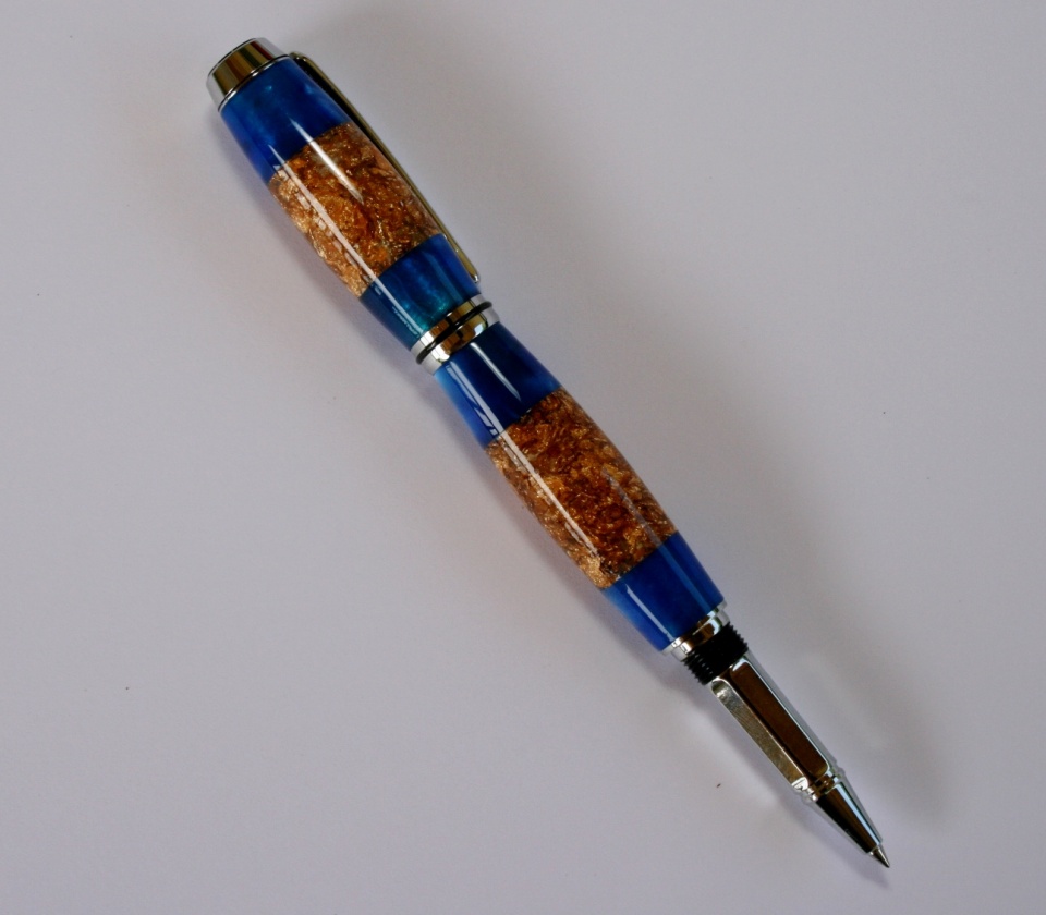

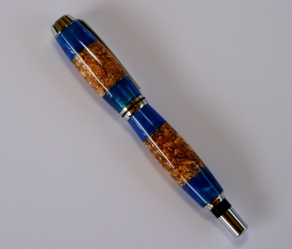

I've wanted to do a segmented blank of the Navy Colors of blue and gold. I had the gold blank I just need to find the right blue, I found the blank I needed at Woodcraft yesterday. I'm happy with the way it came out. The kit is a Woodcraft chrome Navigator. I did not paint the tubes nor back paint the blank. I used epoxy for the glue up and let it set up 6 hours. I wet to 12000 mm and polished with Hut plastic polish. All C & C welcome

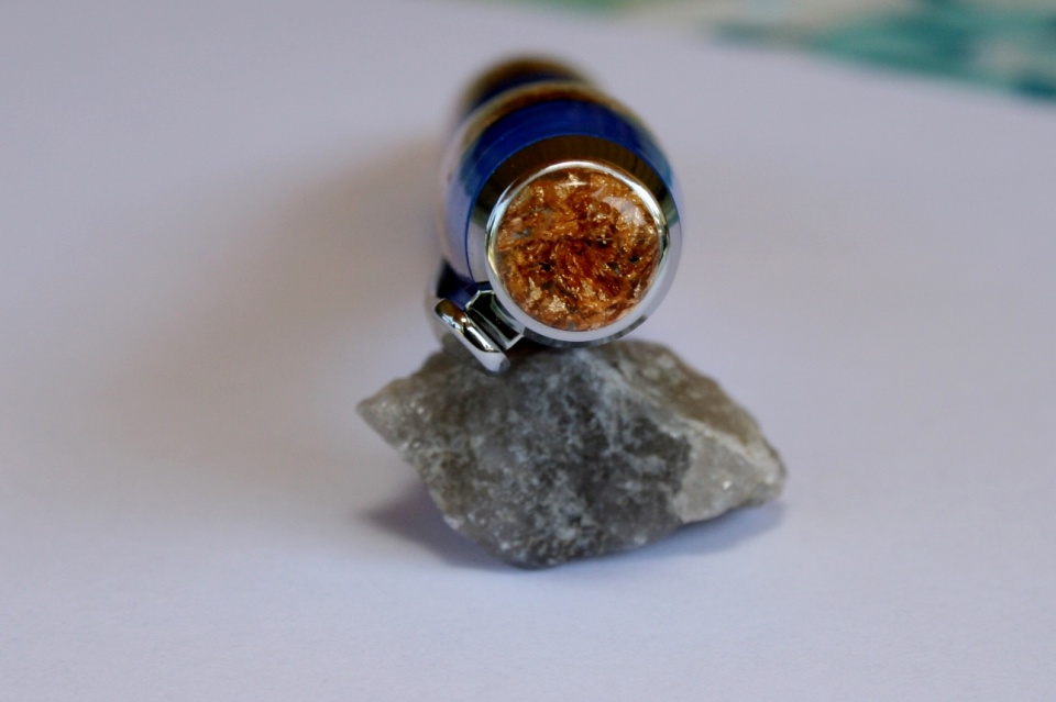

After posting the pen yesterday I though I should try to make a custom Gold finial. After two tries here it is. C & C welcome

Wow I really like that finial it looks great. The pen also looks great. I would back paint your blank next time though. Your finish is amazing very nice job on that Dan..
Thank you Mike and Jason for your for such nice comments. The finial I used was turned with the blank side to side not end to end. Jason; your welcome.

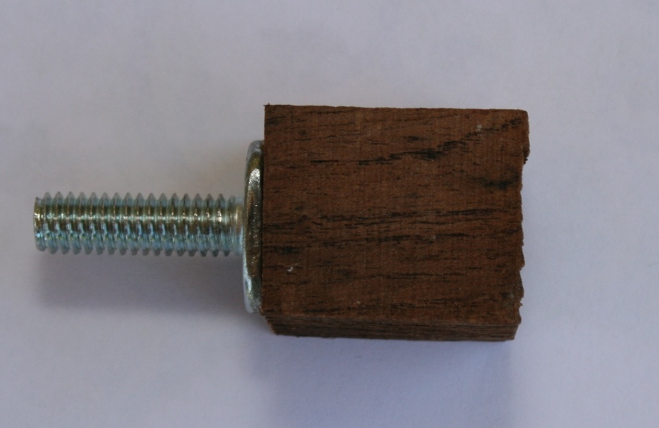

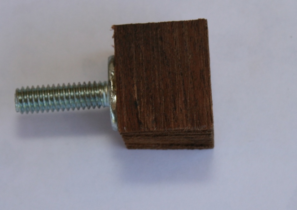

Some of you may be wondering what I meant when I said side to side and end to end so here are two pictures to show what I was talking about. The first picture is of the blank piece mounted side to side and the second is the blank mounted end to end.
Thanks a lot Eric, two thing's I can tell you about making a custom finial....check out the IAP library on finial's and practice-practice-practice before you make on for a pen.
