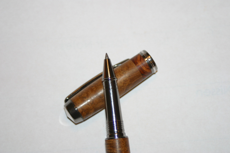

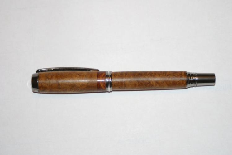

A while ago I sought advice about a blowup that I had on the lathe:
http://www.penturners.org/forum/showthread.php?t=41520
Well, here's the finished product. I'm not real happy with it, but I did learn how to fix the problem, so lesson learned. Wife picked out the collar. The pen is teak burl with a cocobolo collar. The problem is that I didn't match the grain right. Instead of the rainbow (which looks kinda neat), I should have had the grain run down the end of the pen. I didn't think of this until later. Oh, well.
The finish didn't come out all that great either, but I think that this is a byproduct of being frustrated about the grain thing and just rushing through the finish.
Thanks for the advice, everyone!
Blessings,
StatProf

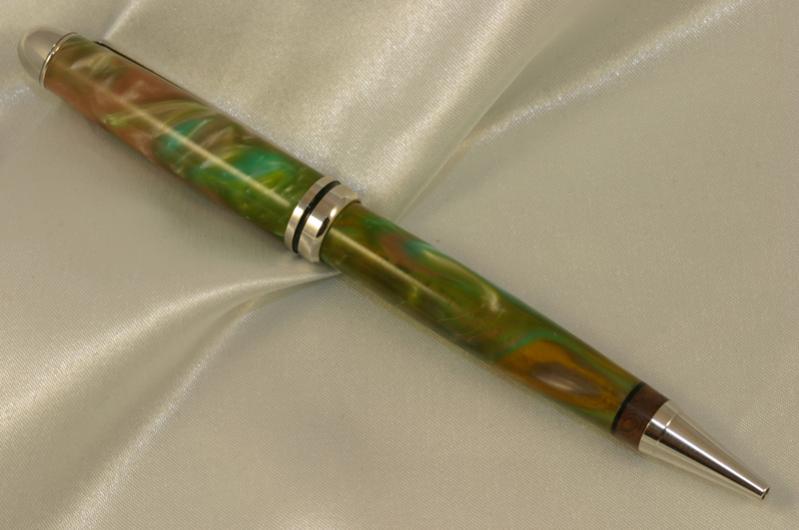

Just a thought here. If it happens again, or for that matter you can plan it this way, but think about putting a slice of picguard in between the 2 woods, especially if they are so similar. Takes seconds longer and looks intentional, instead of an oops. Plus your eye will get drawn away from that little tiny black glue line-you won't see that if you put a slice of something in there. It will still be there, your eye just won't pick it up.
Here's a few examples. The first one was on purpose, the second was one of the first I ever did and I sanded too far down, and didn't want to waste it. Neither are high art, but it dressed up a few cheap pens and hid the glue line while I was at it.
Give it a try!
Dale
