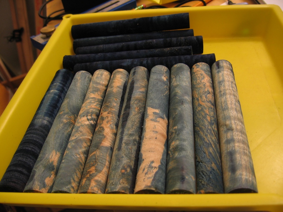

I have a lot of pen blanks of maple and have been using color durable dyes and vacuum to see what can be done -- then turn them to dowels.
Picture shows some of the variation with long contact time and a few pulls of moderate vacuum - moderate in that I do not want to boil water into my vacuum pump.
Depending on the grain patterns, you can see how the dye penetrates in an irregular manner.

Those are pretty nice Ken.
