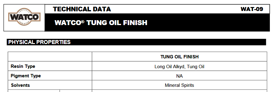

To John's point - its important to understand exactly what you are using. You mentioned Watco - I believe that Watco Tung Oil (WAT-09) is more correctly described as a 'long-oil alkyd varnish' with a Tung oil base, and the label on the can clearly says 'Tung Oil Finish".

As noted above, many oil finishes are not 100% pure oil. WATCO Tung Oil Finish is not 100% pure tung oil. It has various solvents and additives. You can buy 100% pure tung oil from various sources, and they should all be the same. If it says anything else, like "Tung Oil Finish", then it is NOT 100% pure tung oil.
