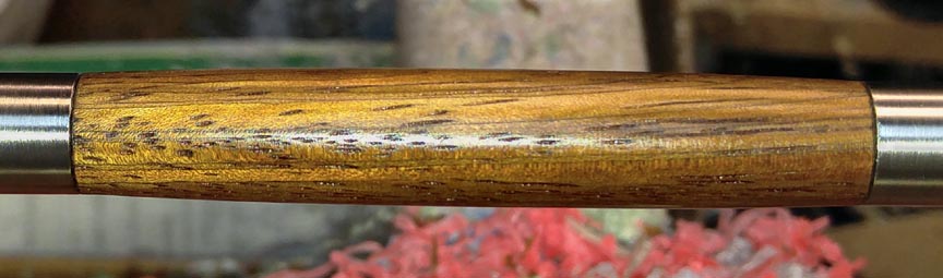

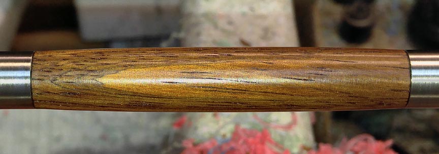

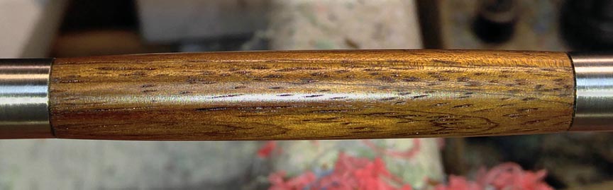

Has anyone done a boiled linseed oil only finish? This is a Thailand rosewood blank for a Knurl GT pen. So far, I've only put BLO on it, and I really like the sheen. I'm not too keen on CA finishes, and normally I would finish it with some sort of clear spray lacquer or enamel. But I love how this looks. I'm just not sure how well it would hold up.

Won't hold up. But here is the thing, the wood you use is an oily wood and will always have some patina to it just from the natural oils of our skin. But being there is no filling of the grain with a finish it will have a tendency to collect dirt and eventually the pen looks grungy.
Now with that said, when people like to feel the natural feel of wood there are ways of doing this. I prefer to use Danish oil. Danish oil is basically blo with polyurethane in it which gives the protection. This polishes to a very nice sheen. I have shown many examples of this on there things that I make other than pens. Will it wear off, possibly but last a lot longer than just blo. I never really did a wear test on pens and the ones I have made for clients have never returned so I have not tracked them. Polyurethane is strong stuff.

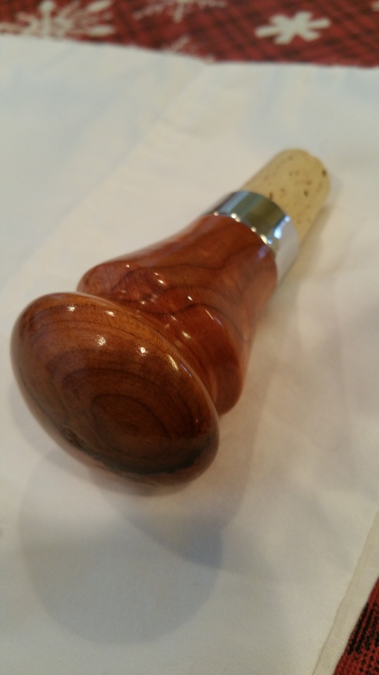

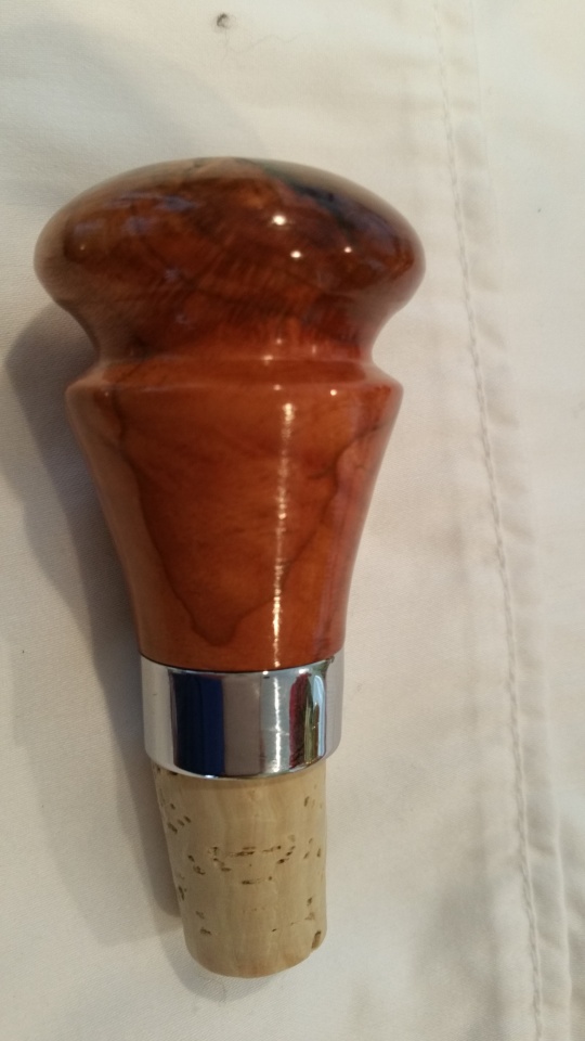

I have tried many times to use ca and I hate the fumes,,even with blo,,so yesterday I was playing around with a bottle stopper and I tried everything,,blo with ca,,just ca,,and it kept building up plus jerking the paper out of my hand,,i noticed I had a bottle of 495 Loctite super glue that I had brought home from work,,i applied it,,didn't have anything to lose,,not only did it apply great,,not much fumes,,but you could put it on and continue rubbing it in without it jerking the paper towel out of your hand,,i put 6 coats on it and never sanded and its as smooth as glass,,plus used one step to buff it,,i was amazed,,,to say the least,,and I applied it around 800 rpm,,
